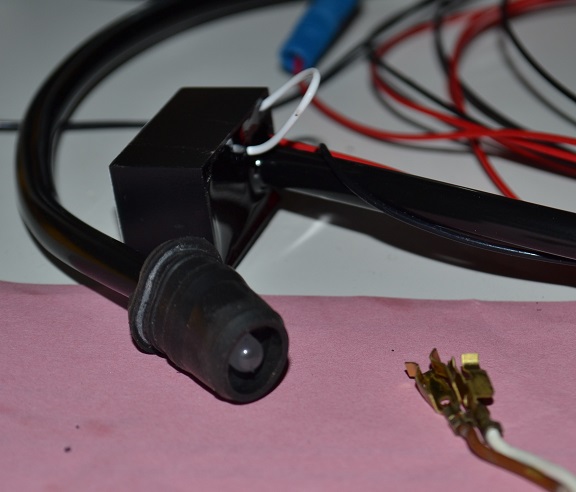

I bought this voltmeter: https://www.clearwaterlights.com/produc ... age-sentry, about $64 with shipping (and showed up pronto). I got it because of rave reviews (especially regarding accuracy) and it only takes up a .25" hole on my dash. This is a hot item among the ADV crowd, and it includes an option to use with certain lithium batteries (for the very weight-conscious).

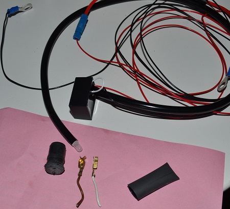

I decided to put it behind the unused BATT slot on my dash, basically replacing that old acid-level gage with a real voltmeter. It has ground and hot leads, a very small brain (less than 1.2", longest dimension) and an LED output light. It doesn't need to be switched-hot because it turns itself off after no elec activity in 5 min. So I can check the battery voltage a couple minutes after I turn off the bike, as well as before I first hit the starter button.
These photos show how I clipped the BATT socket from the harness, ripped out the light leads (I had removed the light bulb long ago), and mangled a new hole to jam in the voltmeter's LED. It fits pretty tight in this soft light socket.
It has a color/flash scheme: the LED will be green most of the time, flashing green when it's charging right, yellow if there's a problem, and red (or flashing red) for a serious problem. These are voltage levels, reportedly extremely accurate.
The BATT lens is red, so the green light should look like dark mud. I'll drill a couple small holes in the lens around "BATT" to show a little green. And then I'll ignore it. But when it goes yellow, it'll show through as a bright orange. I should notice that. And red would come through bright red -- all behind "BATT".
I think this is way kool.

I hooked up a battery having only 11.4 V, and the gage flashed red like it's supposed to. This was plenty noticeable, but not super bright (under fairly bright conditions). Just saying to be sure to push the bulb all the way up through the rubber grommet thing.
In daylight, I can only see the green light through those four tiny, 1/16" holes I drilled around BATT. I have to move my head around to catch a glimpse of green. Through the red dash lens, I don't think I could even see flashing. But I plan to ignore green anyway. (I'd drill the holes again for those rare times I'll want to ensure it's working.)
Yellow is difficult to distinguish from red. But either way, it's quite noticeable, telling me that I need to deal with something associated with BATT.
So, it works swell -- only bothering me when something's wrong. It's bright enough to see a problem condition in the daylight. But dimmer than other indicators like Neutral, so I don't expect a distraction at night.
Recommended.
