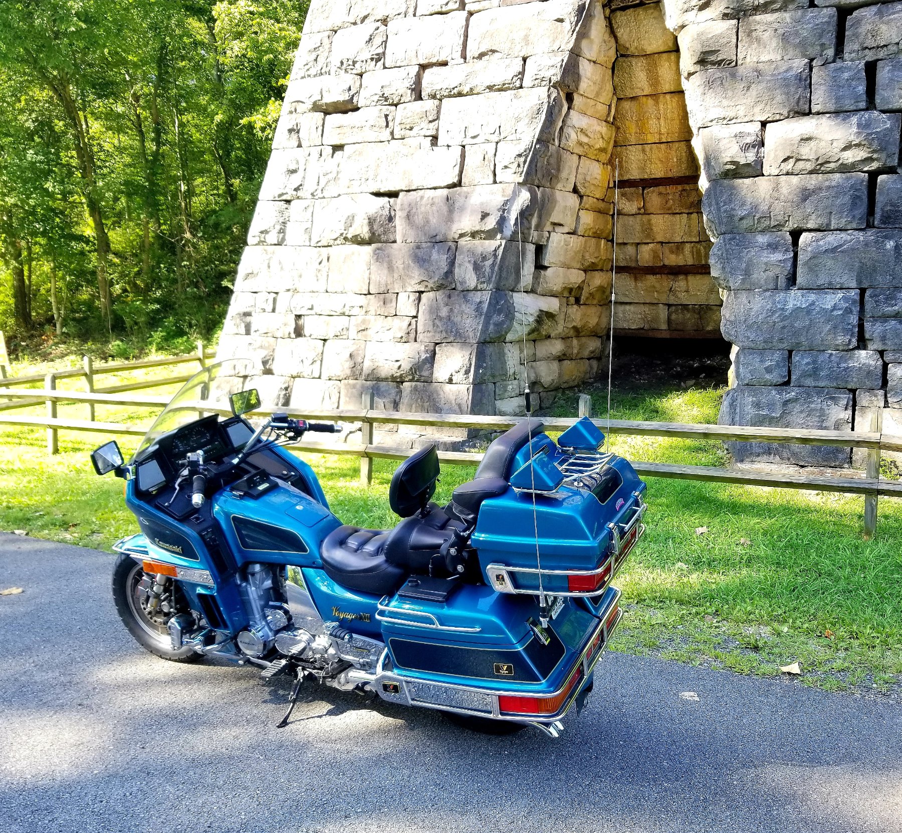

Hello everyone. I recently purchased a very clean 1995 and have been in the process of getting it completely lined out. So far I've added new tires, rebuilt the front calipers, put on new brakes and changed the oil. I thought she was completely diled in, until today. I stopped to take a photo and noticed a strong smell of raw fuel and saw a good amount of gas under the bike. I went home and pulled all the overflow tubes off the carburetors and only the far right carb is leaking.
My question is, can any thing be done other then pulled the carbs? I honestly hate to mess with them because they seem perfect (starts with little choke, runs great, great mpg). I'm in love with the bike so I don't mind having to spend a little time getting it all sorted.
