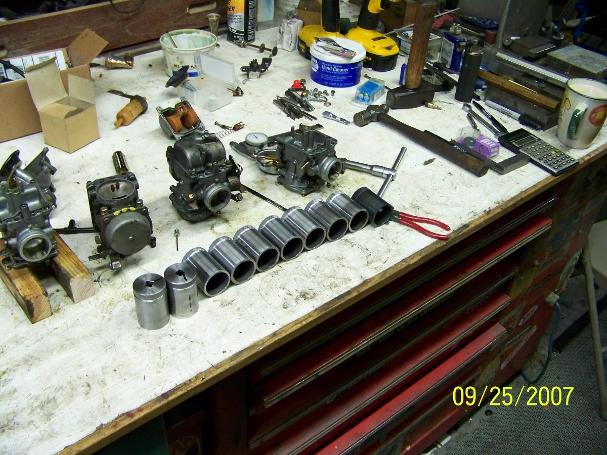

Glad to hear . Did you loosen up the axle and pinch bolt and re-tighten after installing the brace / inserts ? Chances are the axle was tightened without the brace being sturdy and a metal to metal connection. Let me know how your 50 or so mile ride goes tomorrow. Should feel 100% better now. Been busy here in the shop, I will have 10 -1200 sockets done in a week, and may make some inserts have in house.
