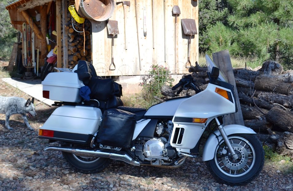

My first thought also was some Naugahyde cover. But I have an industrial sewing machine. Irrelevant, but here's a photo of some bags I made for the passenger floorboards.
[/quote]
It's certainly a big plus having a practical skill like that. That's a lot of extra stuff that you can carry in those.
[/quote]
