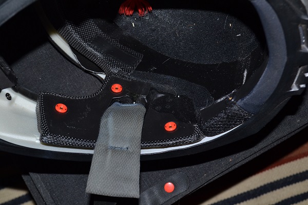

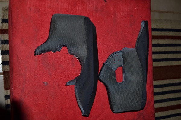

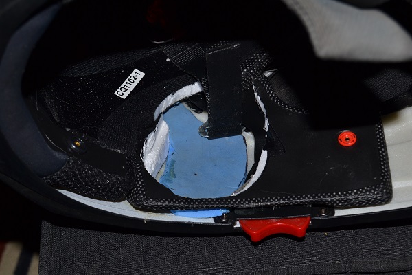

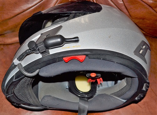

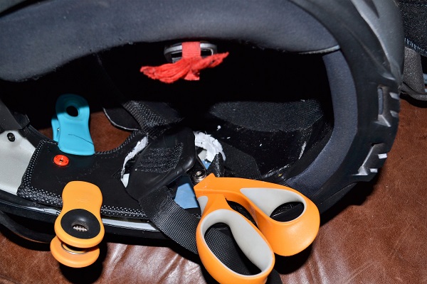

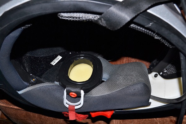

Sorry for resurrecting this old thread, but I have an update. I've been screwing with this setup, finally settling on gluing 1/8" foam to the outside of the cups, and gluing that to the inside of the chin strap and anchor. The foam was to dampen noise directly (physically) transferred from the helmet to the muffs. Note that my 2XL helmet isn't large enough to fit the air bladders like I'm supposed to use. I can barely squeeze my head between the muffs, even without the bladder and a couple layers of Velcro that they come with. Even now, the muffs fit tight, but not uncomfortably tight. I seriously doubt there are noise leaks -- the chin strap pulls them even tighter.
I thought this was working because I couldn't hear the engine shift-points or even when I was about to stall it from a standstill. I did report a loud low-frequency noise, which is much like sitting in the back of a 727 (near the engines). I thought this was always there, just masked by the noises the muffs were blocking.
Due to bad star alignments, I haven't been able to test more than about an hour ride, but yesterday I took an all-day ride in this helmet. I came home much more deaf than normal. I couldn't hear things that I could that morning; and the things in the house I did hear were oddly distorted. My hearing seems to have mostly recovered last night.
I haven't been that bad after wearing no noise protection at all. I think these muffs actually amplified some noises, and my ears didn't like it. I'm about ready to declare this effort a failure. I still haven't tried with ear plugs too, but what's the point? And I still won't hear shift-points.
