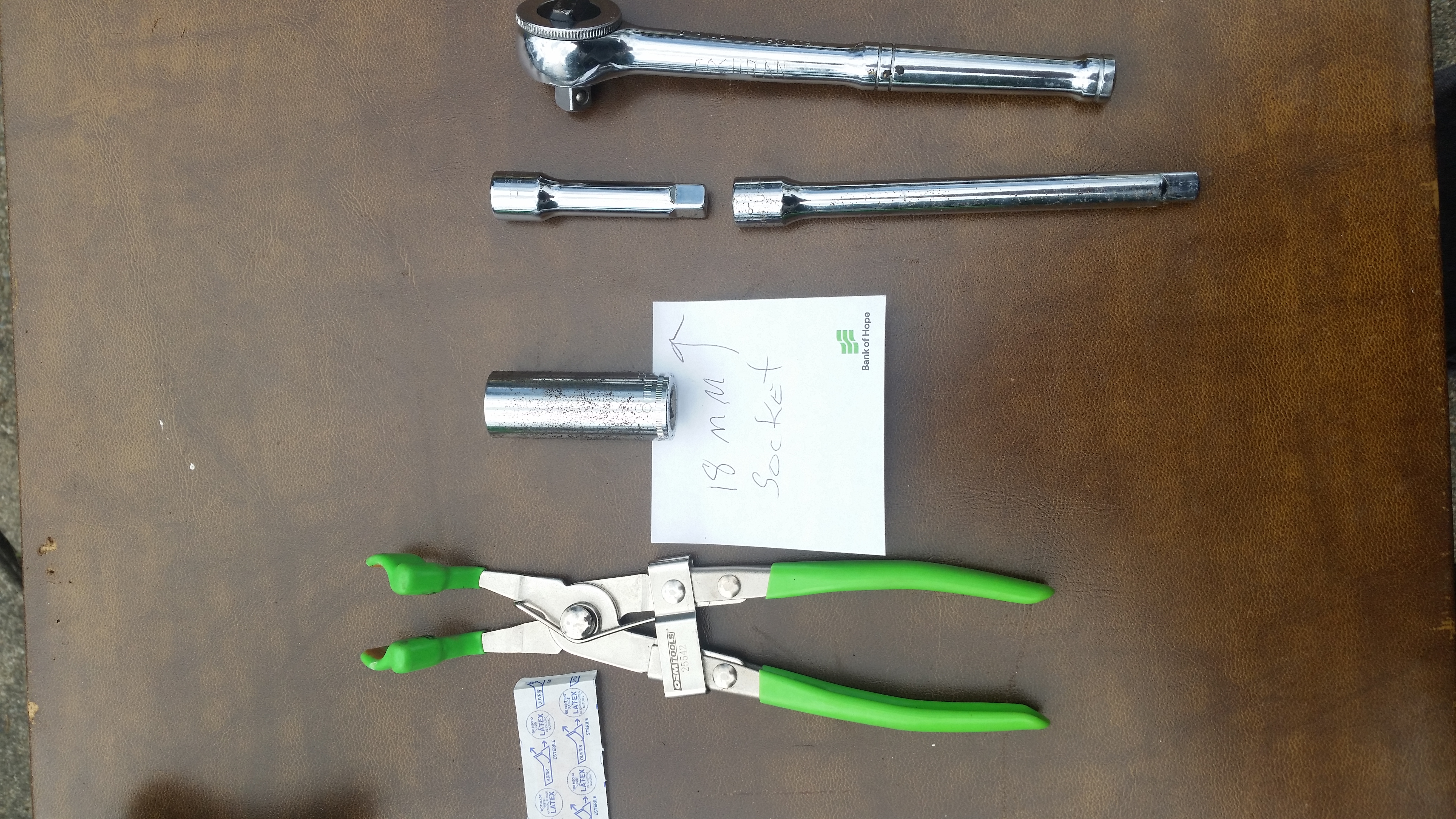

I am experimenting with posting pics. One is the additional tools needed aside from the original plug socket from the tool kit. Note the required band-aid on the left. 3/4" drive, two extensions and the 18MM socket fits on the actual plug socket seen in the next pic.![Image]()

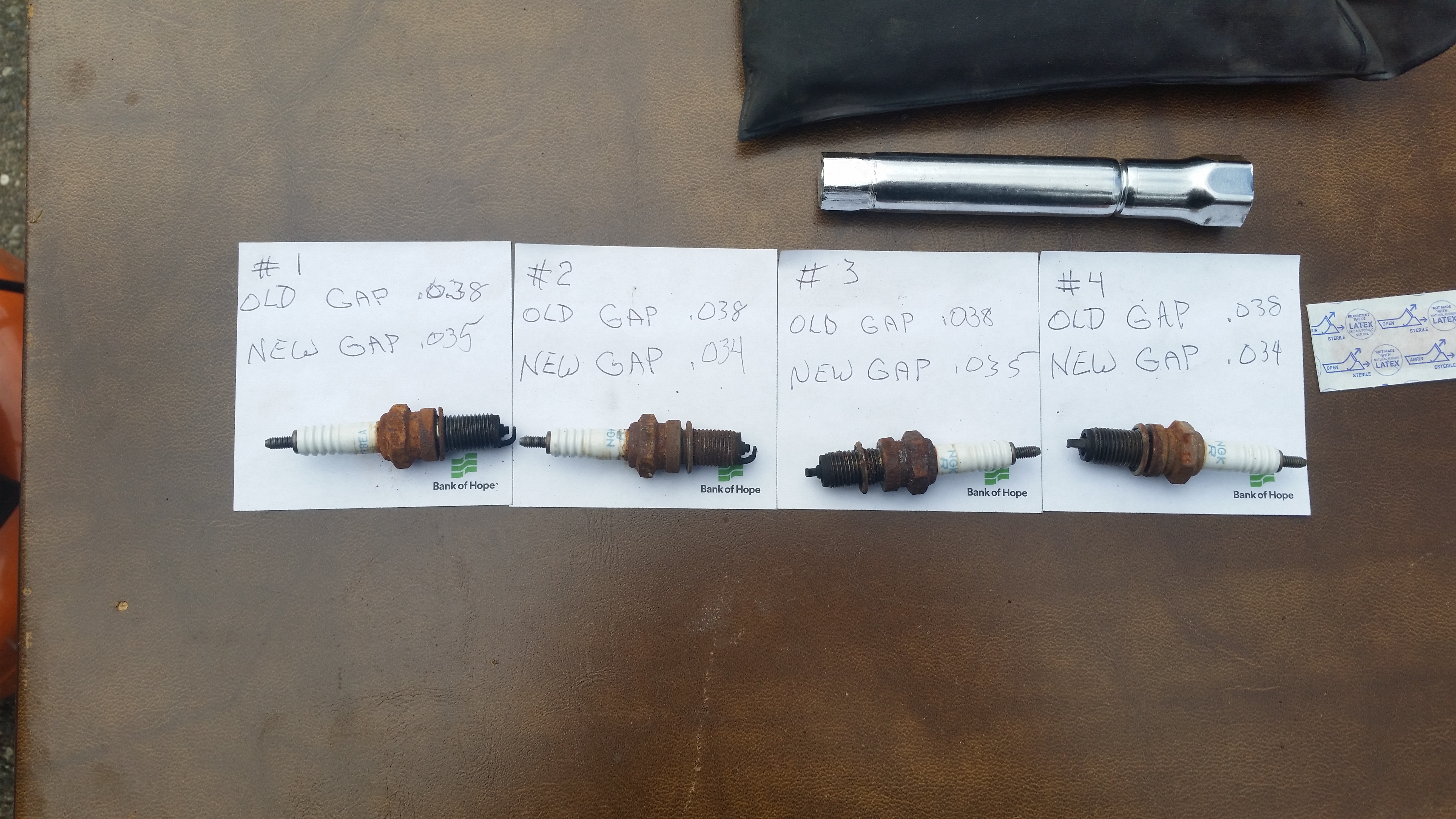

Old plugs were really rusty on outside and gapped at .038 while specs say do .032 - .036![Image]()

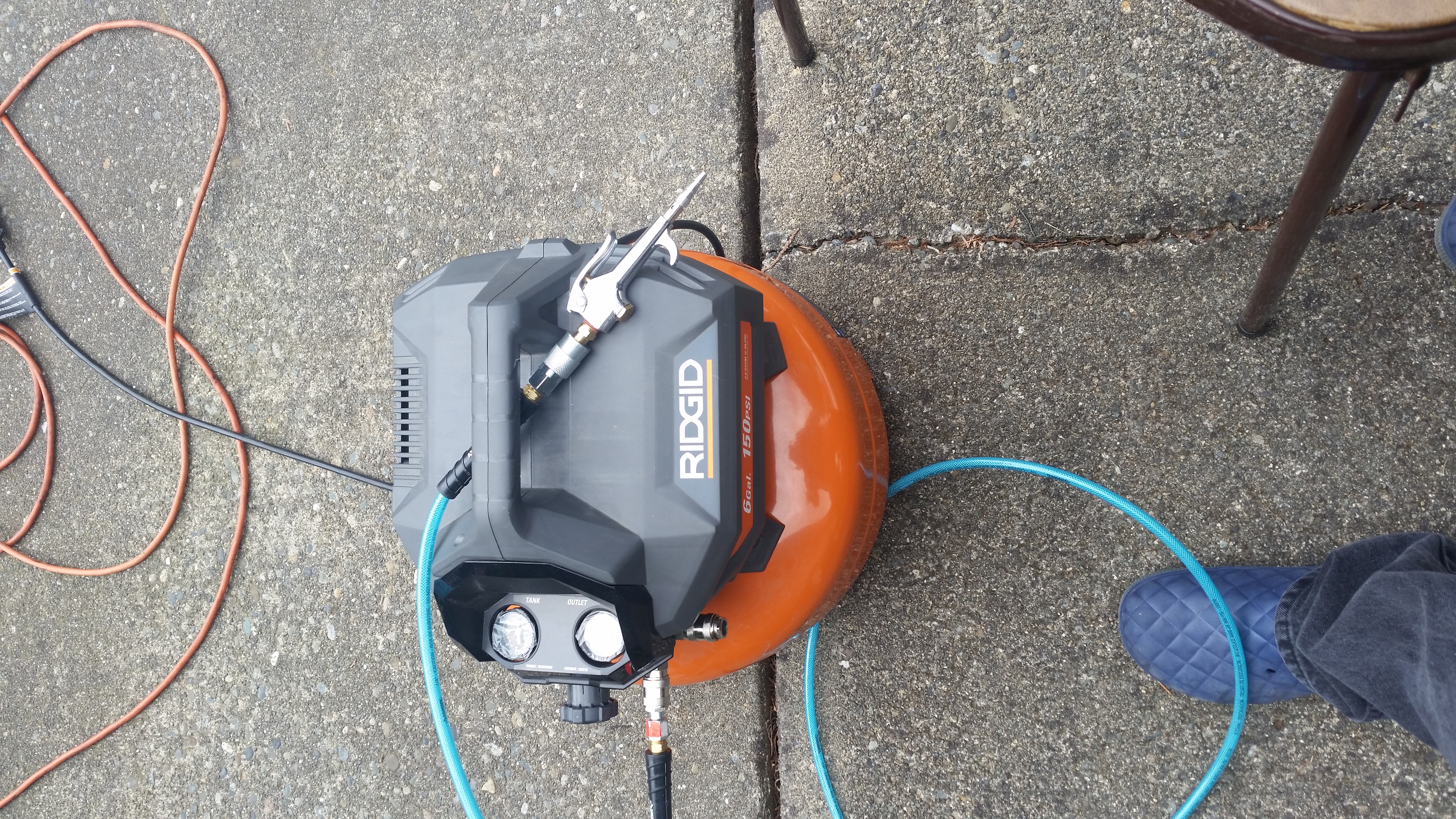

And of course an air compressor with nozzle to blow out crap in the plug wells before pulling the plugs.
