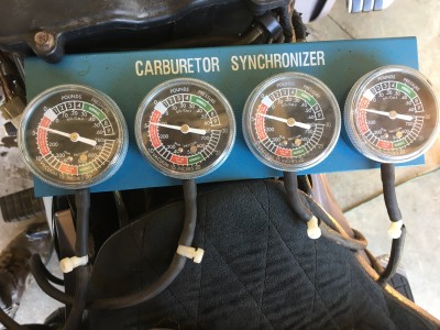

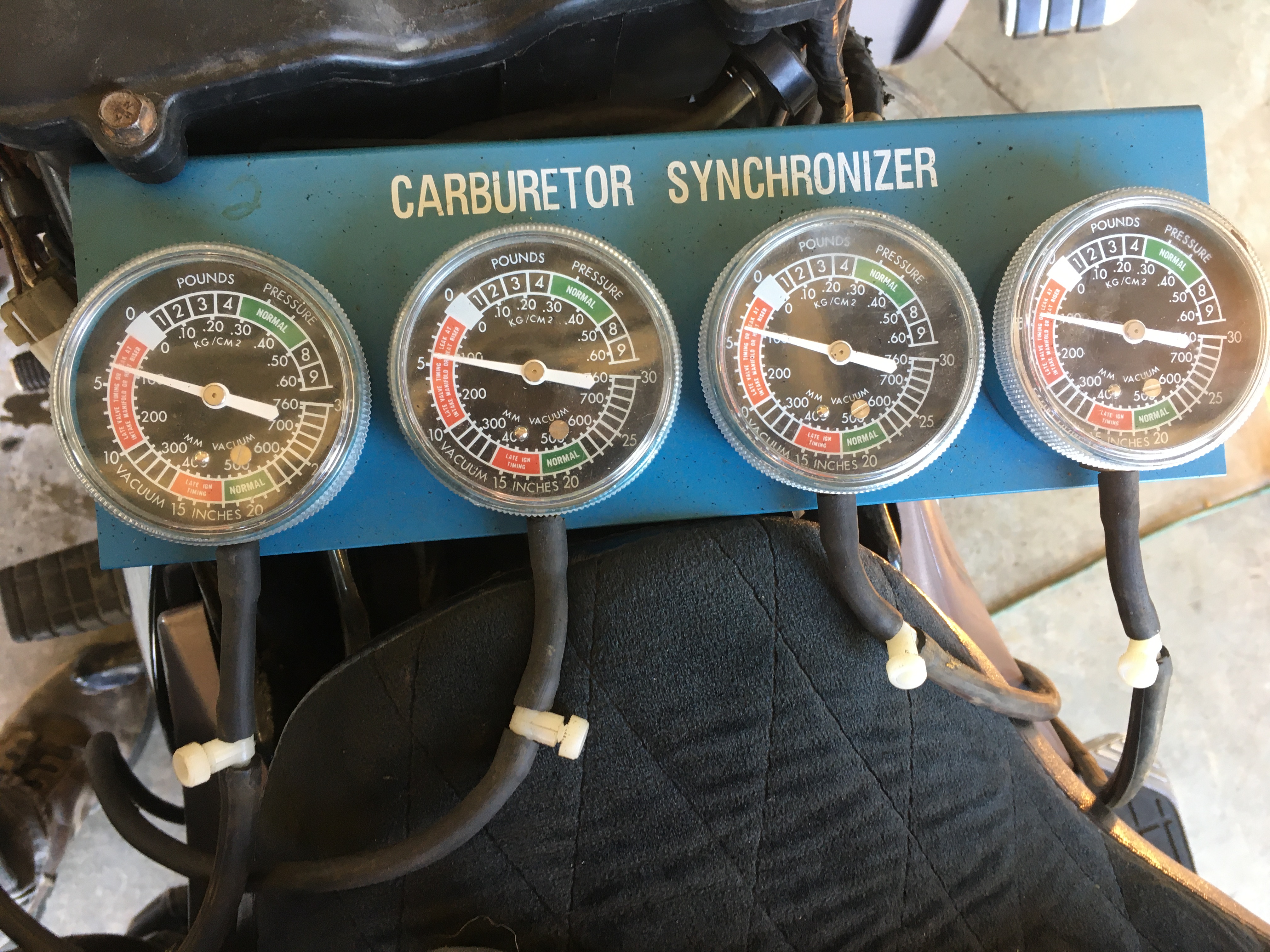

Ok so been haveing this problem for a year and nothing has worked. So far changed spark plugs .wires.adjusted pilot jets 2 turns out run several canns of seafoam thouugh re synced carbs all are perfect i have a miss like its running on 3 cylinders heres what i find. While running from the right side of the bike sitting on it. Cylinder 1 and 2 on left. exhasut pipe temp is around 250 260. Right side 2 cylinders 3 is about 160 175. 4 is usually about 110. I have spark at all cylinders. Turning pilot jet on cylinder number 4 does nothing pulling plug wire off number 4 while running changes nothing Do i have bad diaphragm in the carb There is gas in bowel if i open carb drain

Ok so update time. Put new plugs in checked sync again its still perfect rode today about 60 miles above 2250 rpm its smooth as can be. Below that its kinda jerky. While riding id come to stop had to turn idle down 3 separate times. Ordered new carb kits going to try put new pilot screws in with o rings see if that does anything. Any other suggestions ? Its about to get sold if can’t figure this out. Now i have oil leak at water pump to
