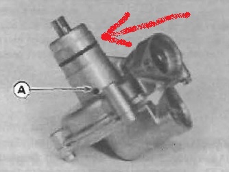

The water pump is famous for the oil seal to work out on the shaft and then engine oil can leak thru the weep hole in the water pump, pump is driven by a shaft in engine. Remove transmission alum cover to get better view of area. Take a mirror (magnifying one if you can) and put it under exhaust pipe and shine flashlite on it so it reflects up where waterpump bolts up to engine, there is a small space where you can see the weep hole and if you see oil in there that is where it is coming from. when engine is running you can see the shaft turning. If that is where it is coming from you need to take out water pump and replace seal, not a big job, about 2 hours or 2 beers and a couple a cuss words, and a seal kit from Carl Leo. The ceramic coolant seal in the water pump rarely goes out. If that is not where the leak is clean up all of the area where the oil is coming from and spray baby powder up in there and run engine and it will show you where it is coming from. Let us know what you find and we will go from there..

Hello , here is a pic of the weep hole , on the water pump. If the water pump seal goes it will weep coolant , and if the oil seal on the engine side goes as in this pic. Well as you see it will weep oil.

See my above post. Carl Leo, is where you can get the correct seal kit to do the job and if you need info on doing it he will help you out better than anyone. Voyagerparts@bellsouth.net 731-413-8666 best call you can make..

Quick update -- Last weekend Dean stopped over and we tackled the waterpump. 9 hours and a gasket kit later and shes back up and running! Its been a week and not so much as a drop of oil on the ground! It got pretty bad right before the change -- I had it running for two minutes and had to shut it down because oil was pouring out of the weep hole!
Strange thing was -- the old gaskets looked ok!
Anyway -- shes alive once again and running like a raped ape! Thank you to everyone for the helpful info, and Carl Leo for the excellent gasket kit!

Hey y’all. I know this is an old post just wondering if y’all know the part number for the engine seal behind water pump? Mine too is leaking oil from the weep hole. Any help is appreciated.

If you mean that o-ring, I'm coming up with 92055-1266. I tried to find a parts diagram I could copy, but no luck. I believe it's this one.

92049-1416
