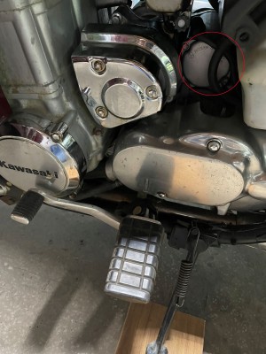

Been searching the web and as a Newbie motorcycle rider and having a a 2002 Voyager XII, where is the clutch bleeder valve. Everything I find just “says” where it is, and the pics I have in the manual still leave me scratching my head.
Yes, the question is THAT SIMPLE.
Laugh if you must and feel free to rag on me. As long as there is one forgiving member here willing to answer like they’re showing their 2 year old for the first time.
Thanks in advance

The Kawasaki cover??

cushman eagle wrote: ↑Tue Jun 13, 2023 10:01 pm Nothing to laugh about
It is behind the left,chrome cover,which you do have to remove.
welcome to the AVA family

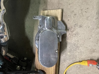

Nope, the one behind it, right above the footpeg.

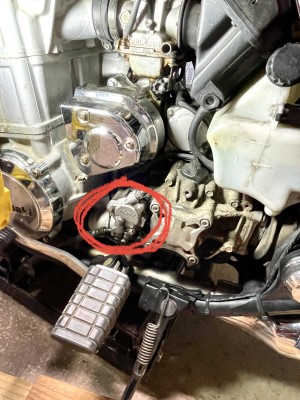

Behind the big aluminum cover (by the oil fill cap) on the left side, by the left driver's footpeg. Then look down and to the left, you'll see the clutch slave cylinder, it's kinda round and has a bleeder valve just like the brake calipers.

The one that is circled? I am finally going to get a chance to tackle my brakes and the clutch this weekend.

No, the oval shaped one right above the footpeg, with the shift pattern embossed on it.

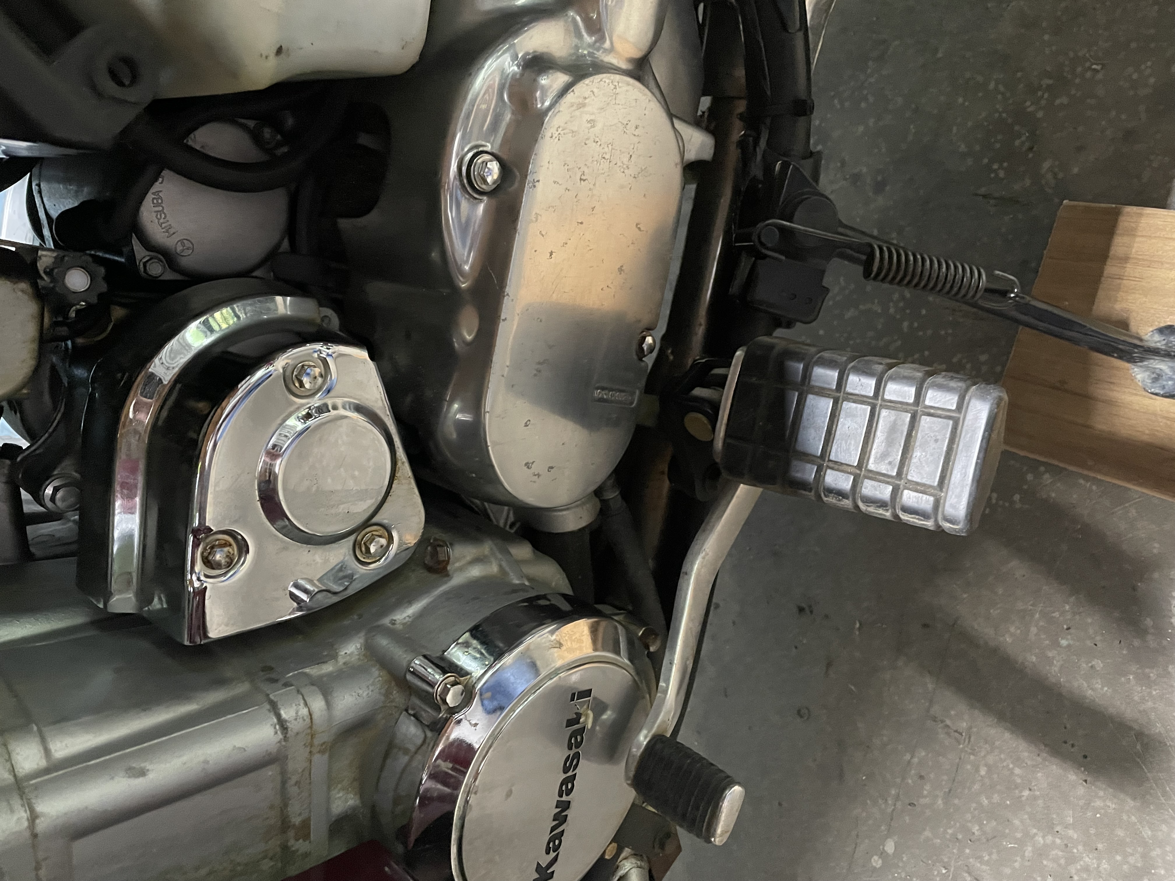

Got it and all is well in the world. Thanks for your patience.
