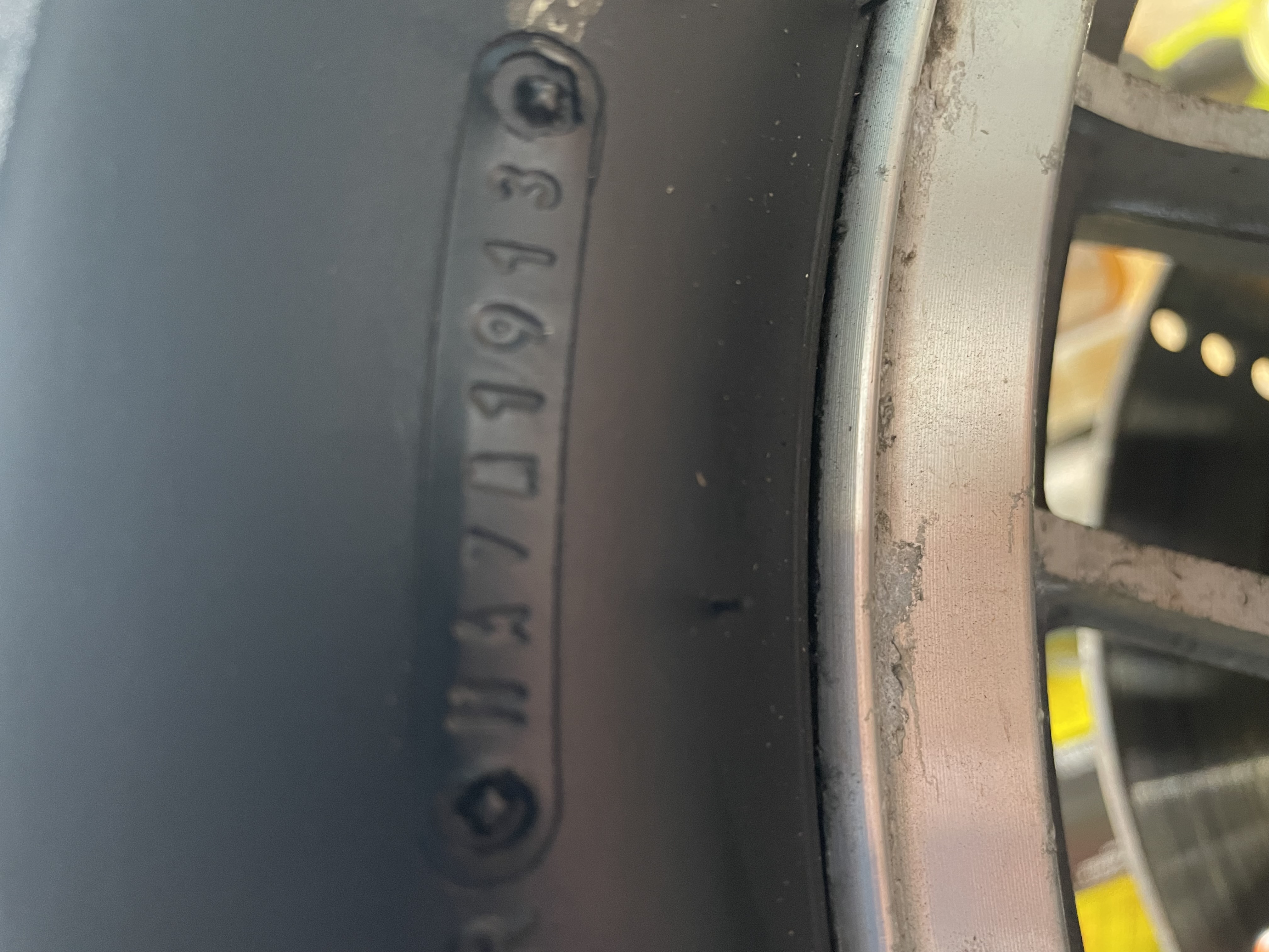

Is the picture below the date code? 19th week of 2013?? It’s on the Dunlop 404 I pulled off the front.

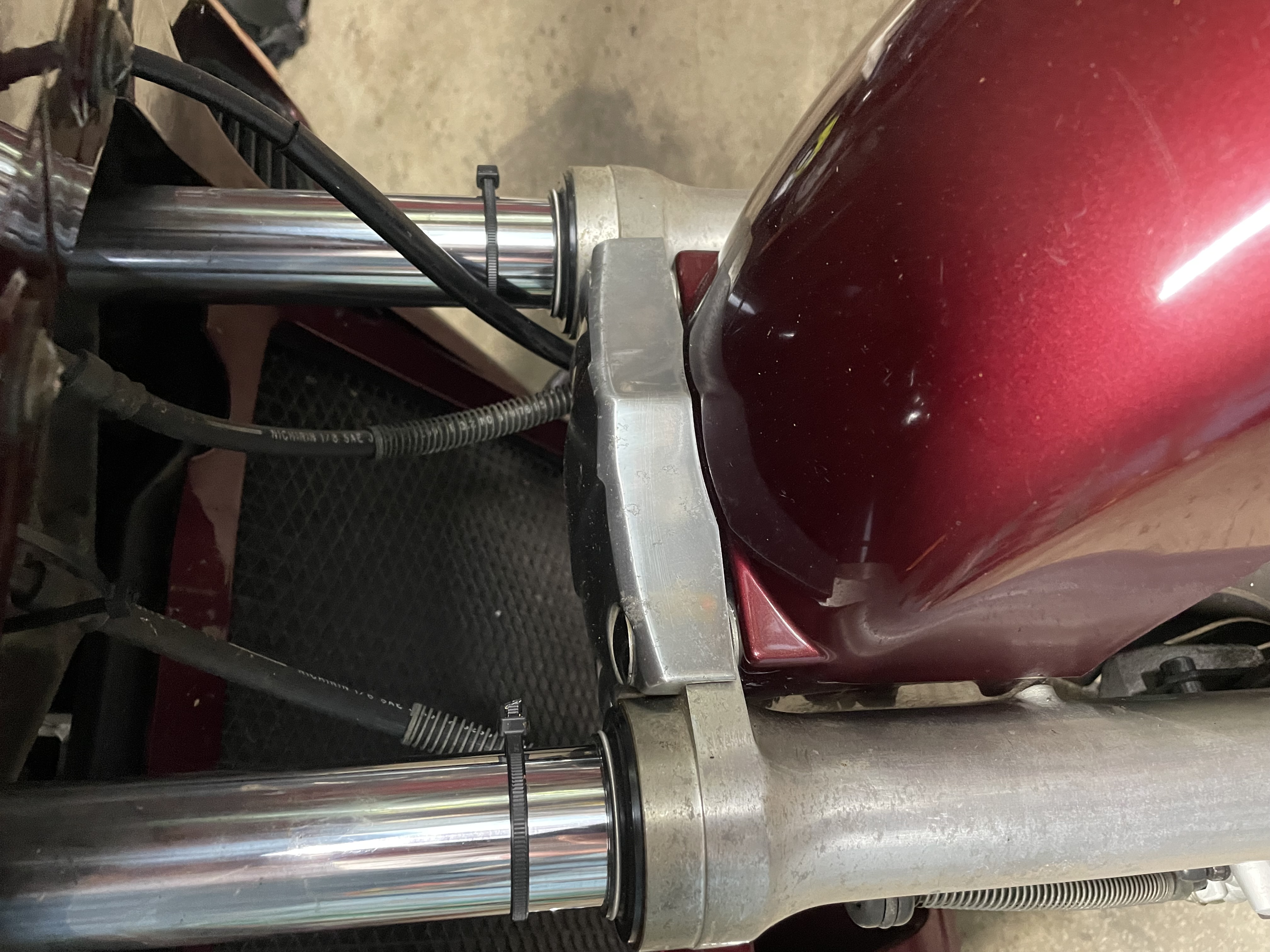

:cold: Regarding the front springs. When I take the bike off the side stand I get this amount drop in front. Is that normal??
I weigh in around 215. Should I be concerned about riding with a passenger around the same weight?

glvnthedream wrote: Wed Jul 26, 2023 8:57 pm Is the picture below the date code? 19th week of 2013?? It’s on the Dunlop 404 I pulled off the front.
No, the date code is a four-digit number in an oval. First two digits are the week, last two are the year.

That’s the only thing on the tire that comes close to a week and year.
Can someone else verify please.

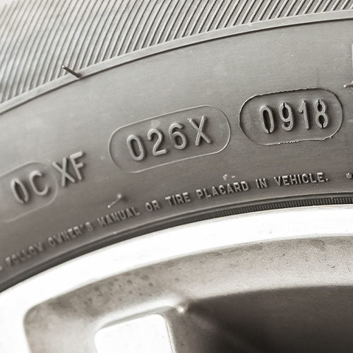

This is what you're looking for. 0918 indicates 9th week of 2018..

Nothing like your picture on my tire.

Your tire probably predates date codes. This advice will probably set some people's hair on fire, but if it looks good, not cracked or any other signs of unusual wear, I'd keep using it - it'll wear out on its own soon enough.

glvnthedream wrote: Wed Jul 26, 2023 9:17 pm :cold: Regarding the front springs. When I take the bike off the side stand I get this amount drop in front. Is that normal??
4-5 month newbie here.
I base my suspension performance strictly upon feel. If you have the stock suspension, and have fresh oil in it (I think you said you'd put new fork seals in) both front and rear, then go by the recommended air pressures, and you'll be fine. If you find you need to put excessive amounts of air in (like some guys on here do) then you need to think about replacement and the springs are worn out. I only replaced mine with Progressive because of wear (fronts were like slinkies) and damage (elevated unmarked railroad crossing in Georgia at 50 mph blew out my rear shocks, and it was cheaper, easier, and faster to replace than rebuild).
Which reminds me... we've had a few discussion about tire pressures on here, and I discovered the factory tire pressure sticker inside the left side cover day before yesterday. Never really noticed it (as in bothered to read it).
Front tire under all load conditions: 32psi
Rear tire under 265lbs load: 32psi
Rear tire over 265lbs load: 40psi
Total load capacity of the VXII is, IIRC, 465lbs. So with two 215lb passengers (don't forget the weight of gear and anything you've got in the saddlebags or added to the bike) you're fine, but you will want to bring everything up to max (fork air pressure, rear shock air pressure, damping setting, rear tire air pressure) as in max recommended, not what it says on the tires.
