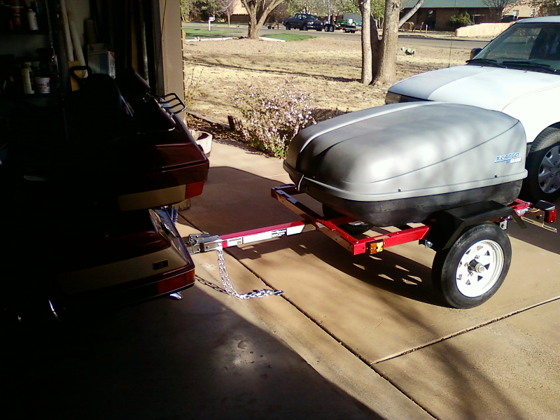

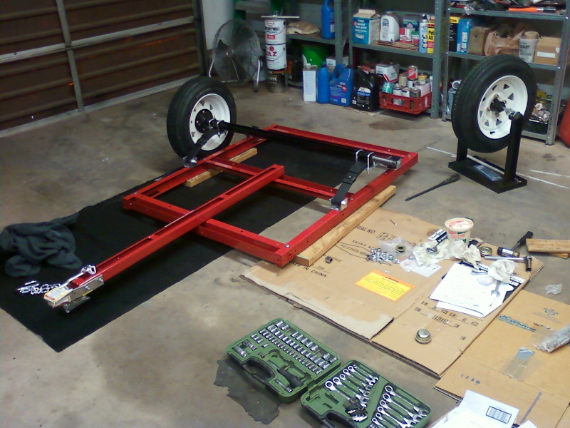

I'm now building my trailer, Harbor Freight (HF) 90153 trailer chassis and Sears X-Cargo box. Box is just loosely placed to get an idea of how it will look. Next step is to procure a sheet of 3/4" thick plywood for the deck to mount the box on.

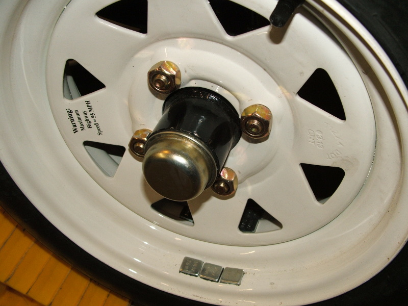

I'm using my Harbor Freight tire balancer. Supplied tires and wheels were not balanced. One required 1.5 ounces weight, the other 3 ounces. I'm using 1/4 ounce weights from HF, that was 12 pieces to make up 3 ounces. I checked into getting 1 or 2 ounce stick ons, but the costs are too high at the local auto parts stores. I don't do enough wheels to purchase in bulk quantities.

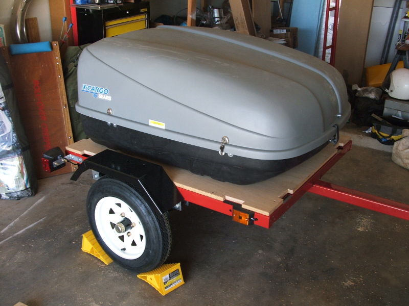

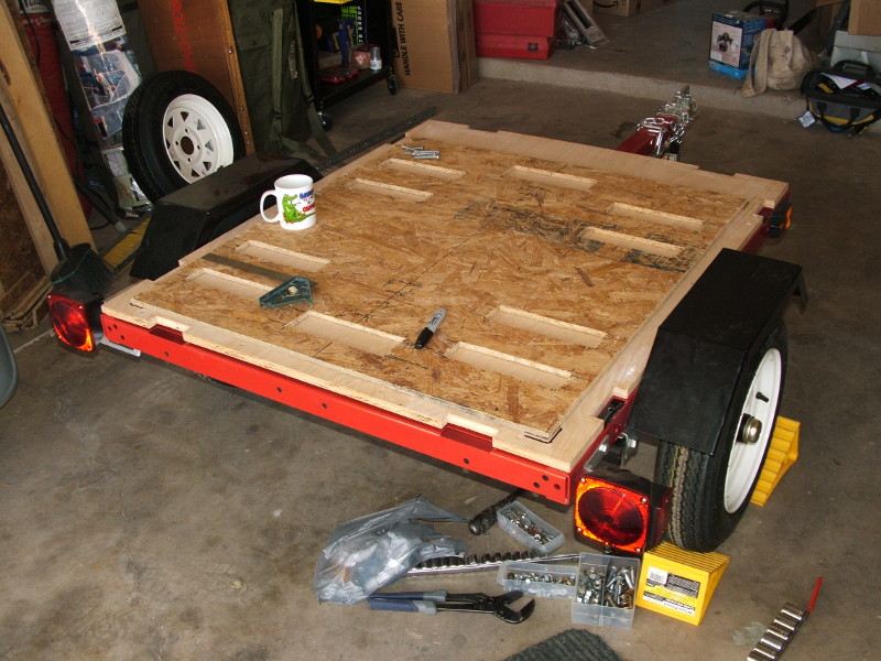

Actually, after relooking the specs, the 90153 12" tire model and 8" tire model have the same platform space (40.5"Wx48"L), the specs on the 90153 include fender spacing. I got it titled and licensed at the New Mexico Motor Vehicle Department Friday, cost me all of $46 including a permanent plate. Plate is the standard trailer plate, much larger than my motorcycle plate.
Since, I'm adding a 3/4" plywood deck. To reduce the spring rate to that suitable for the load I will be carrying by motorcycle, I will remove two of the leaf helper springs, leaving the base spring. I found this trick on one of the Goldwing forums. I also bought a 4'x8' sheet of 7/16" oriented-strand board (OSB) sheathing. This will be used to shim under the X-Cargo box to provide a structural flooring base so any heavy objects are supported by the board and not the box's molded feet pads. Over time, I could see the plastic continually flexing to the point of cyclic fatigue if I didn't do this.
For tie down brackets, I have two 3' long 1.5"x1.5" L channel steel brackets with holes every inch or so, that will run along lengthwise along the inside left and right edges.
Since OSB does not do well absorbing water, I will prime and seal both it and the plywood with oil based primer and paint a coat or two of Rustoleum enamel on both, sealing all hole edges as well.
How do you folks connect the chains? My trailer hitch doesn't have rings for the chains. The 1-1/4" receiver doesn't have rings welded to it like some of the other bikes. Is there a 1-1/4" hitch tube that comes with the rings?

Found a caveat. My HF weights are falling off the wheels. Seems they are coated with a type of paint that doesn't allow the HF weights to continue to stick, in spite of me carefully cleaning off the surfaces of any oils and residues prior to installing.
