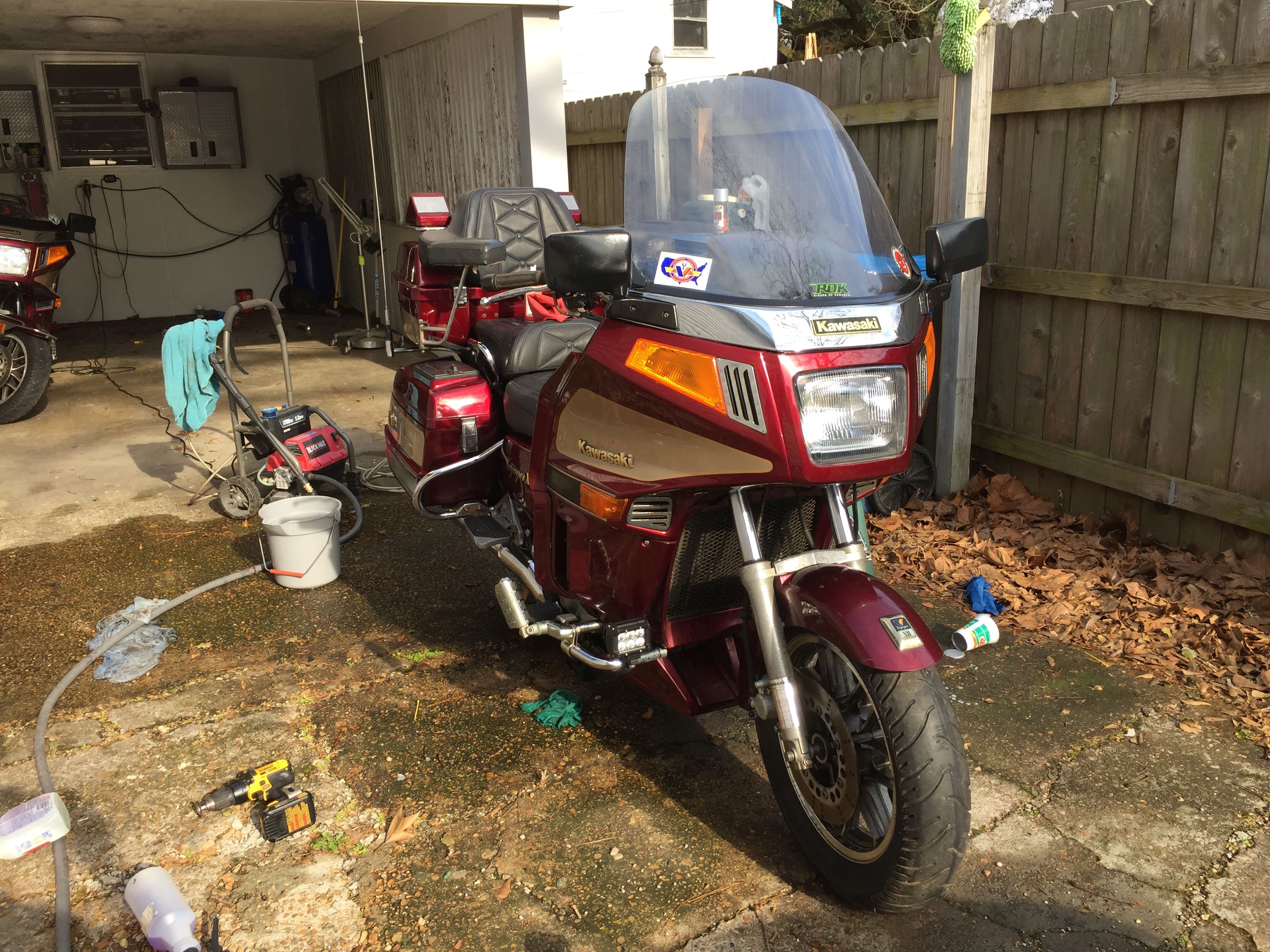

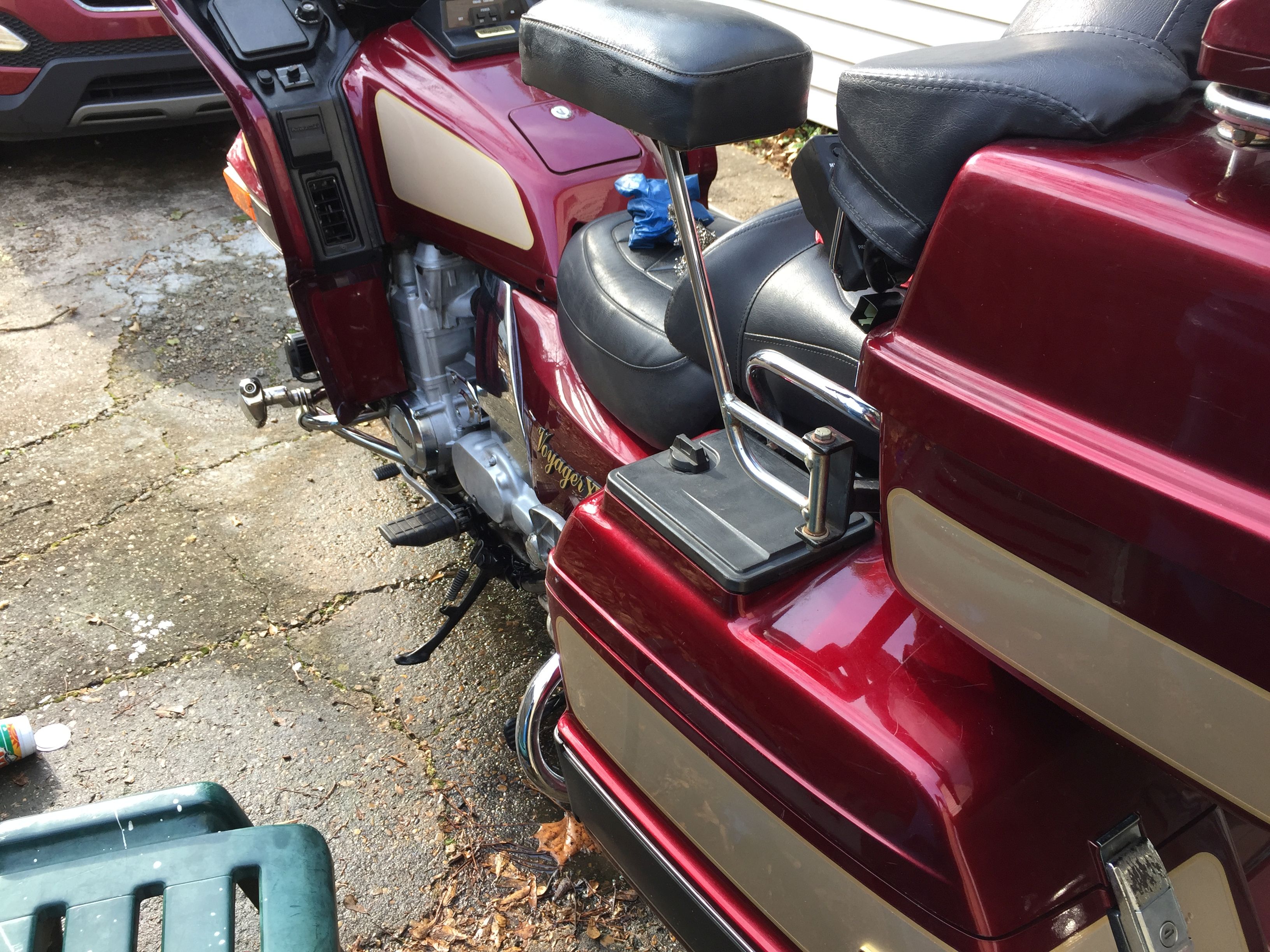

I rode Charlie's bike to Sunset (about 40 miles) so It could be detailed by a friend. The bike runs like a jet! Carl did an amazing job on the carbs. It runs and handles wonderfully. Now it has me thinking of sending my carbs off to Carl. On second thought do I want the pain and agony of getting those suckers back on? I will have to think about that one. My bike still runs good. Anyway my detailer friend may already have a buyer for Charlie's bike but has already fallen in love with it.
I knew my luck had to change and it did. I got called by my detailer. Someone wanted to see the bike in action. Well the engine cut out a couple of times which I could not reproduce. However 2 things became apparent, the temp gauge doesn't work, probably the sensor, and one fork is leaking at the dust seal like a gusher. So now I will have to replace both fork seals and dust seals because the dust seals are cracked. Stay tuned.

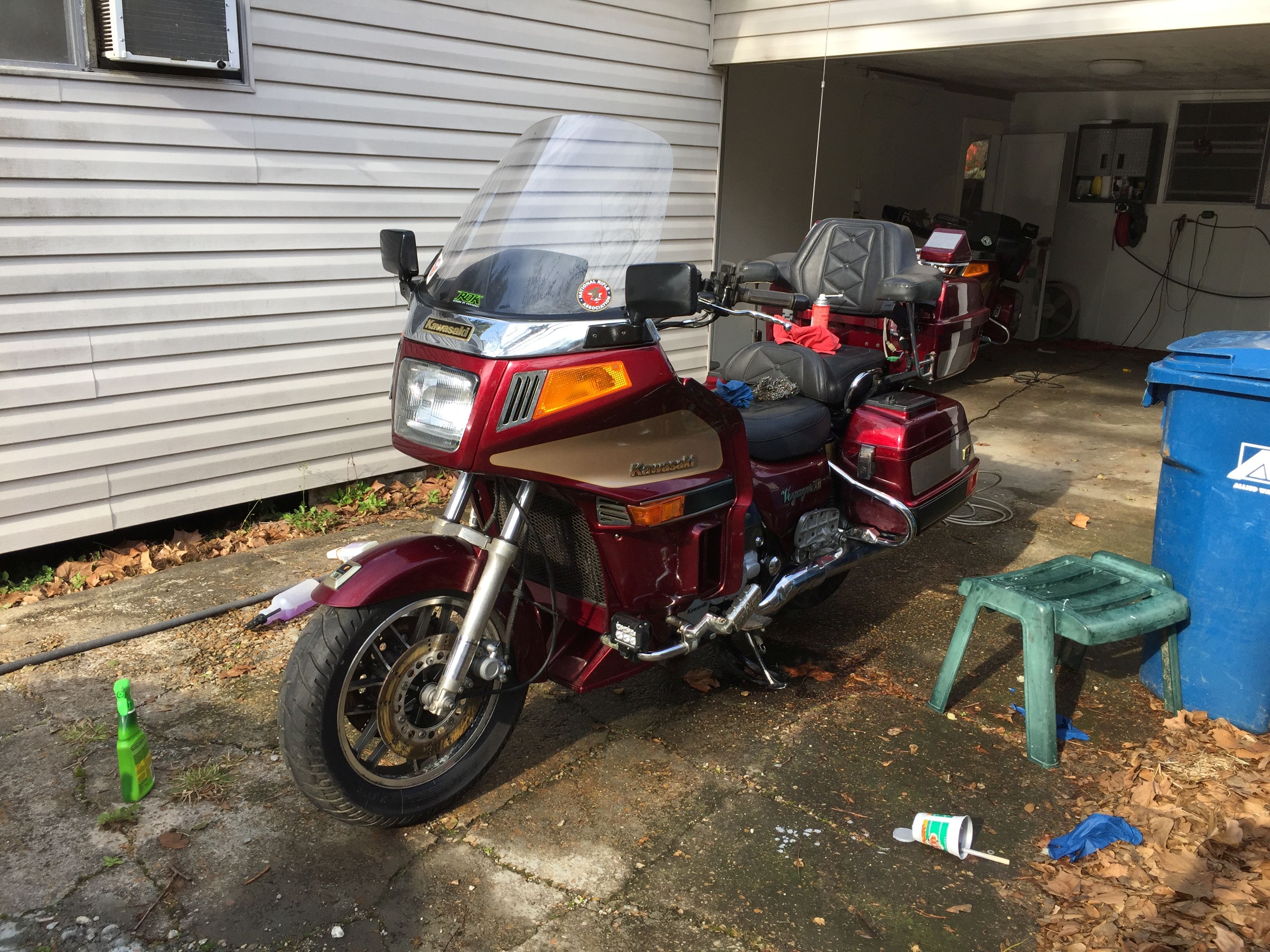

Get and try a Seal-Mate before ordering new seals. You might not believe how easy it works, and your wallet will certainly be glad.
Mr Jensee
Posts: 1987
Location: Lafayette, La
Re: Charlie O'Neal's Voyager project
Post by Mr Jensee »
Neal I have a sealmate and started to use it but oil was gushing out of the right one. The dust seals are cracked all around. Nothing but new seals are going to work. My friend and I are going to change them out when they come in. Should take about a week to get the seals in.
