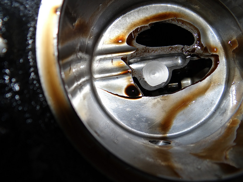

Thank you everyone for the quick responses. Very helpful. I was going to post some pictures to show how badly damaged it was but that will have to wait until tomorrow.
It looks like I will have to replace the oil pan (pn49034), oil filter case (pn32099), the pin, oil pan gasket (pn11009a), possible breather body gasket (pn11009), 90mm oil ring (pn671). There are a few more options from the oil filter case. Little gaskets and O-rings. I just knew I wasn't the only person this has had to have happen to. I have the saddlebags off and most of the plastic from the front and lower area. Next is the exhaust. BTW I did try and take off the oil pan while the exhaust is still on there. No chance. I don't have much room to work on this but since winter is coming I have a few days to tinker with it. I will keep you posted and hopefully you will see us on the road.
Once again thanks for all the help. More for giving me hope that it can be done.

https://flic.kr/p/LPEWLN
https://flic.kr/p/LPJZ7k
I think this is correct. One picture show the rim of where the oil filter sits and the other picture shows a close up of the damage to the threads from the pin. Let me know if this didn't work. I think I have all the parts ready to be ordered. Thanks!

Why are you replacing the expensive oil pan? what is damaged is under it, i have never seen the need to replace the pan when all that is broken is the 32099-1082 oil filter case...

carl leo wrote:Why are you replacing the expensive oil pan? what is damaged is under it, i have never seen the need to replace the pan when all that is broken is the 32099-1082 oil filter case...
Awesome, thanks! That's what I was hoping for. Do you have any suggestions for replacing the part? Would I need any new gaskets? Or would I just reuse all the O-rings? I understand that it would matter if it was torn while being disassembled. I do have the manual so I would just be following what they say. Looks like it will take a week for the parts to get here. I will post some pictures when I am ready to get my hands dirty.

How bad is that face that the oil filter cap seals to. Maybe a side shot picture of that area would show if it is that bad. You would think that if it is damaged you would be able to dress that surface and not have any interference problems. Hopefully you don't have to spend any $$$ on a new pan could also look for a nice used one if needed.
I would not reuse the "O" rings. Not worth taking a chance on. Replace with new ones! IMHO of course.

The good news is the part is still available, at least on Bikebandit.com. The price is reasonable too at $170. Yes I agree with other posters, replace the O rings as well. You don't want to have to go under the engine again more than you have to.

Great news. The oil filter case has been replaced. I cheated and instead of taking off the exhaust I was able to loosen and spread them enough to be able to take off the oil pan. I replaced all new gaskets and was able to reuse the oil pan. Now I have a small amount of leaking oil so I need to check the bolts and hopefully nothing has come loose since I have only been starting it up. Putting all the fairing on this weekend and going to try and go for a short ride. This winter was also the time to replace the front forks with Progressive Suspension and I can't wait to see how they feel. I have some new rear shocks coming in the mail sometime in the next month. So hopefully this will be ready for a road trip. :woohoo:
Thank you to everyone how helped out with ideas.
