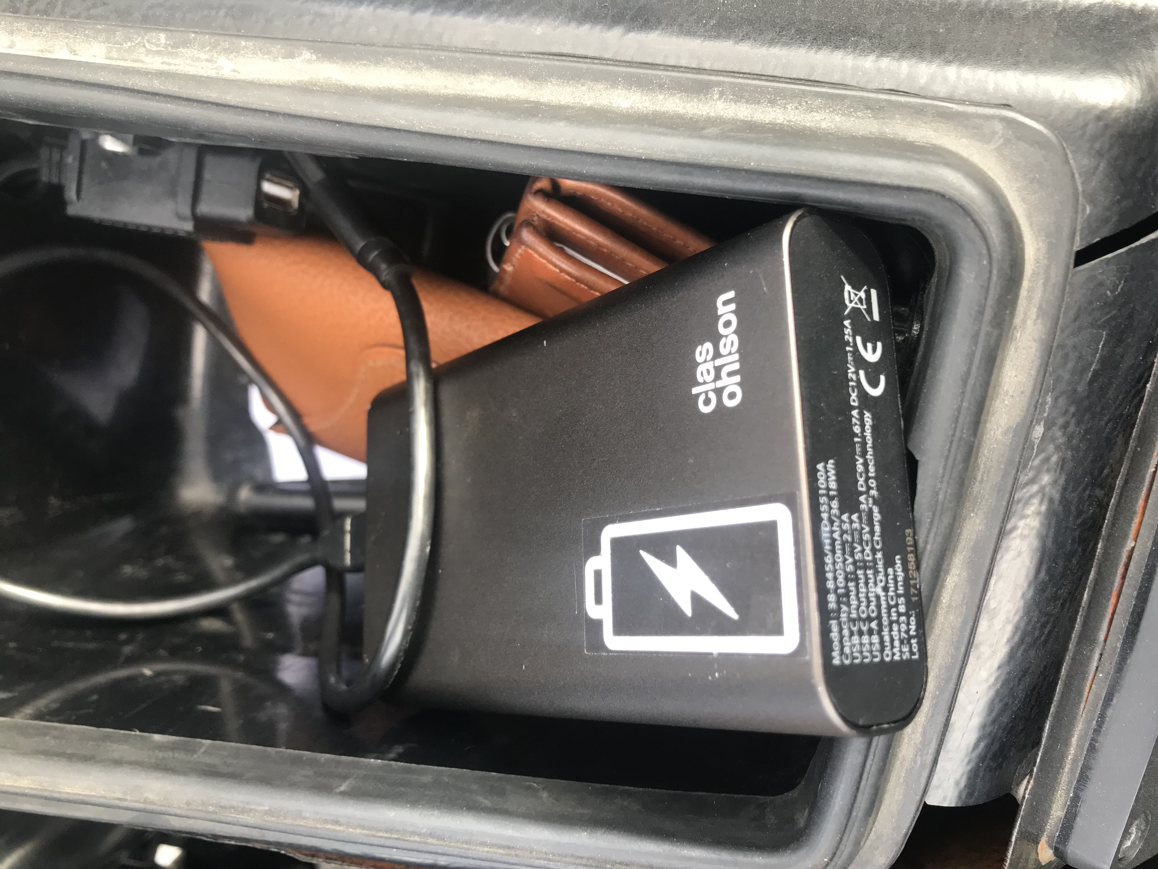

It lives again :woohoo: And I suspect my new power bank to be the sinner. Is it possible that a fully charged power bank can mess up with the electric system?
The sinner?
The sinner?
I disconnected the power bank and for 40 miles it has now run smoothly. It starts by itself and the voltage readings is about 14V

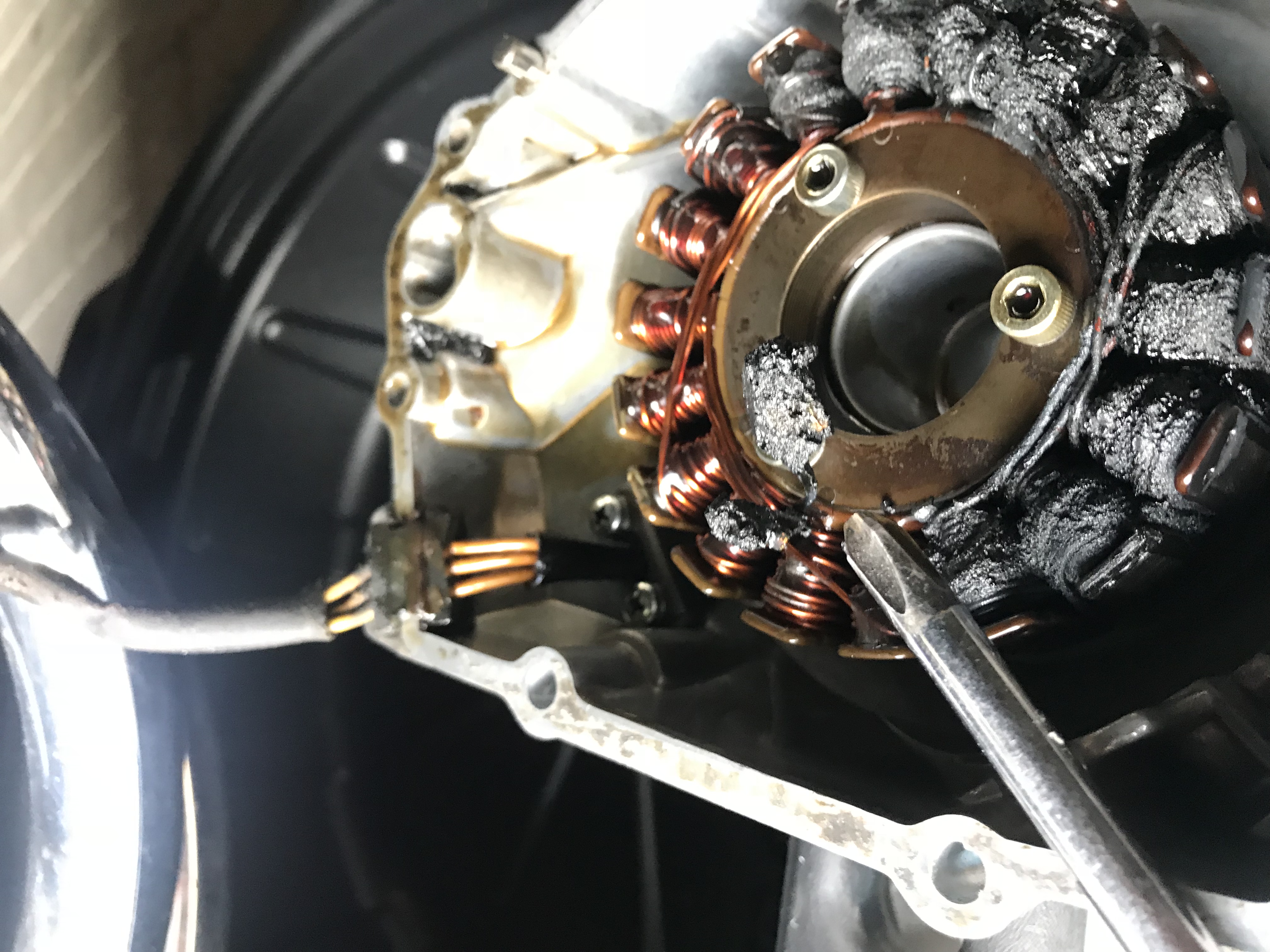

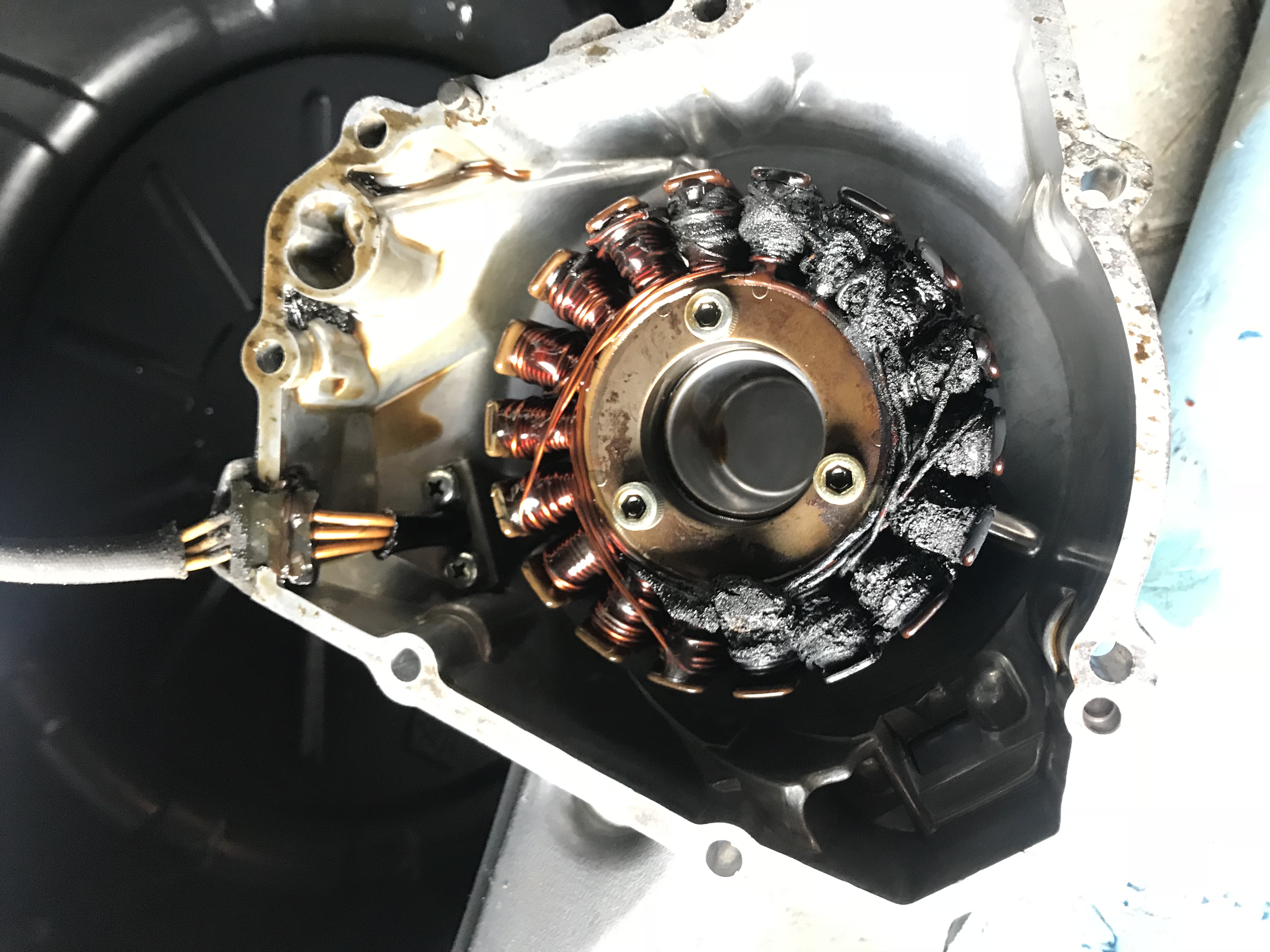

It seems to be the main alternator. Reading about 0,5V@4000 rpm. And it should be 50V
The sub-alternator is in good shape. Measure about 62V@4000rpm.
Luckily this bike has to alternators. That saved me on my last trip.

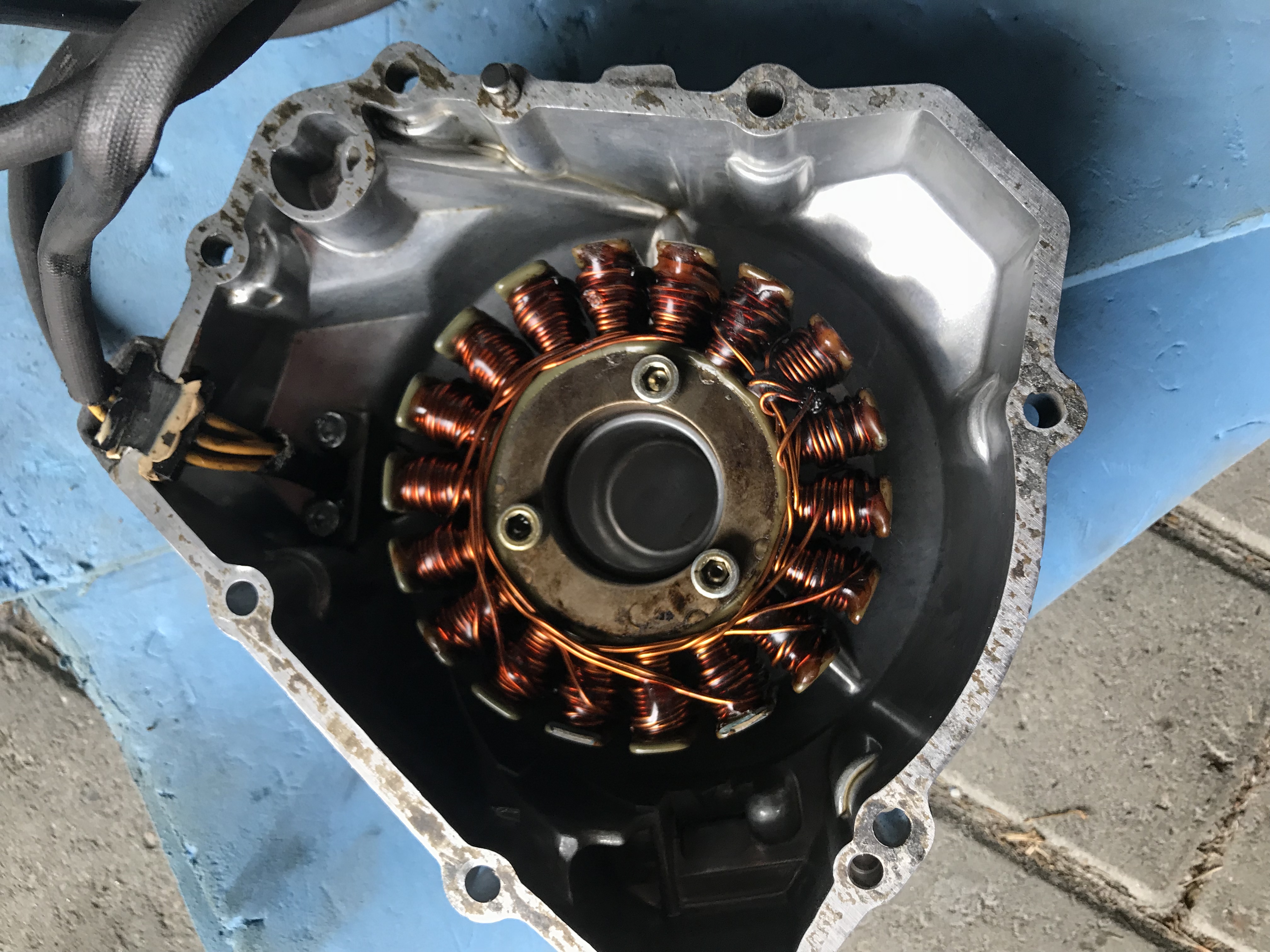

Update: this is the picture of the bad alternator
And this is how it should be:
Just going to mount it all together and test it
