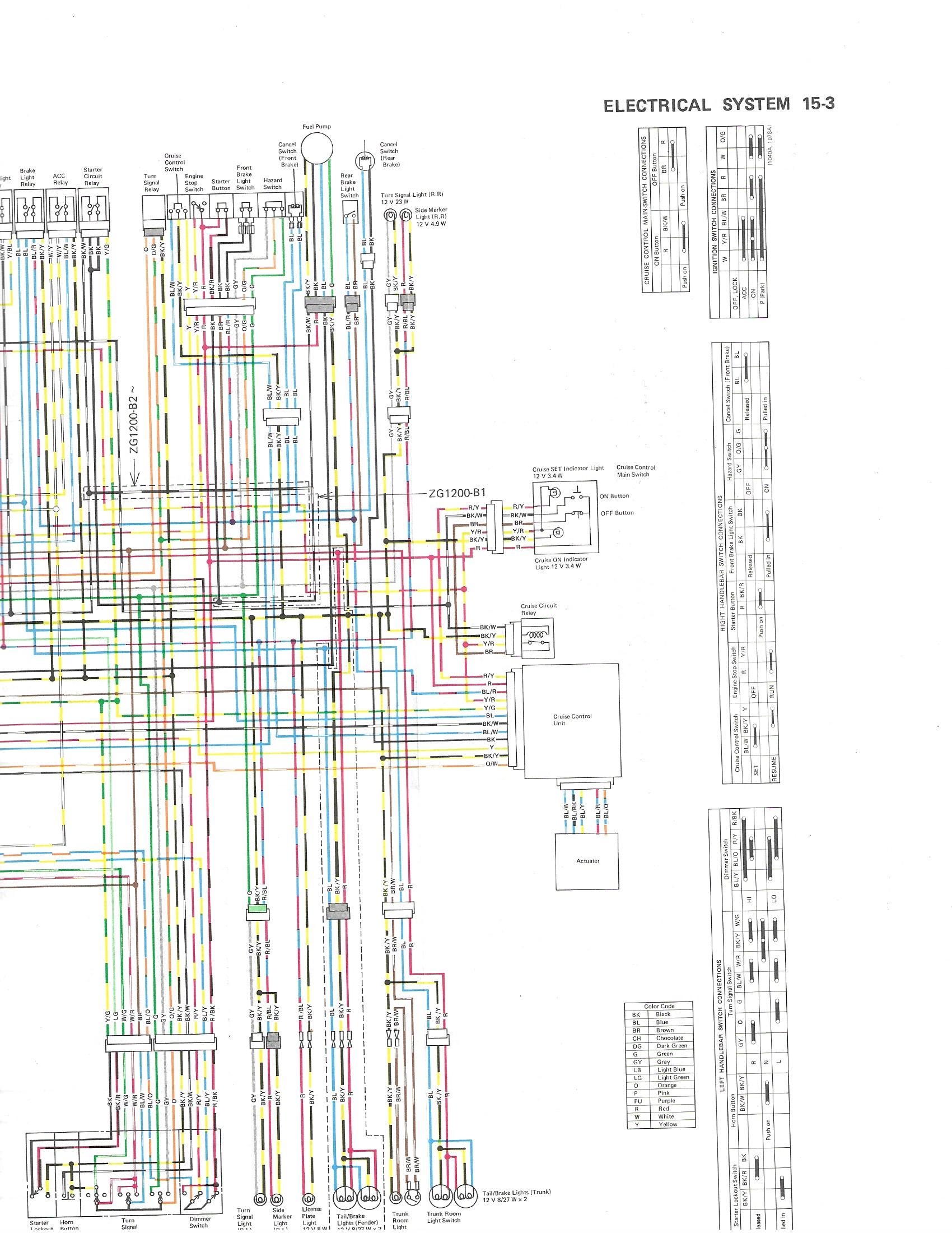

Re: Fuel pump run sequence
To further explain the difference from 1988 onwards look at the attached partial schematic and one can see the change from the B2, (1988), models onward.
Prior to the B2 models the Black/White wire to the fuel pump, which by the way becomes Black/Yellow after the last connector to the fuel pump, was fed via an internal brass crimp inside the harness wrap. This crimped connection is made to the Black wire as shown for B1 and earlier models.
