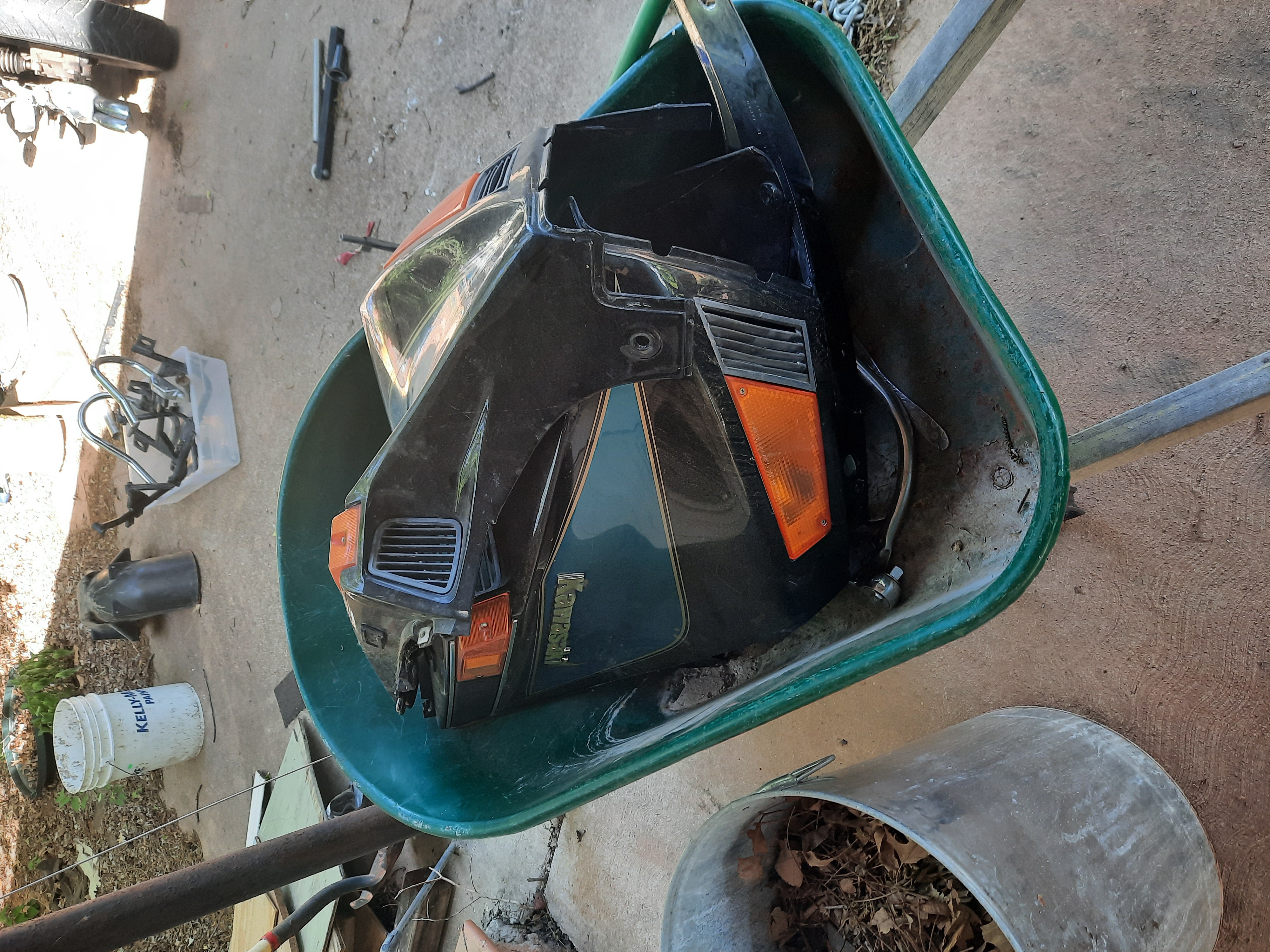

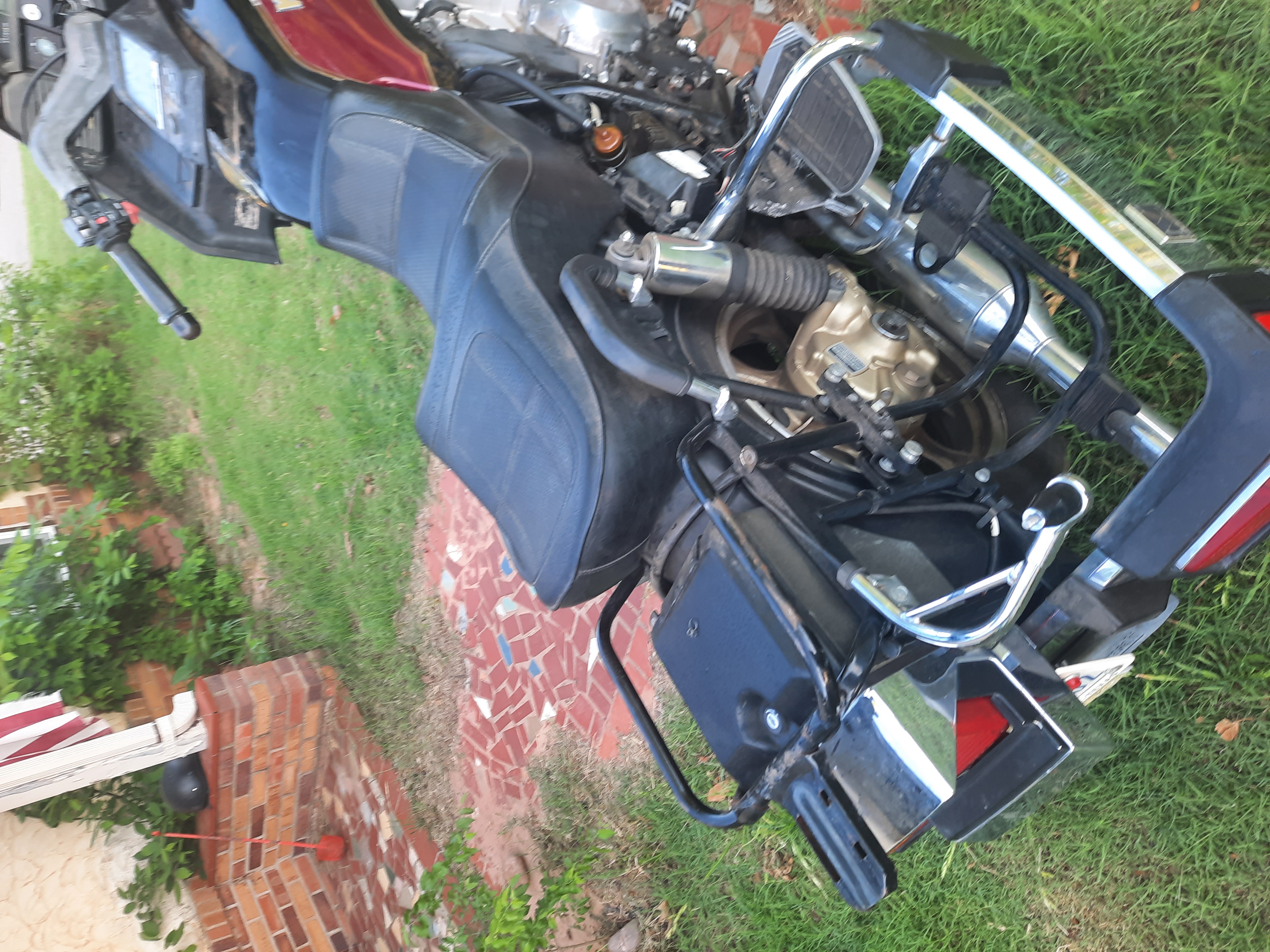

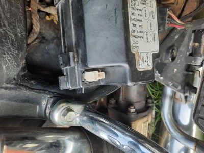

I sold the 1300. It was easy to sell because it was in easy to restore condition..y 93 however had many busted fairing parts. I have taken many parts off, reduced the bike weight a lot. The upper fairing halves i will have to reinstall because there are too many things and a zillion wires i cant eliminate without screwing something up. I want to take pictures of some wiring thats just dangling and hopefully you guys can tell me where they go.as bad as it now looks it still starts and runs.before i pulled the igniter back, removed the airbox and battery tray i coukdnt see how to remove the carbs.the tiny phillips screws holding the clamps would be impossible to get to with everything in place. One of you said he wouldnt help me if i cut corners such as trying to use tires off the 1300 or just one throttle cable. The tires are totally different .i thought i could save money.not cut cirners. No bike i owned has more than one throttle cable . This one does and by design has to. I know now. I see the cable and how it connects to the carb linkage. Only one though.my manual shows 2 cables, connected to a box. Then just one to the linkage and the second stop at the junction box, is that right?? Please help.thank you.
