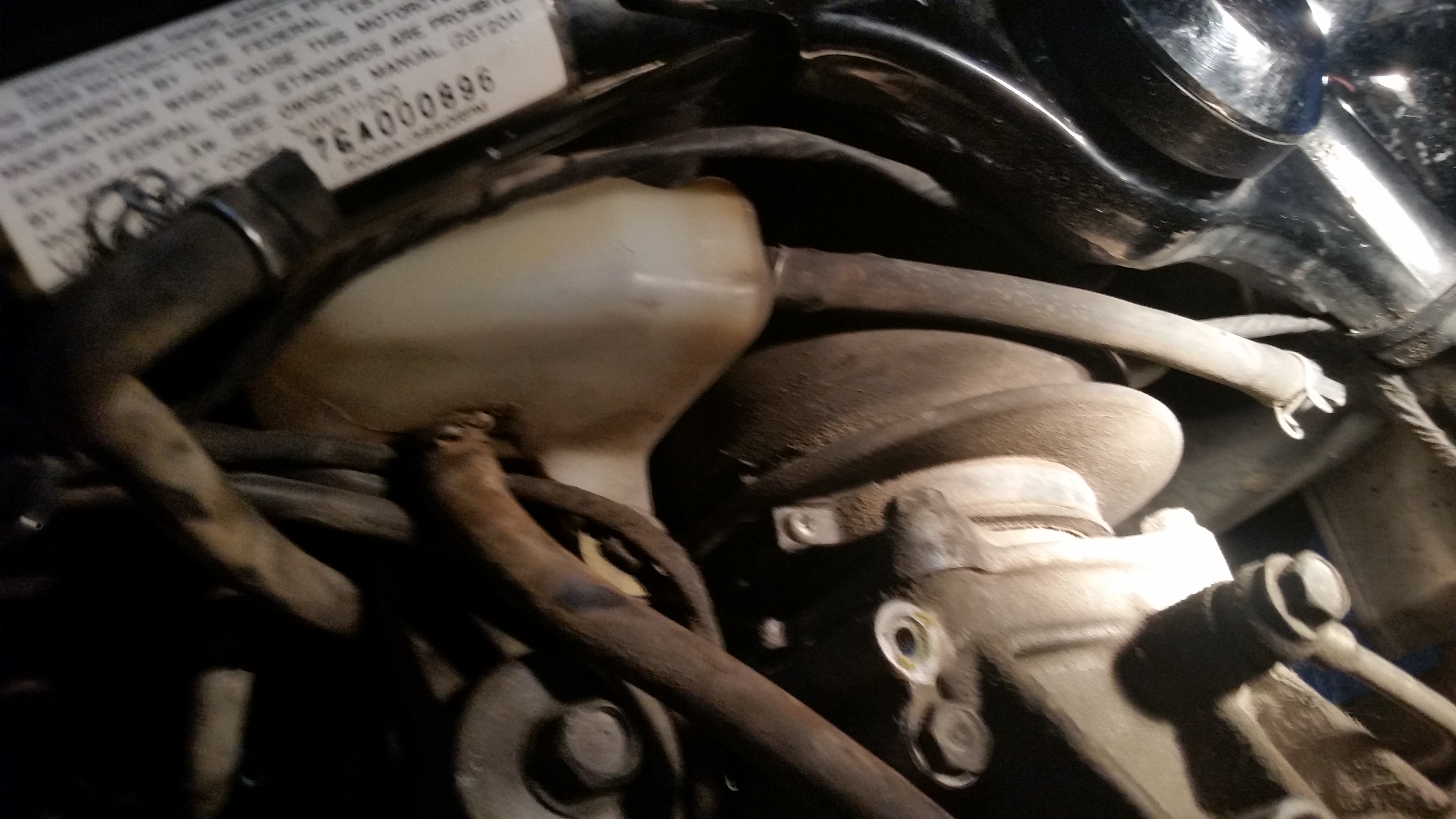

When you drain your carbs of gas, do they flow into this thing or do they just pee on the ground? (Double posted the pic and it's rotated for some reason.)

I can't speak for the California models but the other U.S. state models and the Canadian models just exit onto the ground by the center stand area under the swing arm.

Yep, it pee'd all over the ground. Nice to know.
