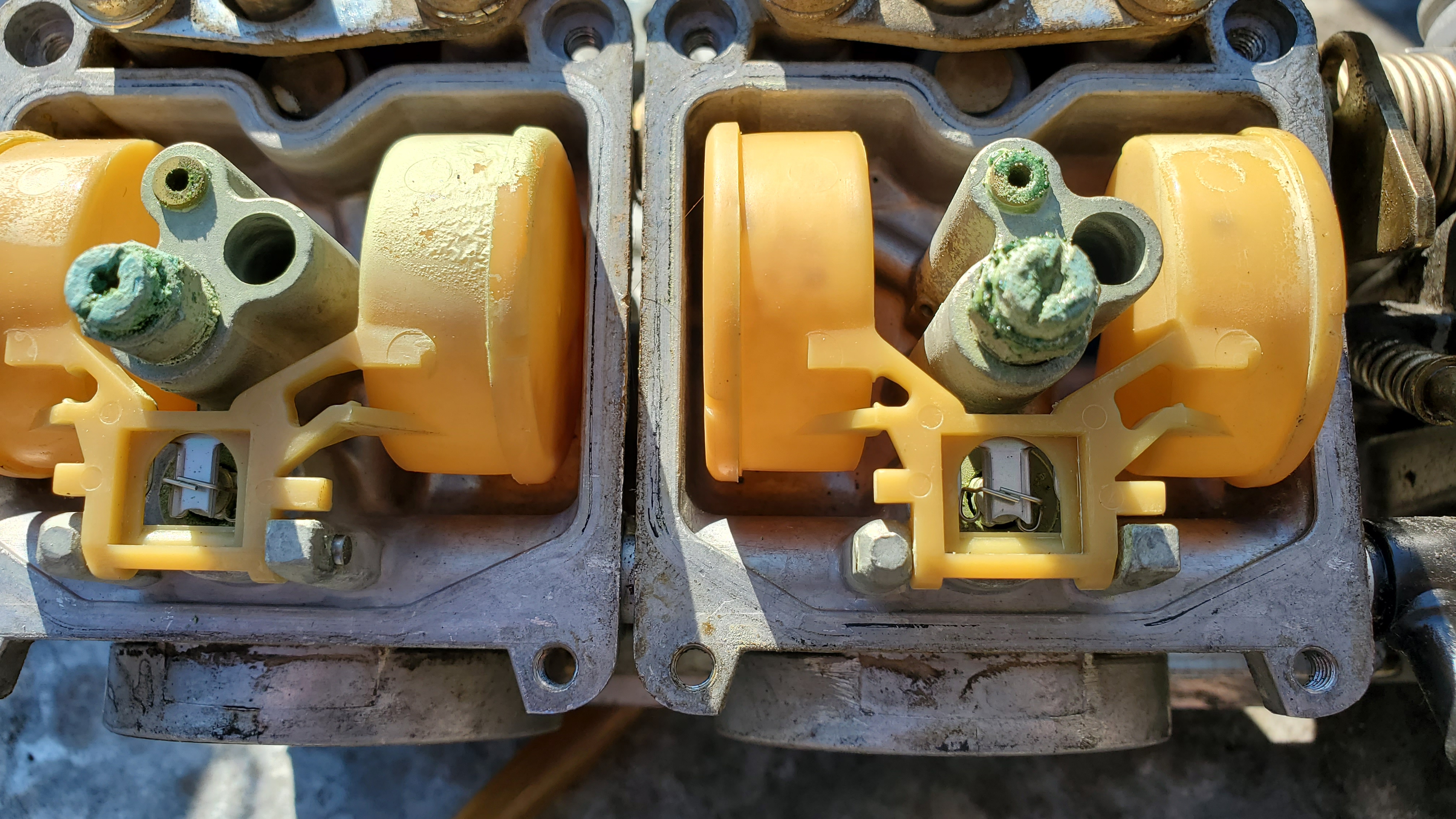

I found a blue wire that was off and placed it on the positive post, battery light now off.
Used a wee bit of air pressure, now front and rear suspension working.
Ordered new tires, and ordered 4 idle jets, 4 main jets and 4 float bowl gaskets (from the dealer)
Put a whole can on seafoam in the tank, so far rode around my neighborhood at different times and done 12 miles, still only running on 3 cylinders, I guess I'll pull the carbs and clean them and replace whats needed.
Ill keep you updated.

You’re me last year. Some additional things I did that you may want to consider in addition to the obvious stuff (motor oil, etc)…. Since it’s a winter project.feelergaugephil wrote: ↑Mon Oct 17, 2022 8:37 am This will be my winter project....
I replaced my windshield. It wasn’t horrible, but visibly scratched from cleaning, and yellowed a bit. Looks great with the new one.
New spark plugs, I like E3’s currently.
Cleaned every piece of chrome with Brillo pads to remove any surface rust that was starting to form from sitting. It all came back beautifully.
Differential oil change.
Flushed and changed the coolant. It’s actually very easy on this bike, with a drain plug underneath in the front. Used the Prestone flush product, it worked great.
Flushed through new brake fluid in all hydraulic systems. Mine had more miles than yours, but brake fluid tends to collect moisture over the years, and it’s a good idea to start fresh.
I’d snip the zip tie that holds the wires coming out of the fuse block to the upper left frame rail. It becomes a hinge point for those wires as you turn the handlebars over time, and eventually fractures them, creating a very difficult to figure out electrical problem. Just let them hang free.
I despise lugging around stuff I don't use. I replaced this dash light with a volt meter that indicates the voltage by color and flashing. Taking the dash apart is a bit of an adventure, so I replaced the dash lights with LEDs while in there. And hooked up that temp gage supplemental ground.
I highly recommend changing the fork and shock oil, and swapping in Progressives while you're in the forks. My '96 had disgusting oil, especially in the shocks. I used ATF to clean it up, which worked as I recently changed to real fork oil: the ATF was still clean.
I don't think these brass items need to be replaced unless you're re-jetting to a different size. I clean them with an old brass-wound G guitar string.
Which plug is nasty black? Or which pipe is slow to get hot?
Consider breaking out the sabre saw and cutting the old one down, way down. It's much nicer for the short rides on hot days. You can even paint it black if you want. They aren't that hard to swap.
At the very least, check it. My final drive (previously unvented) blew out almost all the oil, probably mostly on one ridiculously hot ride.
Like other fluids, mine (<30k miles at the time) was disgusting. I ran the Prestone flush twice, plus a "rinse" of actual antifreeze, before buttoning it up with fresh antifreeze. Also, my overflow line was pinched in the frame -- not good.
> Flushed through new brake fluid ... it’s a good idea to start fresh
Most of the fluids above should be changed about annually, but that's especially true of brake fluid. Start fresh every year.
This forum has threads, generally many threads, about all this stuff. And you might want to take a gander at viewtopic.php?t=12591. (I plan to look at it again myself and edit to work in these newer suggestions.)

So far, I'm now 55 years old, and have the "lost syndrome" very very annoying! I bought 4 new idle jets, 4 main jets and 4 float bowl gaskets and placed them in my shop, and mr.invisible has took them all! I cleared my whole shop (8 hrs) looking for the bag which they were in... GONE! re ordered again..... so aggrivating, like the daily look for my keys!!!! arghhhhhhhhh.
Anyway, changed the plugs and put some "Yamaha top engine cleaner" in each cylinder, fired up on 4 cylinders!! YAY!!! (short lived) then back onto 3 cylinders, rode it 1 mile, still on 3, now decided to pull the carbs....
Who designed that airbox!!! including the broken tab, I managed to pull them out the left side of the bike, God knows how I'm gonna get them back in!!! anyway, once airbox out, then the mind boggle of unhooking those cables, finally got them out.....
Carb inspection, look good on outside, #1 thru #4 fuel screws set at 1.2 turns, which I will after rebuild and clean set these to 2.5 turns out.
strip carbs, #3 carb, stopped up with that awful brown goo! main jet and idle jet completely stopped up, there's my issue of running on 3 cylinders, now waiting on new replacement stuff coming in.... arghhhhhh!!
I was worried about the battery light issue and the blue wire, battery is fully charged from the bike, so thats good.
New tires are here, just will wait till its running perfect before I install them.
Windshield, looks like may have to replace it, its foggy.
Changed the oil and also the fuel filter, completely forgot about the oil filter, ordered that....
So far, thats it, been riding my Kawasaki concours 1400 with this beautiful weather here in Louisiana. update soon on how its coming.

Good luck on challenges. fyi I live at 1100 meters. My pilots are set at 1 7/8 with experimentation of mileage and power. I get 52 mpg two up on the hwy and 40 to 42 in the city and no bogging down and she is quick. I suspect there is a fairly wide range on these bikes. now I am riding colder weather the idle speed has increased with the denser air charge...now running more lean so maybe my pilots are still a tad on the rich side but not changing it anymore. you will likely find your original package of parts when you have the bike all put back together lol
