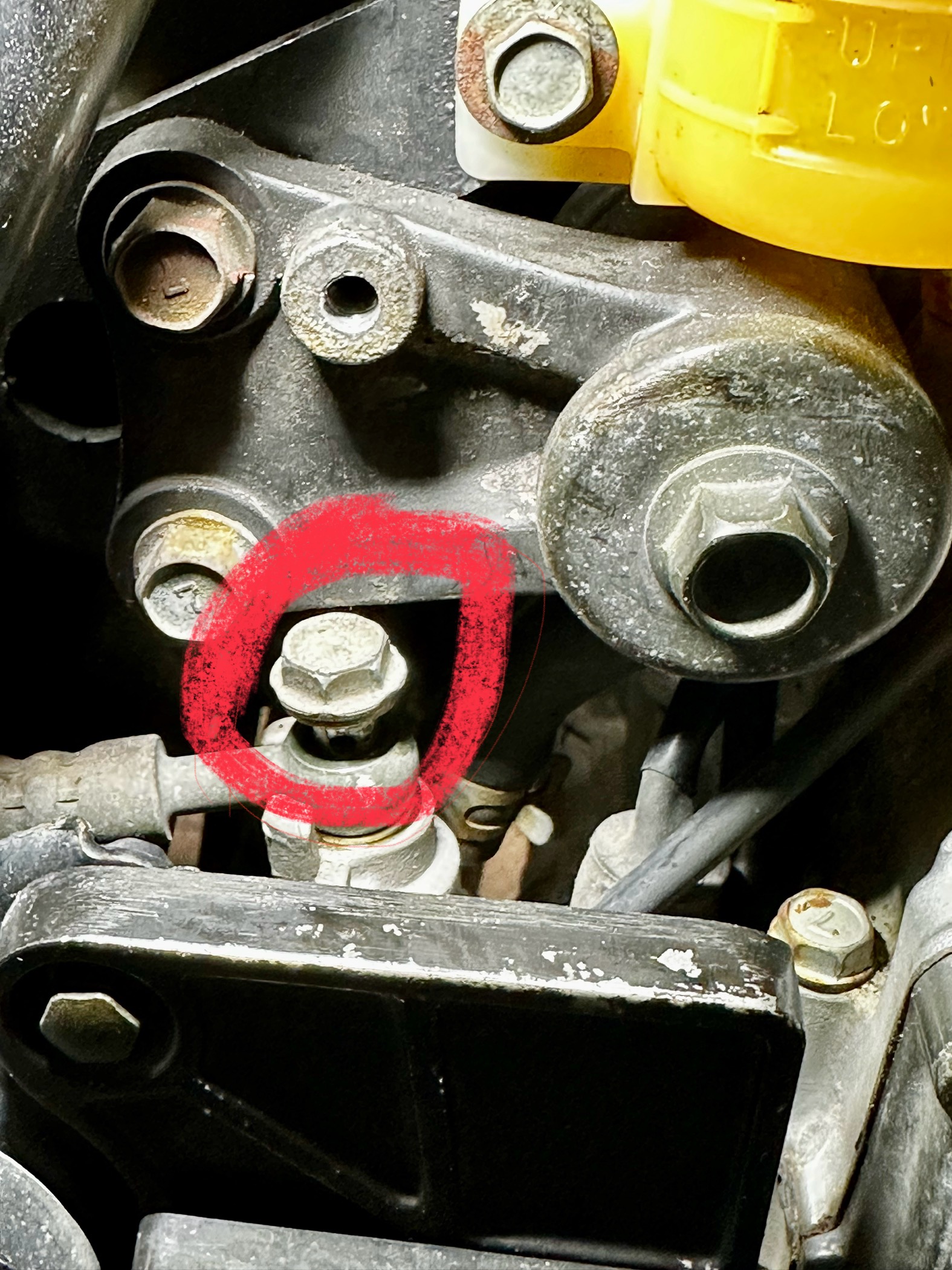

Putting new brake lines on my 2002 and am having troubling replacing the rear brake line due to not being able to get the banjo bolt out closest to the master cylinder.
Does the bracket stopping the bolt from coming out come off easily?
Thanks

Hi, just loosen the 3 brake bracket bolts. The master cylinder is bolted to the back of it.
Once loose you will have all the room you need. good luck.

I appreciate the reply mate. I am always concerned removal of an unknown bolt might cause unexpected "fun"
Regards
Greg
