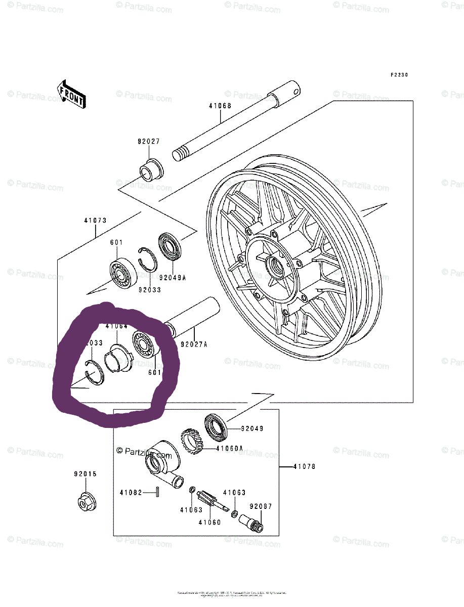

You may not need to rebuild the gearbox. Check the speedometer gear - the sheetmetal thingie with tabs that's on the wheel hub. If it has any damage at all, that's probably it. They get chewed up. Five dollar part, at least it was when I replaced mine before the pandemic. So it's probably thirty bucks now

Did you replace the speedometer gear? I know, it's confusing, there's the cheapo sheetmetal sender on the axle that's called the speedo gear, but isn't a gear, and there's the speedo gear housing, which does have gears. I'm sorry, I'm wrong, it's called the Speedometer Receiver. Part #41064 on the diagram https://www.partzilla.com/catalog/kawas ... ront-wheel. It's the same for all years.

I agree 100% on the "speedo-gear". Mine had some tearing in the thin metal so after a year of knowing it was damaged, it finally failed. Got a new one from Carl Leo and in seriously just a few minutes had it replaced and has been working great ever since. That's been about 8 or 9 years now.

I took Gertrude to get a new front tire mounted and brought the part and asked the mechanic to check it. He said "it's chewed up a little bit, but they get that way" and handed me the part back. Charged me $50 "diagnostic fee" even though he had the wheel off to replace the tire and I'd provided the part that he didn't replace even though he had it off anyway when he removed the tire.
I never went back to that shop.
It's a five dollar part. Get it from Carl Leo. Replace it anyway. Hardest part of the job is getting the rear end down and the front end up whilst on the center stand - I use a floor jack. So in my case the hardest part of the job is carrying the jack downstairs from my apartment.

Ok so I see what part it is my final question (praying) does the entire front wheel come off to change the speed cover? Or can I change it with only removing the nut on that side? I have never done this before so it seems monumental to me. Thank you to all of you who have been sharing your thoughts and ideas. I love my Voyager and have not ridden since this happened and my summer is getting away from me. Any additional assistance will be greatly appreciated.

You do have to remove the front wheel,which includes removing the calipers.

Which is fortunately a really easy job. Just make sure you don't squeeze the brake lever while you have them off. That doesn't break anything, it just makes for more work to compress the pistons to open the gap between the pads so you can get them over the rotor.cushman eagle wrote: ↑Tue Jul 30, 2024 7:21 pm You do have to remove the front wheel,which includes removing the calipers.
All in all it's an easy job. Two bananas.
Put bike on center stand.
Disconnect speedo cable from speedo gear housing (you don't HAVE to do this, but it makes it a little less cumbersome putting it back together).
Remove calipers.
Remove axle pinch bolt.
Remove axle nut.
Jack under engine to get front wheel high enough to pull it out from under the fender.
Put a Phillips (hey, we all use JIS screwdrivers on our bikes now, right?) screwdriver through the hole in the end of the axle and yank the axle out.
Jack engine up higher because you didn't lift it high enough to get the wheel out from under the fender.
Actually you don't have to pull it all the way out, just enough to pull the speedo receiver (the five dollar stamped sheet metal thing with tits, er fingers, er tabs, yeah that's it tabs, out.
Put a little grease on the surface the new receiver thingie rides on (on the wheel)
Put the new receiver thingie on the wheel. Put the gear housing onto the receiver thingie and the wheel.
Put the wheel back into position on the bike and put the axle through. There are two tabs on the fork tube that the tab on the speedo gear housing must go between in order for it to be in the proper position and also not go spinny spinny and break something whilst riding.
Then reassemble in reverse order.
This all from memory, hope I got it right. Last time I pulled a front wheel was when I replaced the front tire last summer. Annnd... never rely on my memory. I can't remember what I had for breakfast. Oh, I just remembered, I haven't had breakfast yet.
