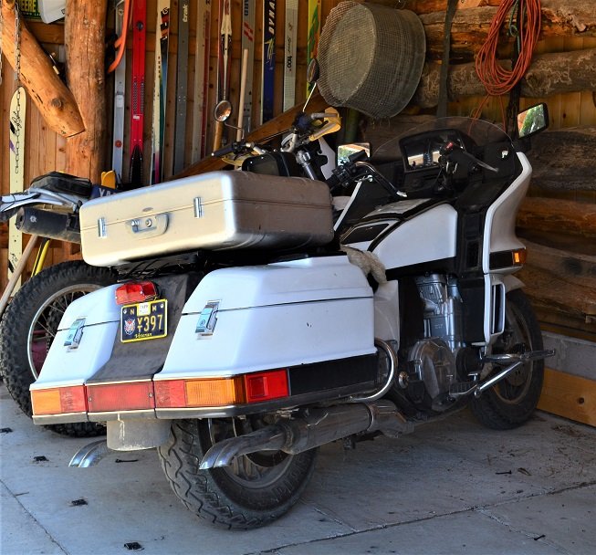

This might not have been addressed here because few XII have the "GoldWing" fender lights. I understand that Honda sued MaKa over it, and so since an early model year XII painted over the fender lens and abandoned it. I removed that paint, inserted 1157 sockets into the housing (which is still there), and started using those lights as part of getting rid of my trunk.
I also encountered issues, complicated by not being able to find reliable sockets. I wired these from scratch, working from the elec plug that used to go to the trunk. (I added a fender taillight at the same time, so no big deal.) In other words, I couldn't figure it out either. I'm suggesting starting over wiring these fender lights from sources under the trunk. I bet that'll be easier than trying to sort the existing harness, which obviously wasn't designed with LEDs in mind.
But I'm waiting for Dave to chime in, using his swell circuit-chaser app (that I'm very jealous of).
