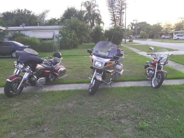

Let's see, :hmm: my combo would be Kawasaki XII , Kawasaki XII, Kawasaki XII, then a Kawasaki Vulcan Nomad, followed by a Honda. :gig: Oh and a Pontiac. I need a bigger garage.
Here's 3 of them, the other 2 are kinda buried at this time.
