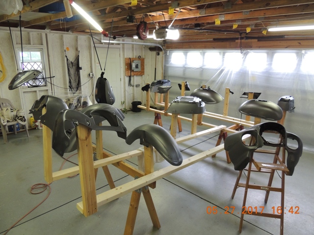

Here's the setup photo
All scuffed and waiting for primer

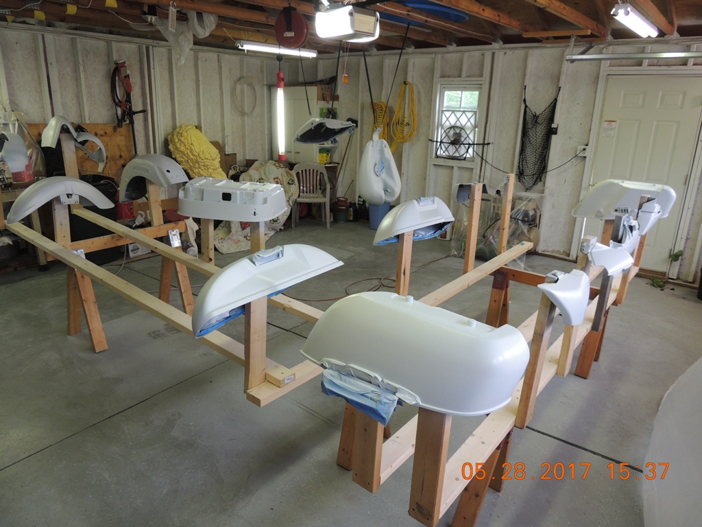

Primed and ready for paint.
Trying to figure out how large a photo I can post here. Here's the primed parts

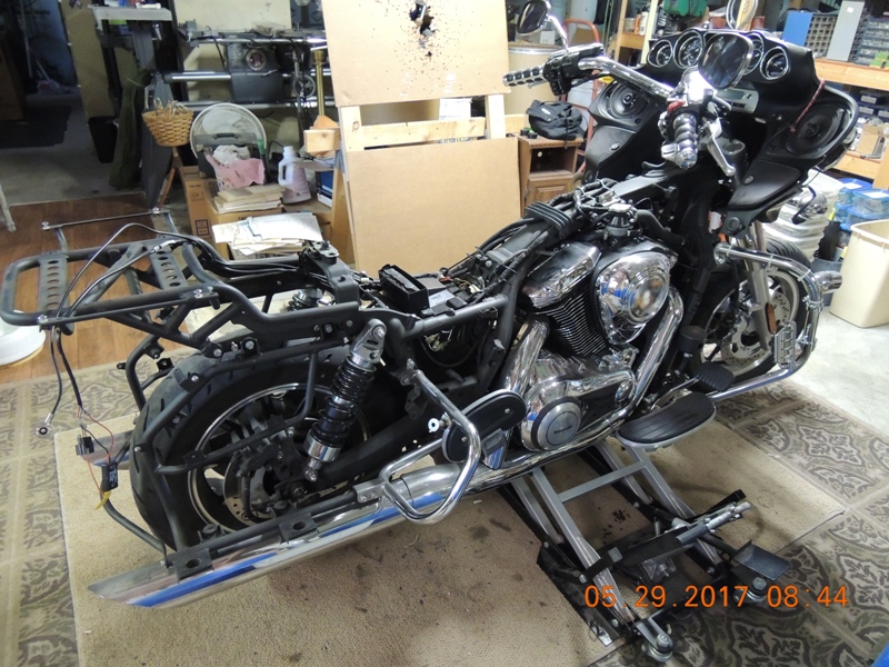

Ever seen a grown bike naked?!? (Another movie quote ... well almost.)
:oh:
All naked
All naked

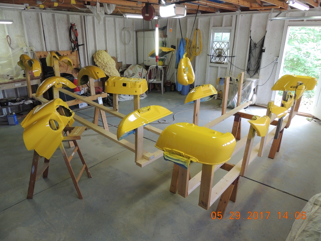

OK. The metal flake was a disaster. :tho: Even with the 2.0 spray tip, the flake kept clogging the gun, so, only a small amount for flake got onto the fuel tank. I scrapped the flake and strained the flake from the clear and just shot the rest of the parts with plain clear. :clap:
IT's VELOCITY YELLOW NOW! !
I'm just guessing that I've got one of the only yellow 1700's! Can't wait to put it back together now.
