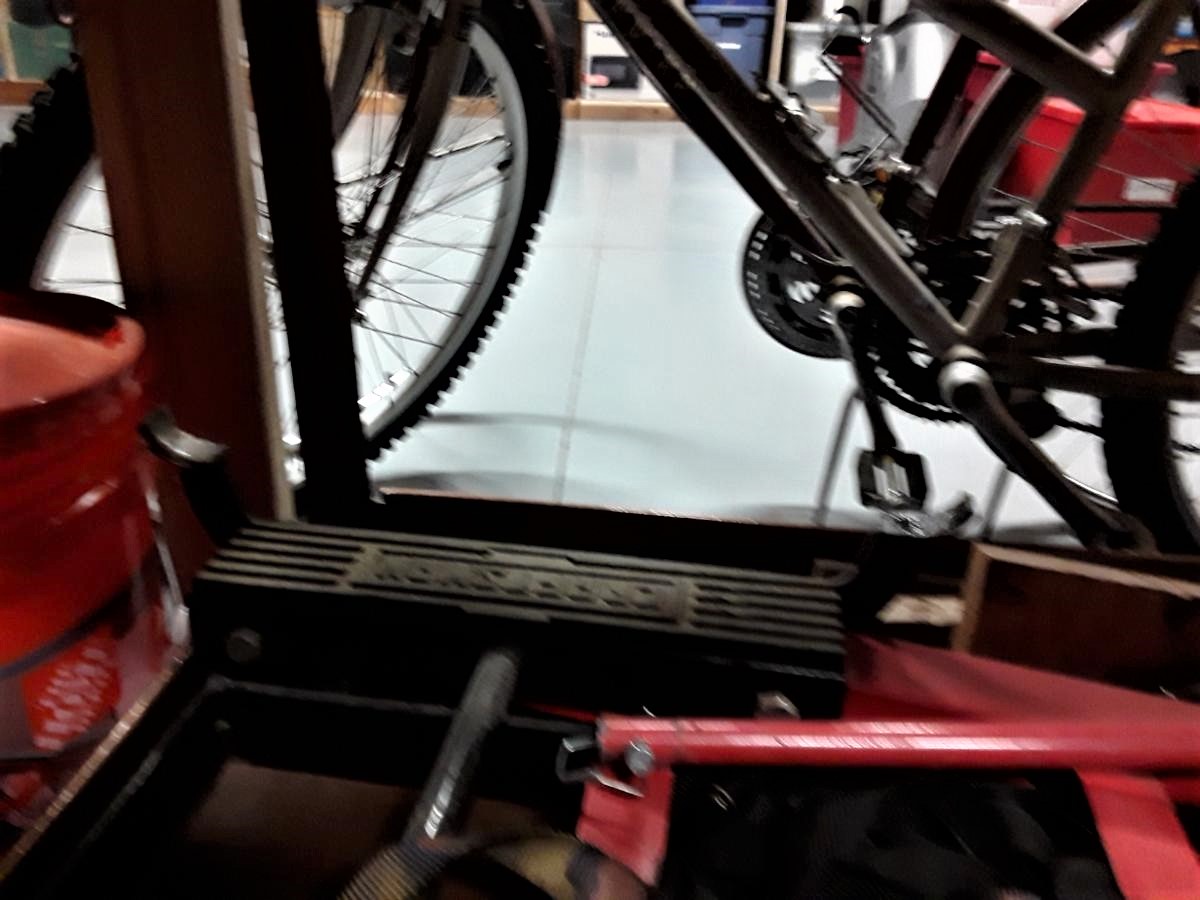

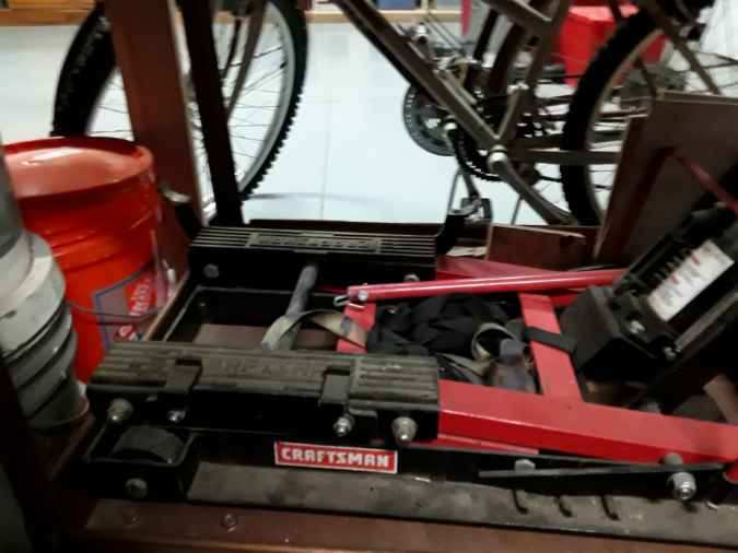

I've got an ATV jack/lift that I use with my KLR. I want to use it on the Voyager. Does anyone know where the center of weight is on the bike? If it's at the about 12" of frame rails I can make it work. If it balances further back it'd be somewhat harder to do, what with the exhaust and center stand in the way. Has anyone used this type of jack for the Voyager?
Also, when I try to use the center stand, and step on the 'go up' lever, the bike just 'rolls off' forward. What's the deal? I need a lesson or to fix it!
Thanks for all your good info.
Take care, RD

Thanks for replying! My lift is rated for 1500-lbs. The main reason I want to lift the bike is for changing tires and checking the function of the center stand. I don't want to go to the trouble of making an adapter for the lift if it's off balance picking up on the frame rails. I need to know where, front to back, is the balance point.
Thanks for your input! Take care, RD
