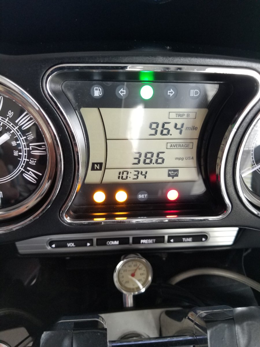

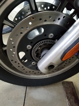

After looking at Partszilla parts catalog up to 2014 there were two models of Voyager 1700. One model was an non ABS model, the other model they list is an ABS model. As of 2015 the partsl catalog only list the Voyager 1700 ABS model.
I went out to the Garage and took two pictures of my Voyager 1700 front wheel showing the ABS ring on the wheel and another picture of the instrument panel, showing the ABS light on the lower left side of the picture, yep the bottom row of lights. My Voyager 1700 is an ABS model, This is a simple way to check for ABS. Yes I think that the ABS model is the only way to go.

Super! I have ABS! Thanks for digging into that for me! And thanks again for the suspension set up advice.
