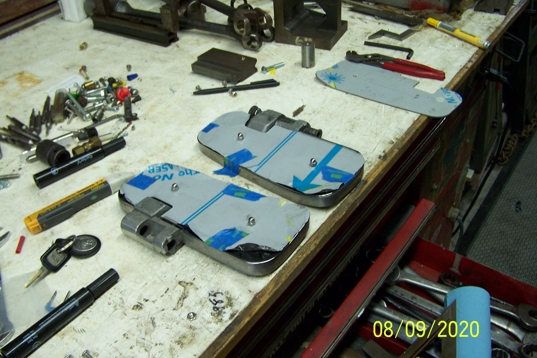

Hello from wind swept and rainy N.J. Seems there is never enough time , but here is a go at these brackets I had been trying to get to for a few years... Both blanks have been made and formed, this right side one is close to being finished and I hope to get both done tomorrow. Along with other items I need to get done and out the door. I'm almost hoping for a rain day to keep me in the shop....I have allot of finish work to be done..

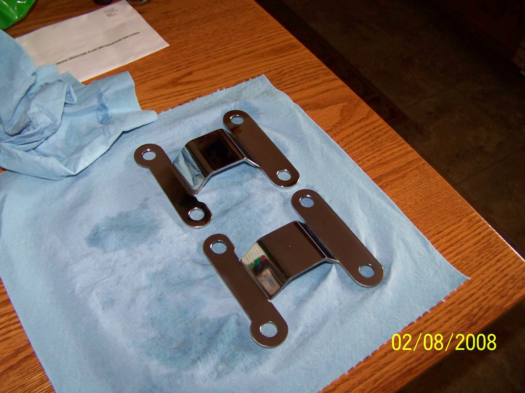

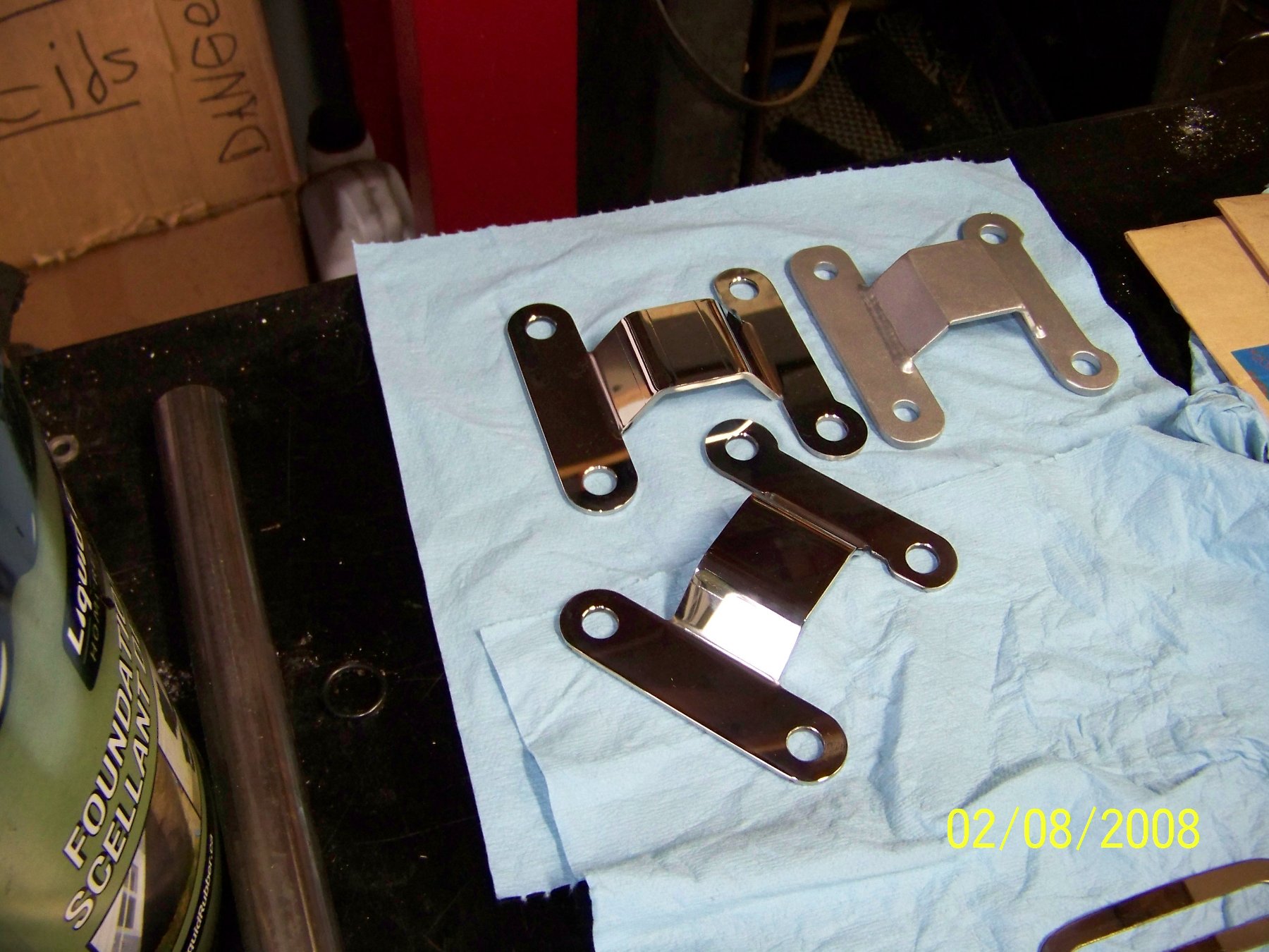

SANDING AND POLISHING, seems thats all I did yesterday. But thanks to DocSnowFox who inspired me to continue with this project , here they are. I had thought it would be an easy task , as I had a proto-type of one from another member. But it did not fit to my standards. Mine are made from stainless steel/ mirror polished to a #8 finish and edge smoothed and polished. It is 1/8 in thickness and require's one to replace the caliper bolts with ones at an extra 3mm longer.

A few more PIC's. Feels good to be back to my second job..
