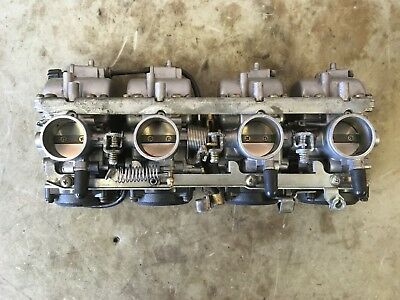

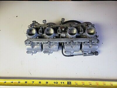

I understand completely and appreciate the reply. One question though, has anyone ever matched up the carbs from a Concours to the intake boots of a 1200? Just by eyeballing the spacing APPEARS nearly identical. If they do match that opens up options since IMO the 1200 with the oversquare bore/stroke has vast potential to be a sleeper.
Stock 1200 carbs 30 mm Concours 32 GPZ900 34 (not pictured)

Not that I know of. Would love to hear the outcome of your experiments, however. Cheers!

The Concours carbs don't have overflow vents. Hydro lock is a known and common problem with them - raw fuel gets into the cylinders. So if you do manage to get C10 carbs to fit and work, use the VXII fuel bowls.

I didn't notice the increase in bore size. XII carbs certainly are small, but that contributes to the bike's ridability. "Constant depression" carbs have a characteristic lag, waiting for increased air flow to raise the piston and thus increase the fuel flow. Small carbs have less lag, and so they give a better off-idle "chirp" response. I think this factors into how the XII has a lot of torque relative to the HP. (A racer's motto: "trade me torque for HP and I'll beat you every time.")
To take an example, Yamaha put two carbs on some single-cylinder thumpers. One is a conventional CD carb, rather small. The other is much simpler (no idle circuit) that only opens with big throttles, augmenting the small "primary" carb to supply the high volume needs. Although accursed (it's a bitch to jet), I like the way it performs ... especially in low RPM technical riding.
In short, the XII isn't designed to scream. I'd be interested to hear how the motor responds. I suspect the result might not be quite what you expect, such as cross-purposes with the stock cam profile or other high-flow limitations/compromises. Maybe you'll pursue transplanting the heads too?

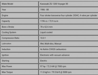

Yes the CV carbs can have issues, however I had a FJ1100 bored to 1314cc and everyone told me the stock carbs would be hell to tune but with the stage 3 Dynojet kit including lighter springs and drilled slides the carbs did fine, well enough to bury FZR1000 and ZX11. I'm a fan of big bore/short stroke engines because the vacuum signal is strong, the valves breath better (cylinder walls further away), and of course they rev quicker.
The intake ports will hinder max RPM power but my objective will be just as it was with the FJ: massive midrange.
ZG1200 specs
ZG1200 specs

Can someone provide a link to a repair manual .pdf so I can check internal engine specifications?

Not sure if it is pdf but if you go to AVA Home page-select Tech Center-select Voyager XII you will get Page 1 of 2 and on this page the 2nd window down will link you to multiple manuals.

It's in my .sig belowKawasaki Fan wrote: ↑Tue May 25, 2021 10:48 pm Can someone provide a link to a repair manual .pdf so I can check internal engine specifications?
