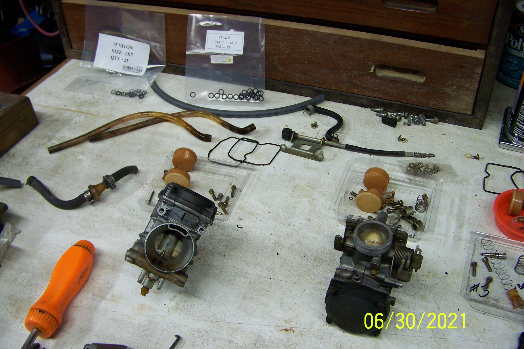

Well all my side work is paying off... just purchased a 1.5 gal. capacity ultrasonic for doing nice carb work. I have been wanting one ever since I heard about them. Been getting bikes to repair that have sat for YEARS.... One on the lift has a need for some carb care....O-rings just fall apart and are not cheep. But here a bit of info, McMaster Carr does carry a nice supply of various o-rings at a very nice cost.. Purchased the 3mm orings for our oil filters in a pac of 10 for less than the cost of 2 anywhere else.

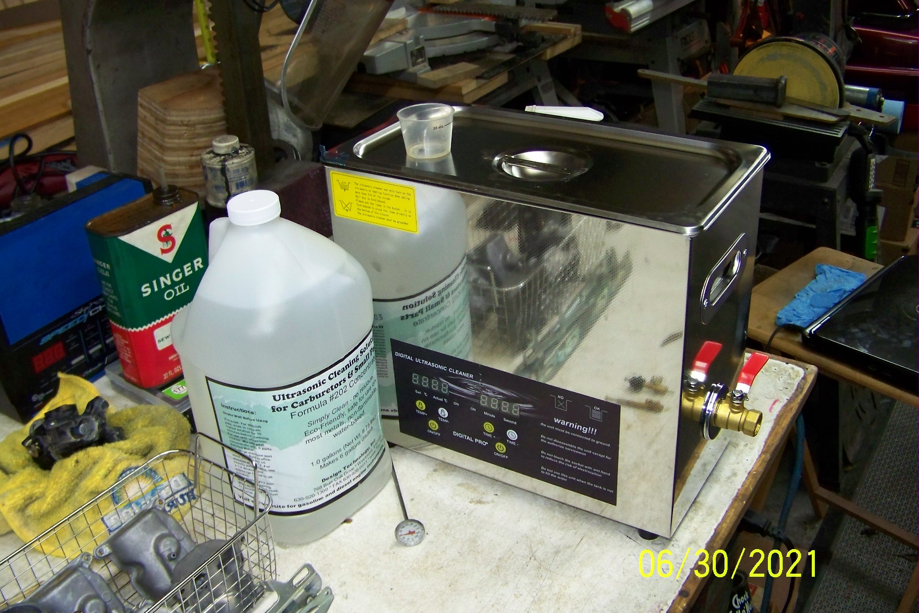

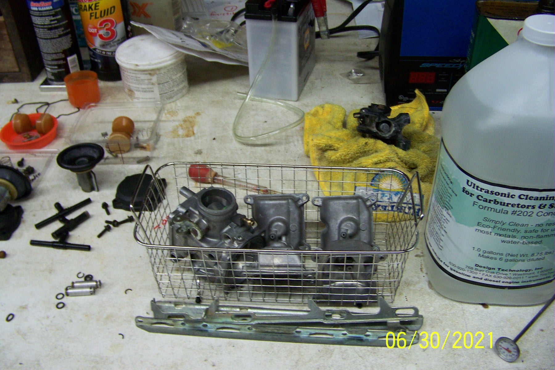

Re: ULTRASONIC CLEANER
Hello from NJ, the inside dimensions of the basket are 10" X 5" X 5" OR 250 X 125 X 125.... I used both heat and freq. and 32mL of the cleaner shown in the pic- FORMULA 202, for carbs and small parts. I let the heater bring it up to 70-C for about 5 min. and with one carb and four bowl in the basket , let it fun for 20 min. I did have to rinse them first before I pulled all the small parts from the body, as the carbs sat dry for nine years. Blew dry and after 15 min I shut it down and rinsed with hot tap water and blew dry then just lightly sprayed with WD.
The water for the tank has to be de-ionized or de-mineralized. If you don't have a reverse osmosis treatment for tap water a gallon can cost over 10.00 USD. The cleaner was around 66.00 USD and the unit was 137.00 USD.
It is the higher freq. unit, and it is an import. I researched several US models and the cost was triple and not in my cost-range at this time.
For being a first time user other than small jewelry units, I am very,very pleased with the results. I noticed at the schedule of time and cleaner used , no visible pitting was noticed.
As for the plastic parts, I am holding out until I have a 1200 I have been trying to build , at the least have all the parts I need to complete it
Hope this was helpful, Gene Kap

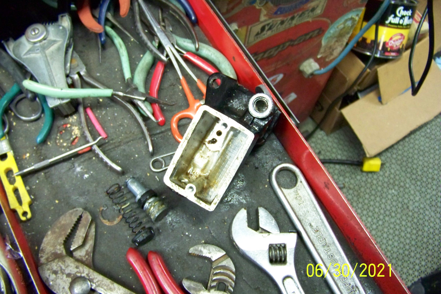

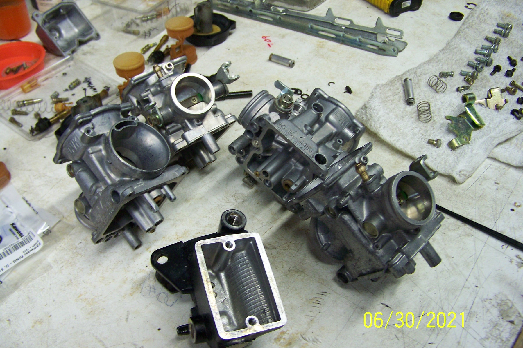

Hello again from NJ, used 28 mL of cleaner on the remaining 3carbs and set for 40 min. The heater "I discovered " only comes on when the unit is run/timed. 28ml was much less aggressive but a little more time. Temp a 60C was about 125deg. What a time saver and well worth it , "If ya do allot of work".. Here are some more pics.
I mixed a light mix and done the front master cyl.
what a time saver.
Gene Kap

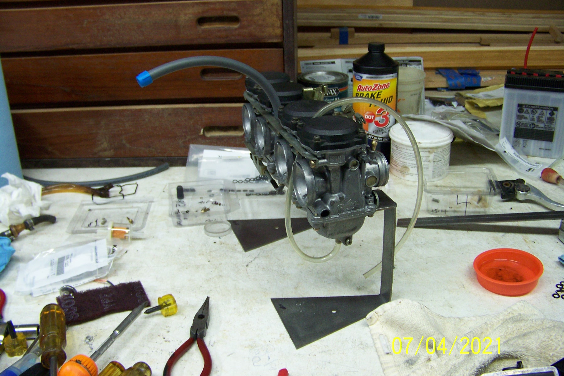

Well I know how ya'll like pic's, so here are the carbs ready to be tested for fuel level. Made these stands up to make the job of holding them , right side up or upside down. Still waiting on the o-rings for the pilot screws , one was missing the washer also. Also still awaiting brake parts. Both masters were gunked/varnished / foul looking and just plain ugly. Past few bikes have also been that way.
Anyways, the cleaner tank was a very good investment .
Gene
