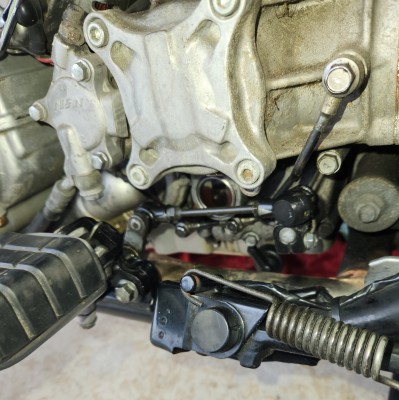

I wanted to put the factory foot pegs on and noticed when i removed the heel to toe shifter/floorboard, that the linkage ball to the rear of the linkage was touching the exhaust. So for the factory shift arm i changed the orientation to be on top side instead of down to by the exhaust. Everything looks and feels good but i have a problem with it.
With engine running and in N. i tried to put it in 1st but it seemed to only be partially wanting to go. Tried to go up to 2nd gear and it's like it is not getting enough travel to fully engage the gears.
Anyone had this type of encounters and what did you do to solve it? I do see that the connecting arm between the ball joints has some adjustments.
I've tried to attach a picture, not sure if it worked.

IIRC there's a blurb in the Service Manual about shift linkage adjustment and orientation (or is it orientation and adjustment? It's 3:30 am). Link to the manual is in my .sig below

I just took a look, myself, and didn't see anything in the Service Manual, however the exploded parts diagram might help you. It's called the "gear change mechanism"

If one reads the driver's floorboard installation sheet, found at the Accessories heading on the Voyager XII Tech Center page located on the AVA Home page, there is a note there regarding how the shift linkage is reversed when installing the floorboards.
This note details how both "the bell cranks are reversed 180 degrees for proper shift operation. When installing floorboards, the front points up as shown and the rear points down".
So, when one goes from floorboards to pegs the reverse would be the case for the linkage orientation: front down and rear up.

yeah, thanks i have 2 hard copies of the manuals, one from years ago when i had a 93 model and now another manual i received when i bought this 96 bike. Also have the manual pdf version. But looking at manuals does show the linkage with (what i call the arms) pointed up and the linkage on the top going horizontal across. I also so the floorboards description telling to do a 180 with the factory linkage. Which would be putting the linkage arms pointing down and alot closer to the exhaust area.GrandpaDenny wrote: ↑Tue Sep 17, 2024 7:36 am I just took a look, myself, and didn't see anything in the Service Manual, however the exploded parts diagram might help you. It's called the "gear change mechanism"
Later on today i will take another look at it. Thanks for the input.

I saw this and now i will be working to get the shift lever back off, it was a pain to get on the linkage shaft. My question on this is the accuracy of the up and down. are we talking about 12 and 3 oclock? (then the front would be 6 and 12 oclock? for the factory style.) My linkage also has some play in the ball joints but still useable. Thanks for your help on this. By the way how do i include a picture with my writings?triton28 wrote: ↑Tue Sep 17, 2024 10:36 am If one reads the driver's floorboard installation sheet, found at the Accessories heading on the Voyager XII Tech Center page located on the AVA Home page, there is a note there regarding how the shift linkage is reversed when installing the floorboards.

Problem solved with the Linkage concern. I had it right the first time i put it back together. Just like the manual shows it, the linkage is up in a horizontal manner. both the foot lever arm that connect to the rod going back to the other ball joint, and the ball joint at the shaft, point up.
Here is where i was making my mistake. When checking to see if it would go in gear, i started the motor, its in Neutral, then i put it in 1st gear, and back to Neutral. But when i tried to go up to 2nd gear it would not. Problem solved: IT WILL NOT GO INTO 2ND GEAR IF IT IS NOT ROLLING. So i took it for a drive and it changed gears just fine. Thanks to everyone for the input and hopefully this will help someone later down the road.

Ah yes, the Kawasaki Positive Neutral Finder System. When it's cold out, you may find that it won't go into 2nd gear until abot 3200 rpm. This disappears as the bike warms up.
