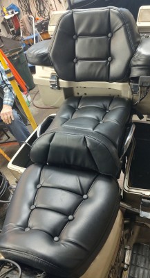

Seat covers arrived today, look like a very close match to original and material seems good quality. I tried my old faithful Bostich staple gun but no go on the hard plastic bases so tomorrow I'll try with my mates air stapler and jack up the pressure!

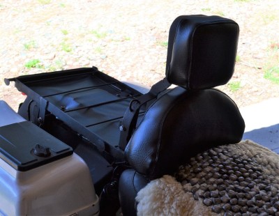

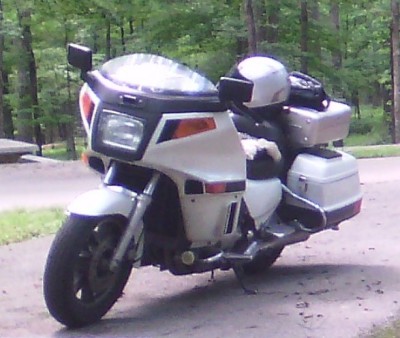

I rolled my own, and it turned out exactly what I wanted -- okay, after cutting and re-welding the backrest supports a half-dozen times. The backrest snugs up to my lower back for a perfect reach to the bars. (These days, I use an AirHawk rather than the sheepskin.)

Bike looks very nice Nails.
I like the contrast between the white and the black.

Thanks, but in the flesh it's a bit rough. However, I don't see most of that when I'm riding it.

Ahem yes well stapling into 37 year old plastic wasn't the easiest of jobs and the air stapler we had didn't cut it, or rather did cut it (the material that is) as the staples that fit this gun were only 1/8" across the bridge and looked like they could tear (or were tearing) the fabric. So we ditched it and went with small (1/2") self tapping screws instead. The screws had a low profile Philips head with a sort of built in "washer" that formed a 3/8" seat to secure the fabric. Worked great, but definitely a 2 person job. On the main saddle, we added another strip of vinyl between the screws and the fabric just to give it a bit more strength.
In the few places where the screw points might compromise or poke through the material, we added another plastic backing plate to reduce the depth of the screw.
The buttoning was also a bit of a challenge, I tried tying the loop and slipping it over the tit on the back of the seat base, but that was a no go, very difficult getting the right tension also getting them all evenly squished. After I broke one button string stretching it over the retainer, we ditched the cords and substituted some strong thin wire -and- after getting the right depth/tension on the button we put in a screw right next to the tit and did a couple of wraps around the screw before tightening it down.
Larry
