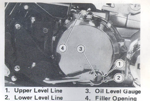

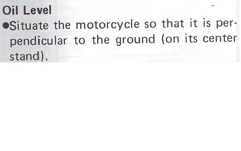

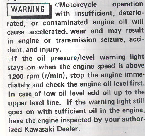

Re: Oil Leak
Yes I have to agree that this is vary hard to follow not enough information
this is where a support ticket would come in to play if the information that is filled in is correct.
This bike on a complete oil change only hold 6.6 quarts, without changing filter it will take 5.9 quarts so 3/4 of a quart is figured in just for the filter.
These images are right out of the kz1300 owners manual.
click on images for a better view
It holds Was the oil light on when checking oil did you
And then do this When you say dial just what do you mean

Re: Oil Leak
I am assuming you are checking this by the oil level light .
DON'T .The sensor will get dirty and will go on even if you are not low .
Use the sight glass and make sure you are not overfilling . On the side stand I fill until just below the full mark .
If on the centerstand filling to the add mark will make it appear overfilled when dropped to the side stand .

First of all, these are the ZN1300, not the KZ1300, and they are quite different in their engines as far as the sump is concerned. A lot of KZ owners swap their sumps for the ZN sumps for added capacity. The clutches are different, too, and the oil sight glass is on the left side of the engine on the ZN1300 rather than shown in the pic as on the right side, as the KZ1300 is.

Me Again made an EXCELLENT point about not using the oil light to determine if oil is needed! NEVER, NEVER , NEVER believe that light!!!! It will frequently tell you that the oil is low when it isn't! The sight glass is the only true indicator to use!
As has been said before, all that oil under your bike is from over-filling if you have been using the light to tell you when you need oil!
