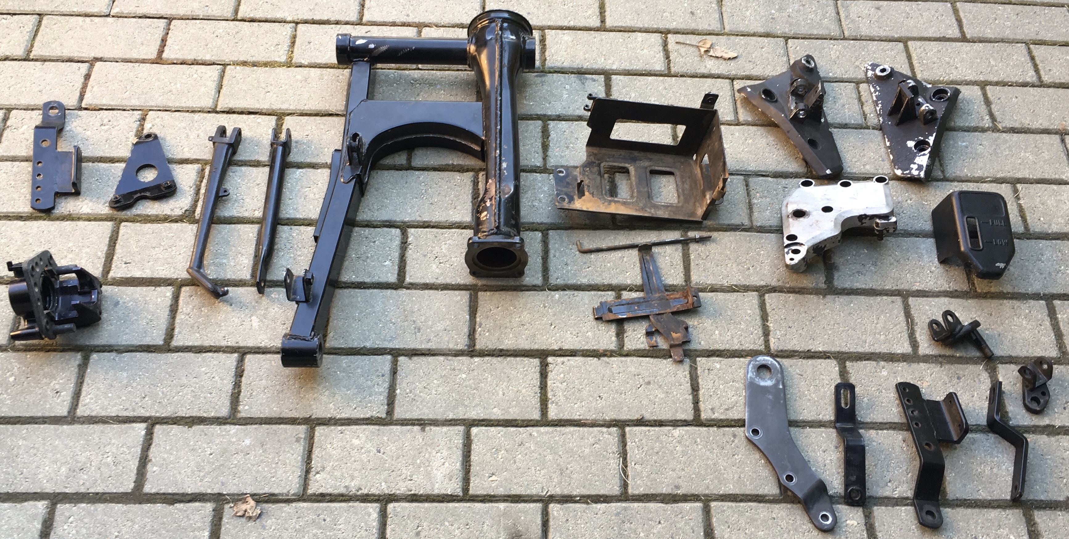

I finally got around to pulling and refinishing the peg brackets - left and right rears and the right front bracket. It's no wonder the paint flaked off easily - the quality of the aluminum casting is very poor and quite rough. I spent a bit of time wire wheeling off the original finish (not convinced it was original) then had to use some paint stripper to get the more stubborn and unreachable bits. Ideally, I would have liked to have them powder-coated but didn't have time for that. I opted to paint with several coast of primer then several coast of gloss black case paint -which I baked. I would have preferred a semi gloss black - thought I had some but coudn't find it so had to go with the gloss that I had. The result looks much better than what I started with (apologies that I didn't take before/after photos) but I'm not under any illusions that the finish will be very durable. One of these days I'm going to get my own powder coating setup in place - until then, paint will have to do.
It's weird how a small bit of flaking paint distracted so much from the look of the entire bike for me - probably no one else would ever notice.

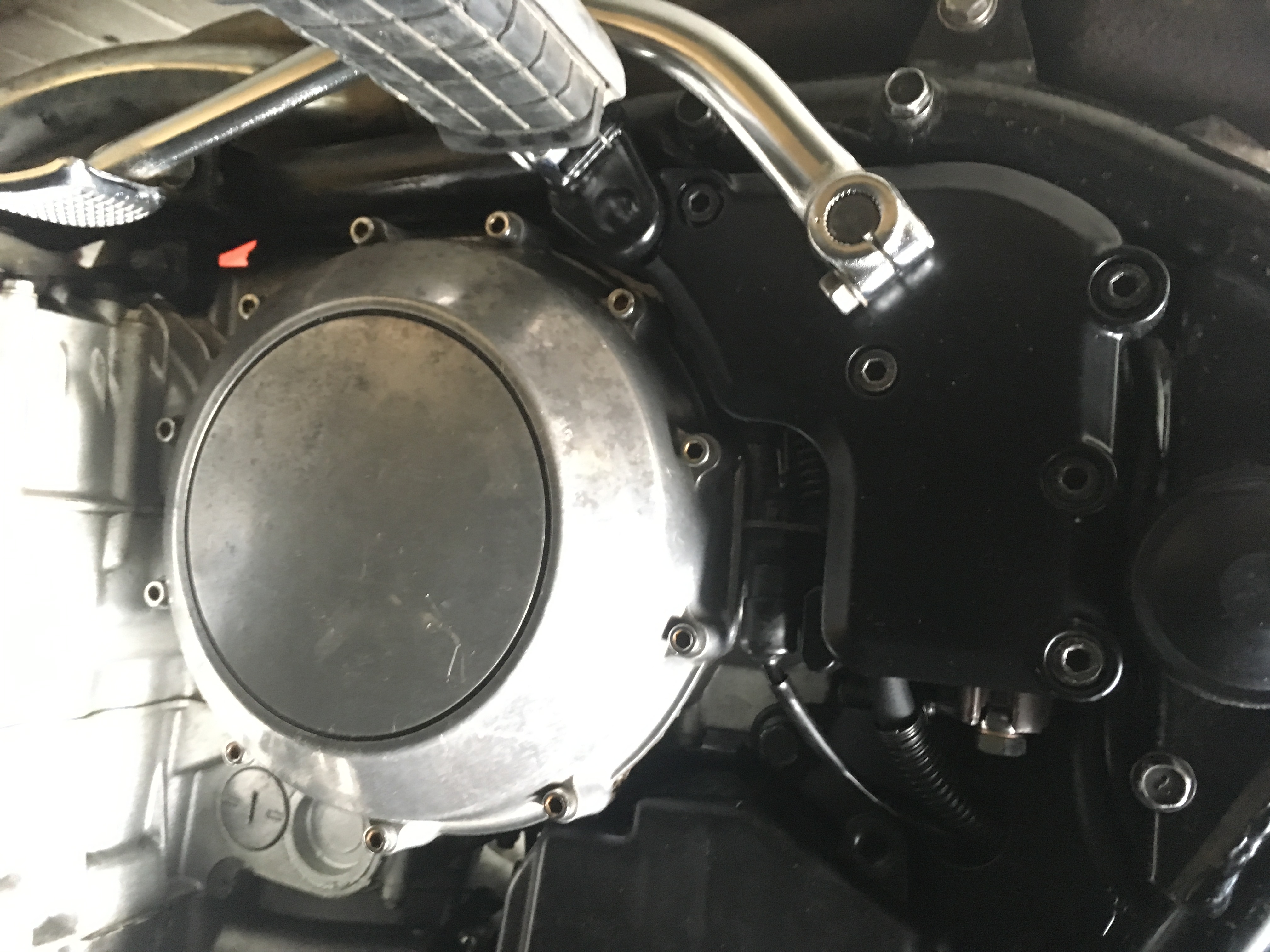

I agree, don’t like to see flaking paint. I powder coated mine and some other parts. It’s important even if it’s only me noticing it :-)

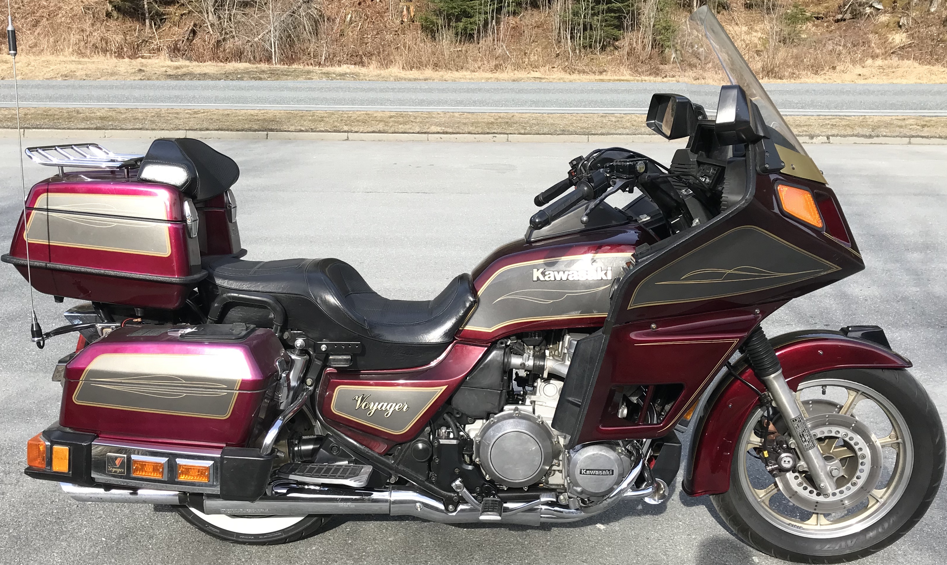

Sweet! The bike looks familiar (same colour as mine
Your bits look a bit more of a semi-gloss finish which is what I would have preferred.
