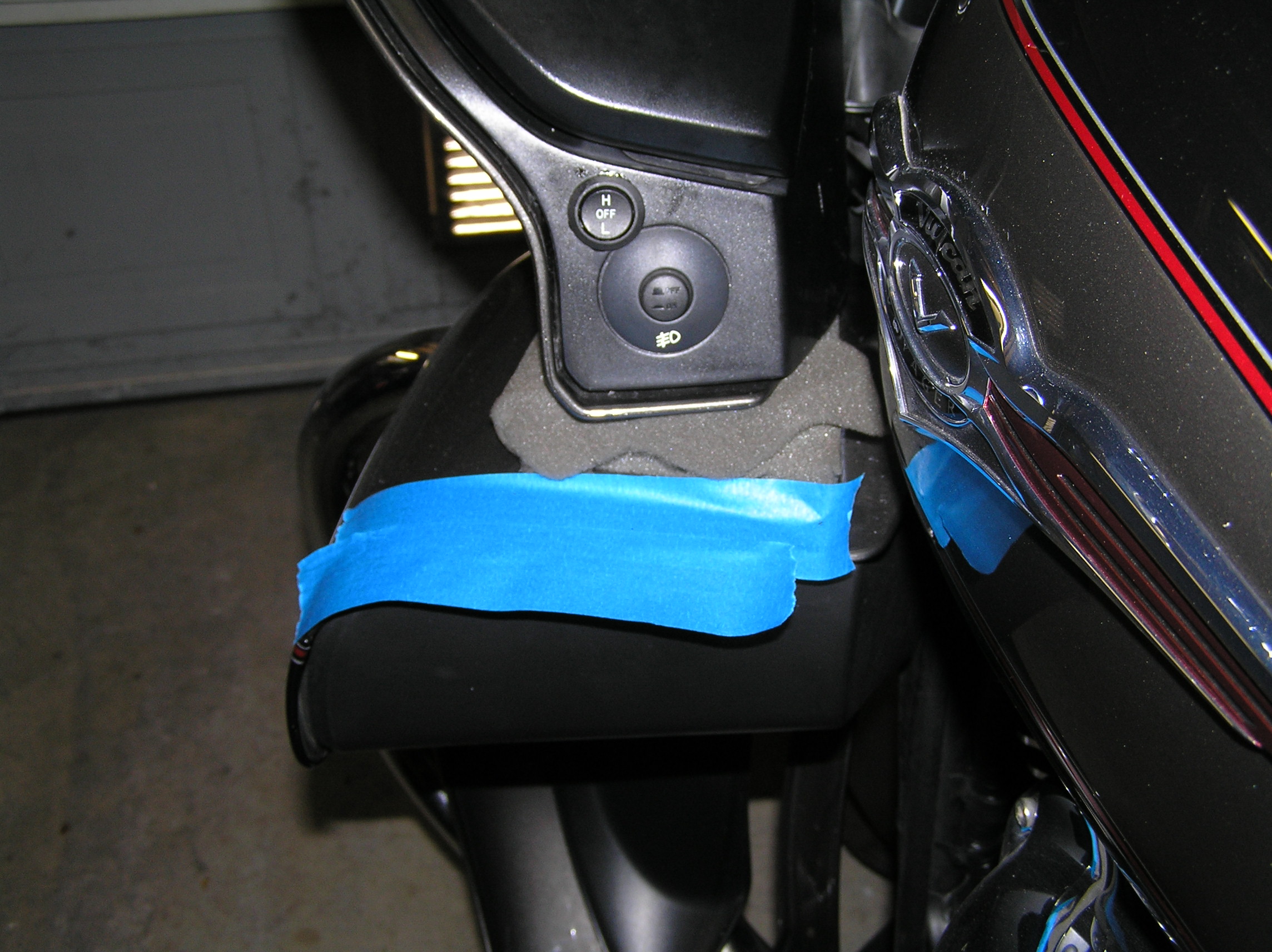

The gap between the upper and lower fairing I've seen different ways of solving this problem and I didn't care for any of them. So here is what I did, I found some foam from an electronic box. I cut out a piece of foam and stuffed it in between the upper and lower fairing. I've refined the foam since this picture. I now have it so that it's snug against the fuel tank (keep water and cold air from my knees). The part of the foam that is between the fairings is angled so that the when air flows around it, it flows out away from my knees. What is nice is that when entering a bike show I can remove the foam, I carry sandwich bags to store the foam in my saddle bags.
This picture was taken in 2012
