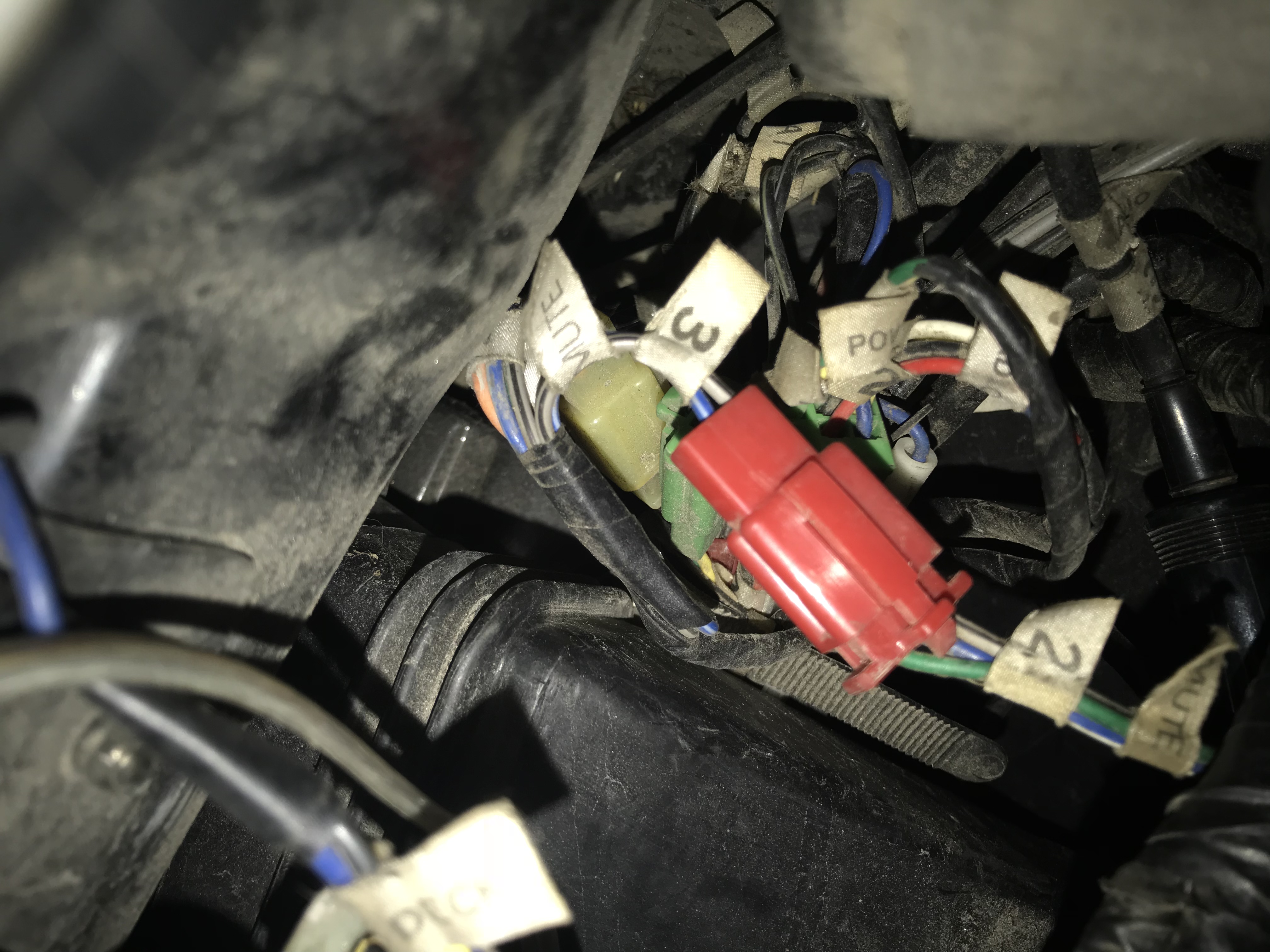

Unrelated to my problem but I noticed that the 'mute' wiring harness connection (red 3 pin, two wire, flat connector) was labelled with a ''Mute" and a "3" while it's mating connector was labelled with a "Mute" and "2". Does anyone have a Voyager AM/FM receiver sitting on the shelf and could check the label number on that red connector?

Will this help?

jorgeno wrote:Will this help?
Yes, 3 going to 2 - same as mine! Thanks for checking. Somebody goofed!
