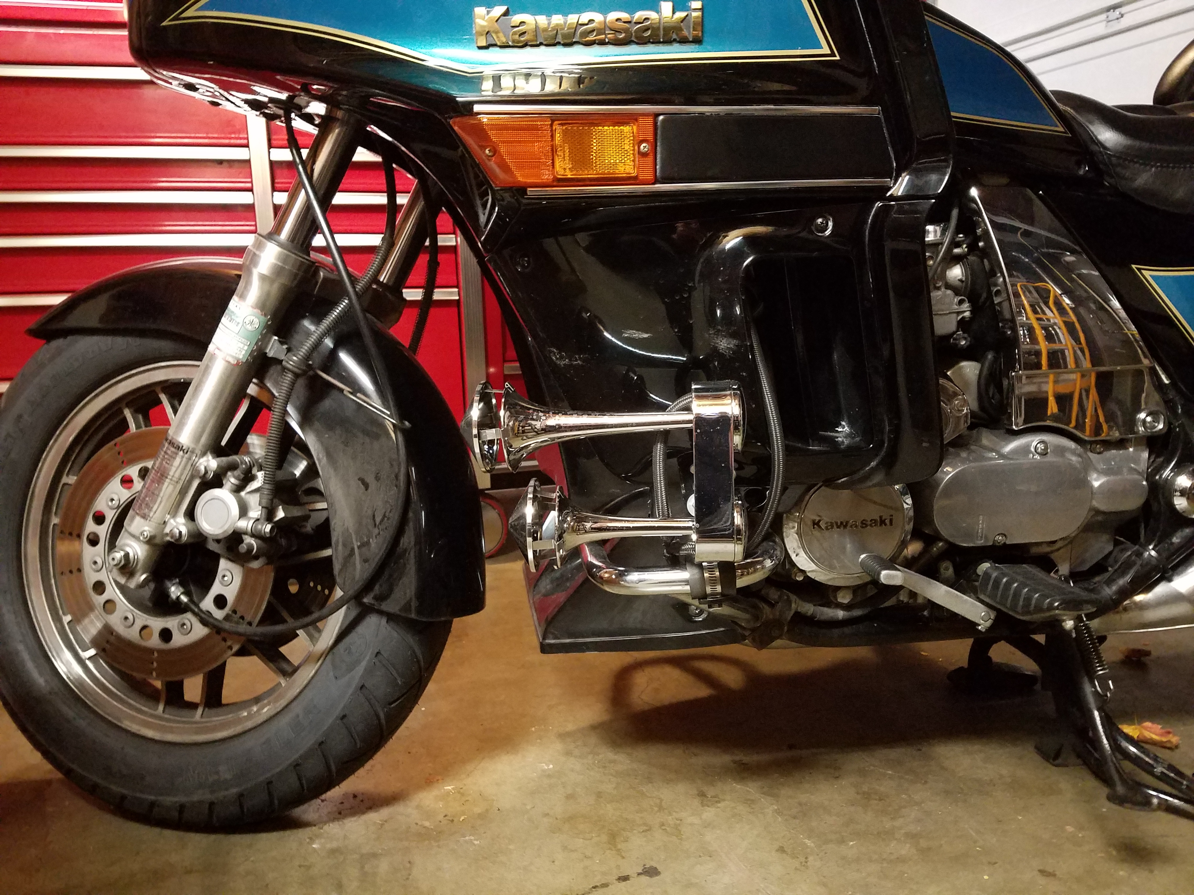

After a lot of thought, I figured there's really only a few places I could realistically mount the horns:
- Under the headlight. Problem is, if I bottom the forks the front fender will hit them, hard. And I ride hard. I'd also have to make a custom bracket.
- On one of the lowers. That would mean drilling holes in a lower, and bolting the horns to the plastic. The horns only have a single mounting hole (at the rear), and weigh ~1.5 pounds. I figured such a mount would probably break the lower, sooner or later.
- Along the lower side of the fairing, on the trim piece to the rear of the running light. I thought of putting a small metal plate on the inside and outside of the fairing (to stiffen and support the fairing plastic around the mounting hole), and driling through the outer plate, trim piece, fairing, and inner plate. This would probably work, and probably last.
- On the front fender. That raised a host of issues, so I didn't really consider it.
- On an engine guard/crash bar. Though not an elegant solution, I could use the bracket provided, and it would be easy.

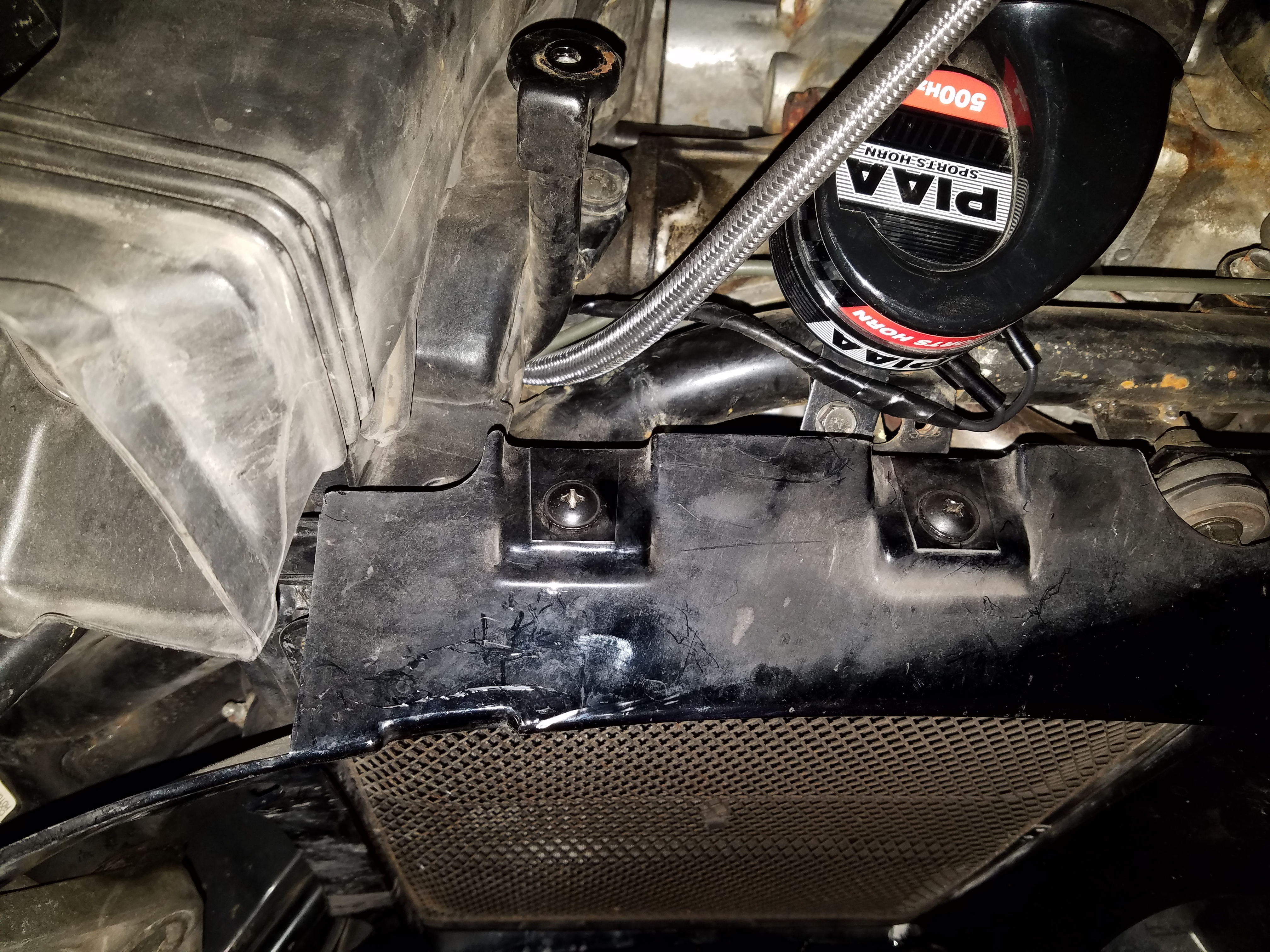

This is what I did. I put a piece of rubber cut from an old inner tube inside the hose clamp/bracket, to both prevent scatching the chrome on the engine guard, and minimize the vibration transferred to the horn assembly. It worked, and doesn't widen the bike's profile much, but it's not ideal. Someday I'll make a custom bracket.

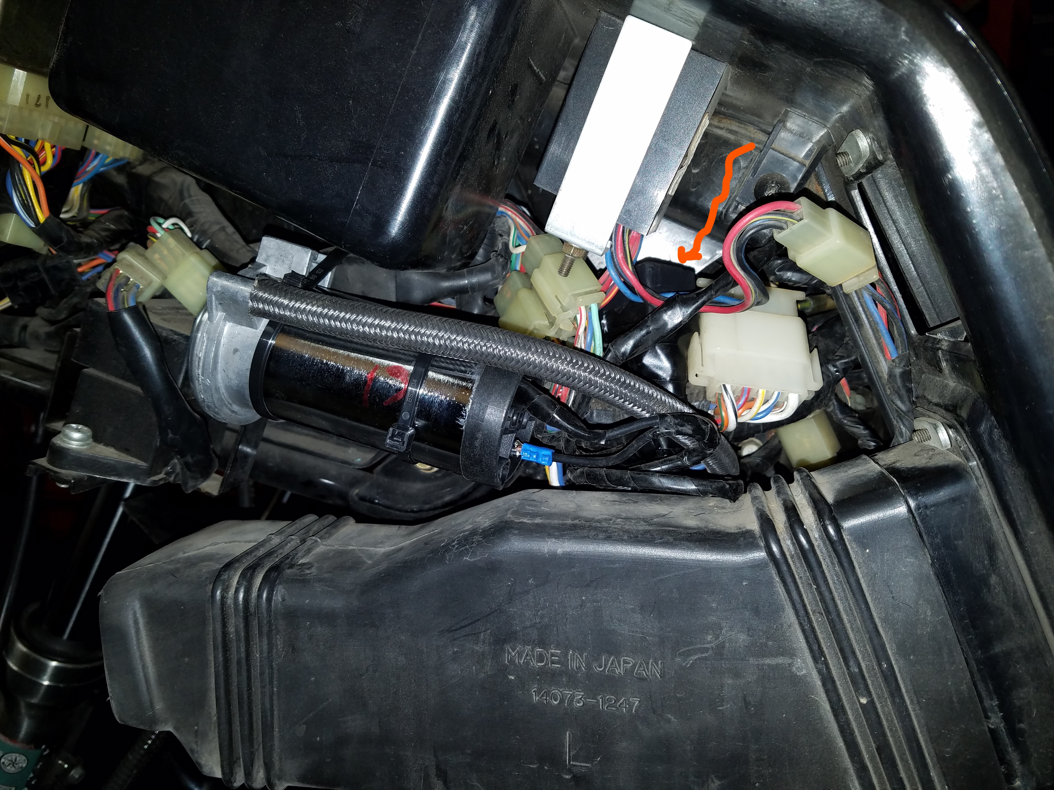

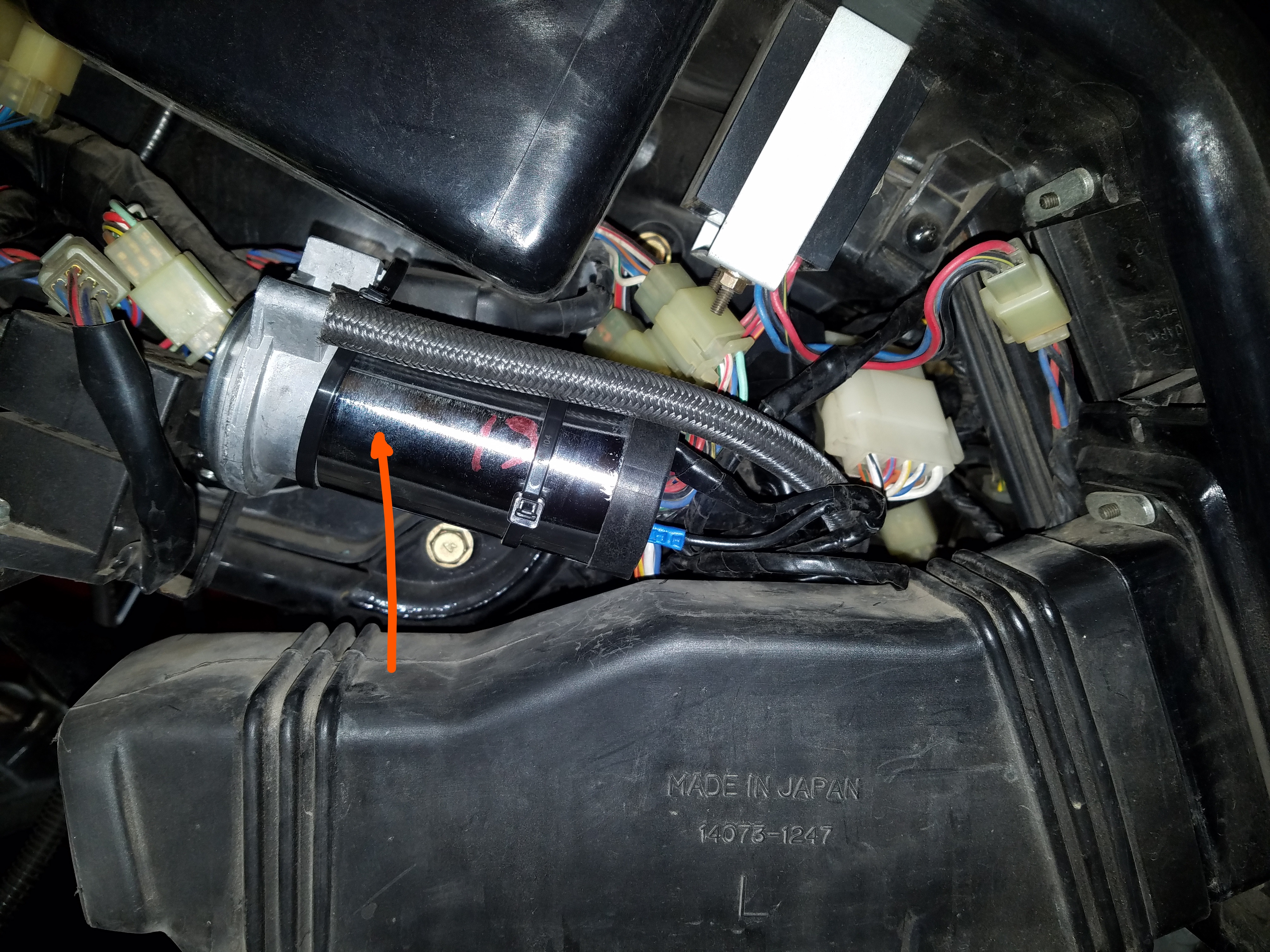

The next issue was where to mount the compressor. Air horns mostly fail because the compressor dies. They don't like heat, and they really don't like vibration, wet, etc.
After a lot of looking for a suitable location, I settled on mounting it inside the left fairing, just above the lower vent air duct. I zip tied it (not tightly) to the large wiring harnesses just under the fairing top. I took some finagling, and disconnecting/rerouting/reconnecting several of the connectors, but it actually fits almost perfectly in that spot, and isn't going anywhere. Since it's only zip tied to wiring harnesses, it won''t be getting any vibration. Inside the faring, I wouldn't expect it to see any water (or anything else). It is fairly close to the cylinder head, so it might get hot in stop-and-go driving in the summer. We'll see how it holds up.
The wiring is simple if you know what you're doing. Take the time to tape up the wires and use connectors, not bare wires, and you won't have any issues. The relay is tucked into a spot just blow the fairing top, just in front of the front/rear fader.
I read a lot of stories of air horns failing silently (you don't know it died till you try to use it). To mitigate that, I ran the compressor in parallel with the existing electric horns. This way they also sound when I hit the button. Now if the compressor dies, the electric horns will still function. (If you disconnect them, or run them in series with the compressor, they won''t).
All told, I spent a solid two days on this. 2/3 of that was figuring out where to put the horns and compressor; most of the rest was doing the wiring. (I'm picky about wiring).
I have some pictures, which I'll try to post here.

just a followup.
i installed the air horns in Nov '18. It's now 8/24 and they still work fine, six years later, and have never failed me.
In SoCal I used to ride all the time. But since then I've moved a couple times, ending up in Bellevuew, WA - where it's drizzly (at least) about a third of the year. Point is I haven't been riding nearly as much as I used to.
Also I test the horns briefly almost every time I ride, 'cuz air horns silently fail. (Pun intended).
So far I've had zero issues with them.
- Eric
