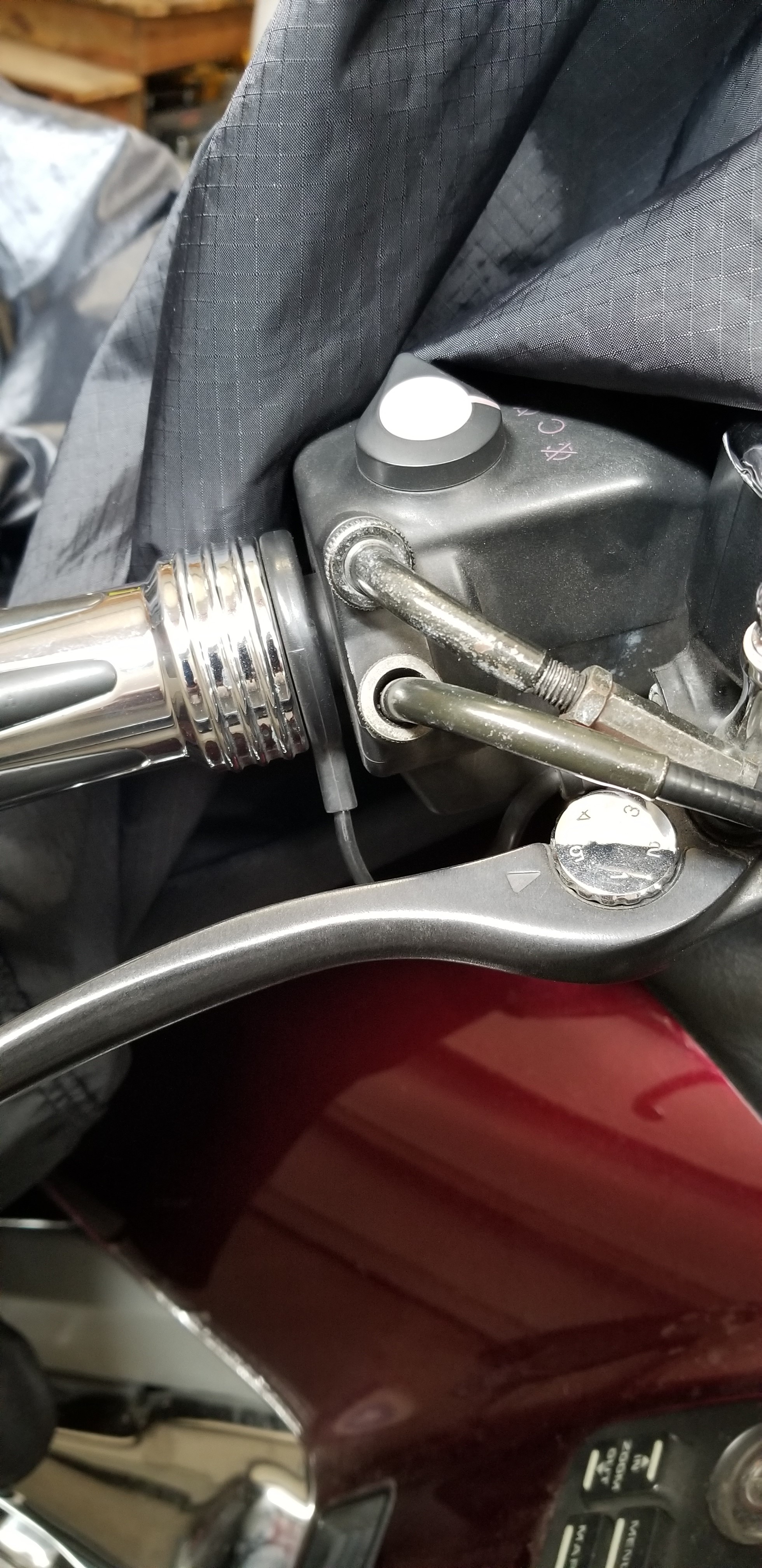

Show Chrome heated grips, clutch side on Goldwing

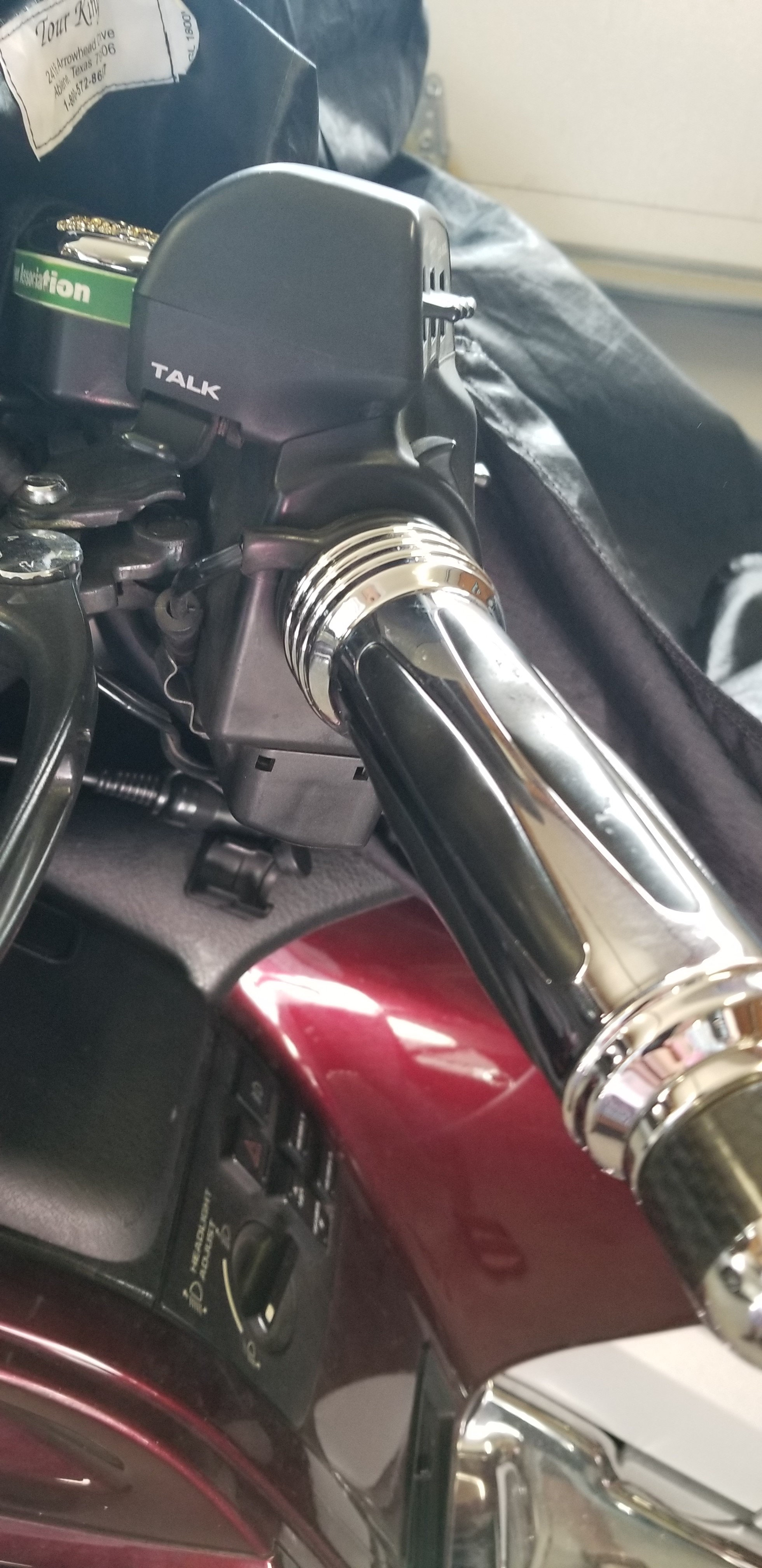

Show Chrome heated grips, throttle side on Goldwing

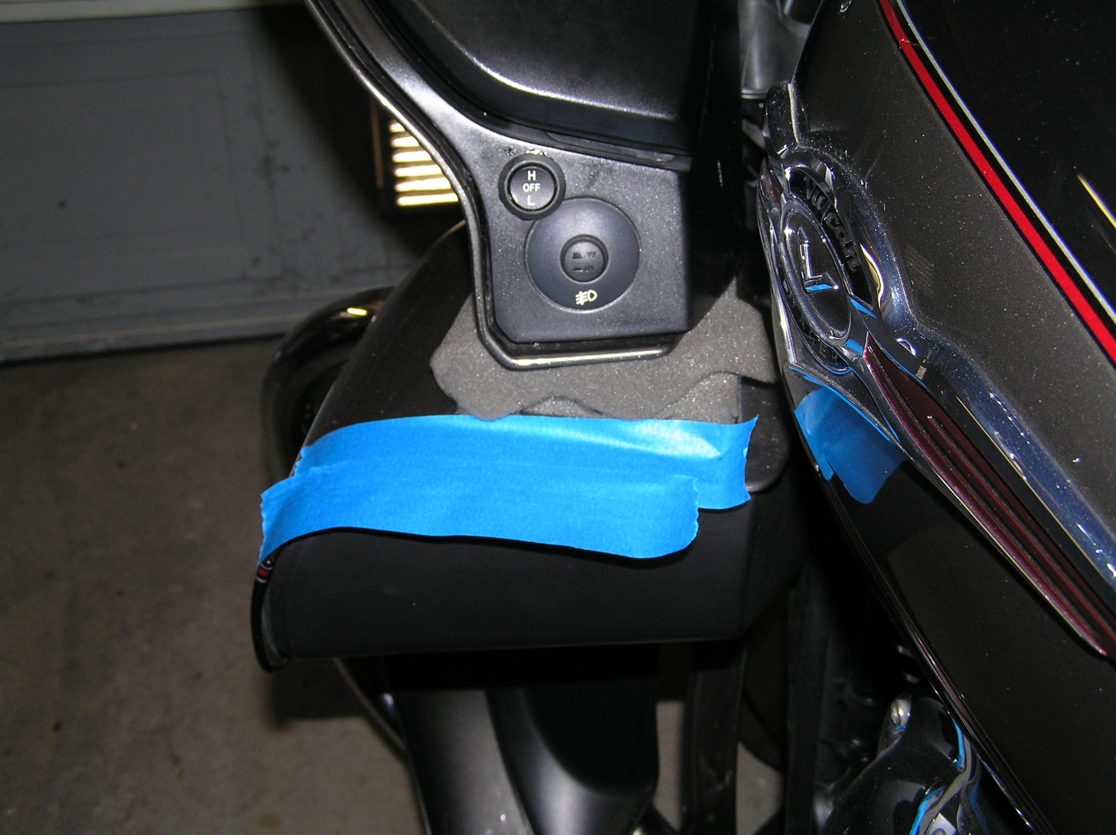

This is the Lo/off/High heat switch on my Voyager 1700, I did have to make a custom wiring harness
