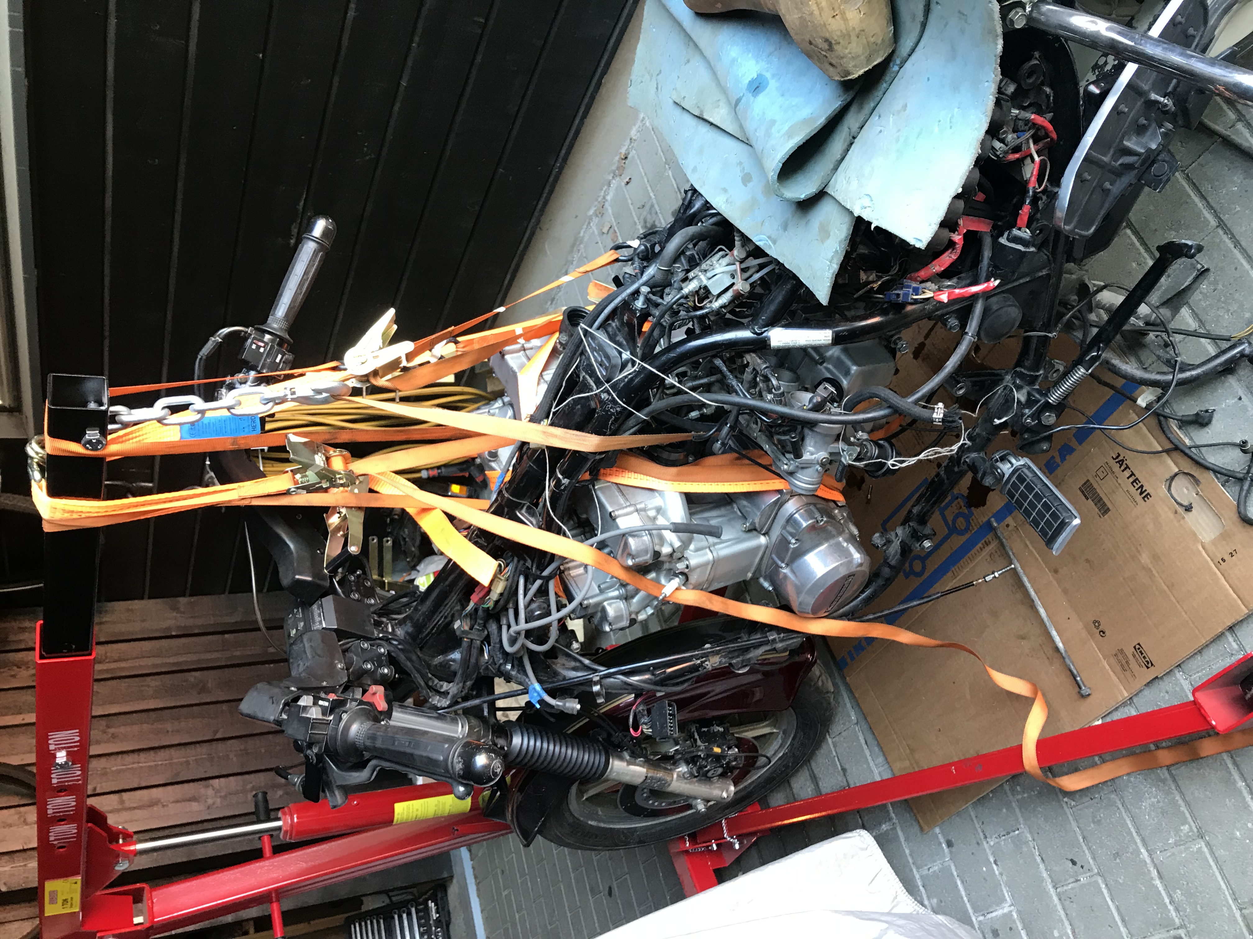

Decided to take out the engine. Need to replace cam chain, cam idler sprocket and take a look at the transmission. Have already ordered a Liska gear and a lots of parts. Cylinder head and block will be delivered to a machine shop. This is my progress so far:

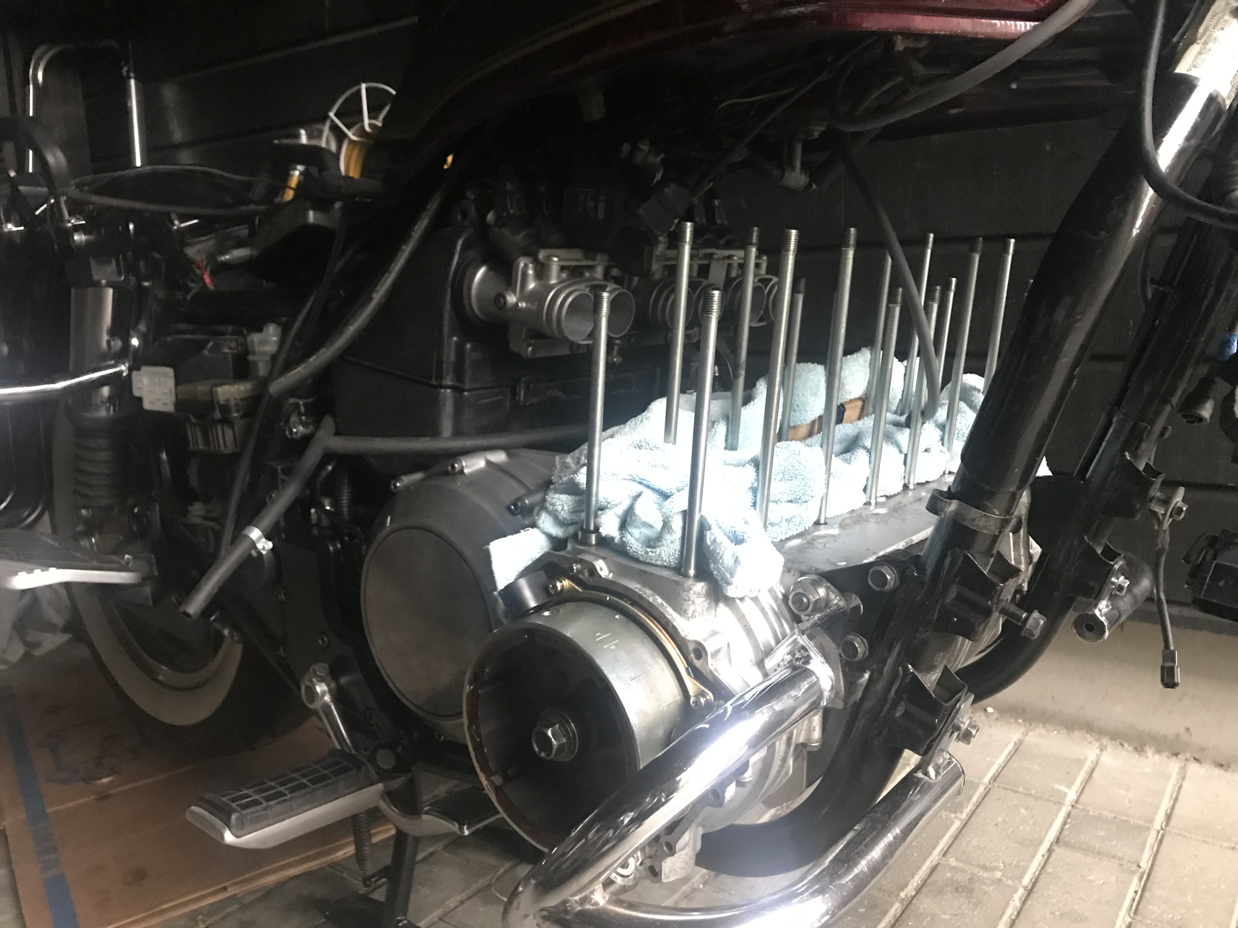

Re: Engine rebuild

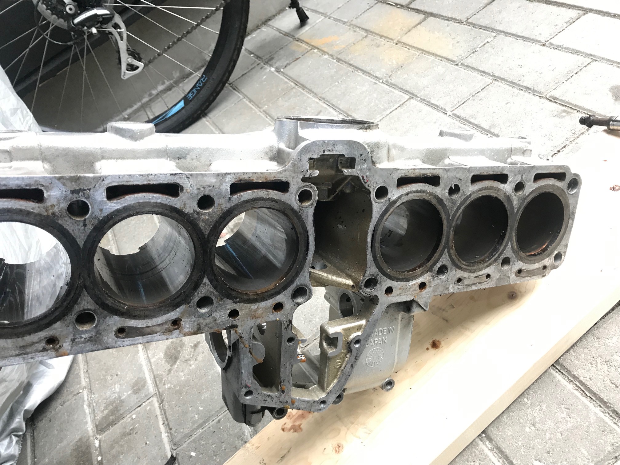

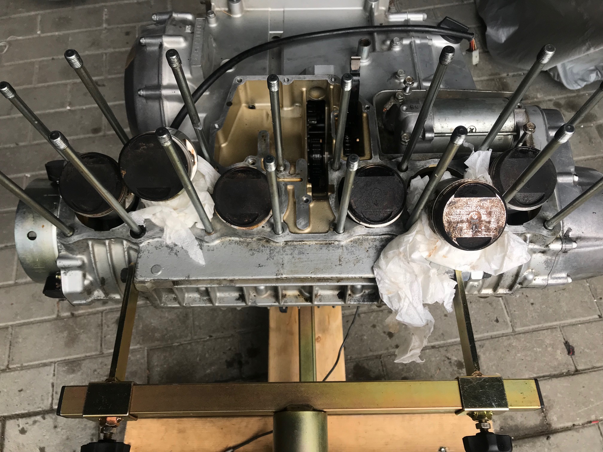

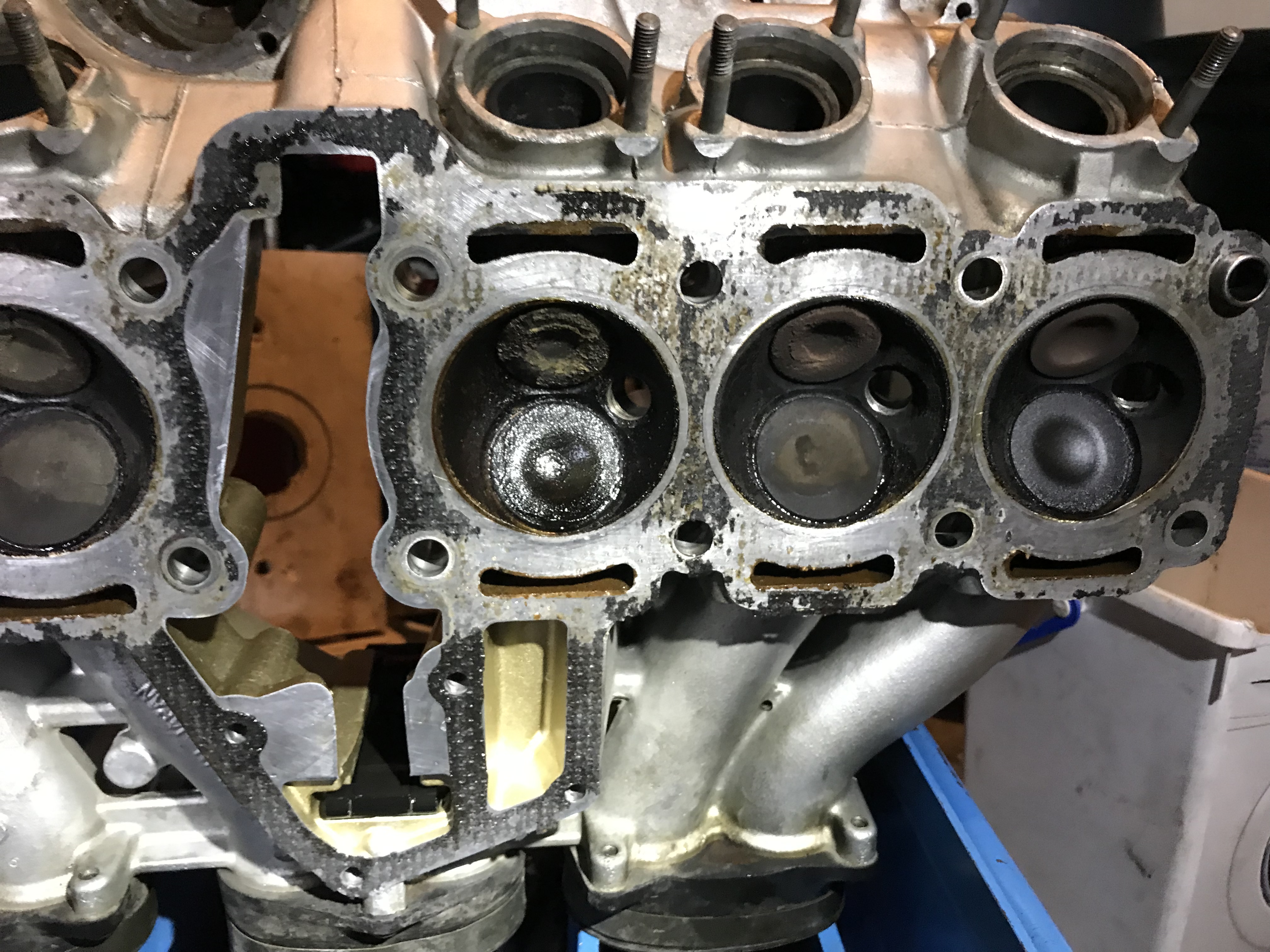

Got some progress today. Off with the cylinder head.
Then out with the water pump. The mechanical seal must be replaced.
The cylinder block doesn't look too bad
Soon ready to split the crankcase (never done that before)
Thanks cushman eagle, I need to do it on my GS as well.

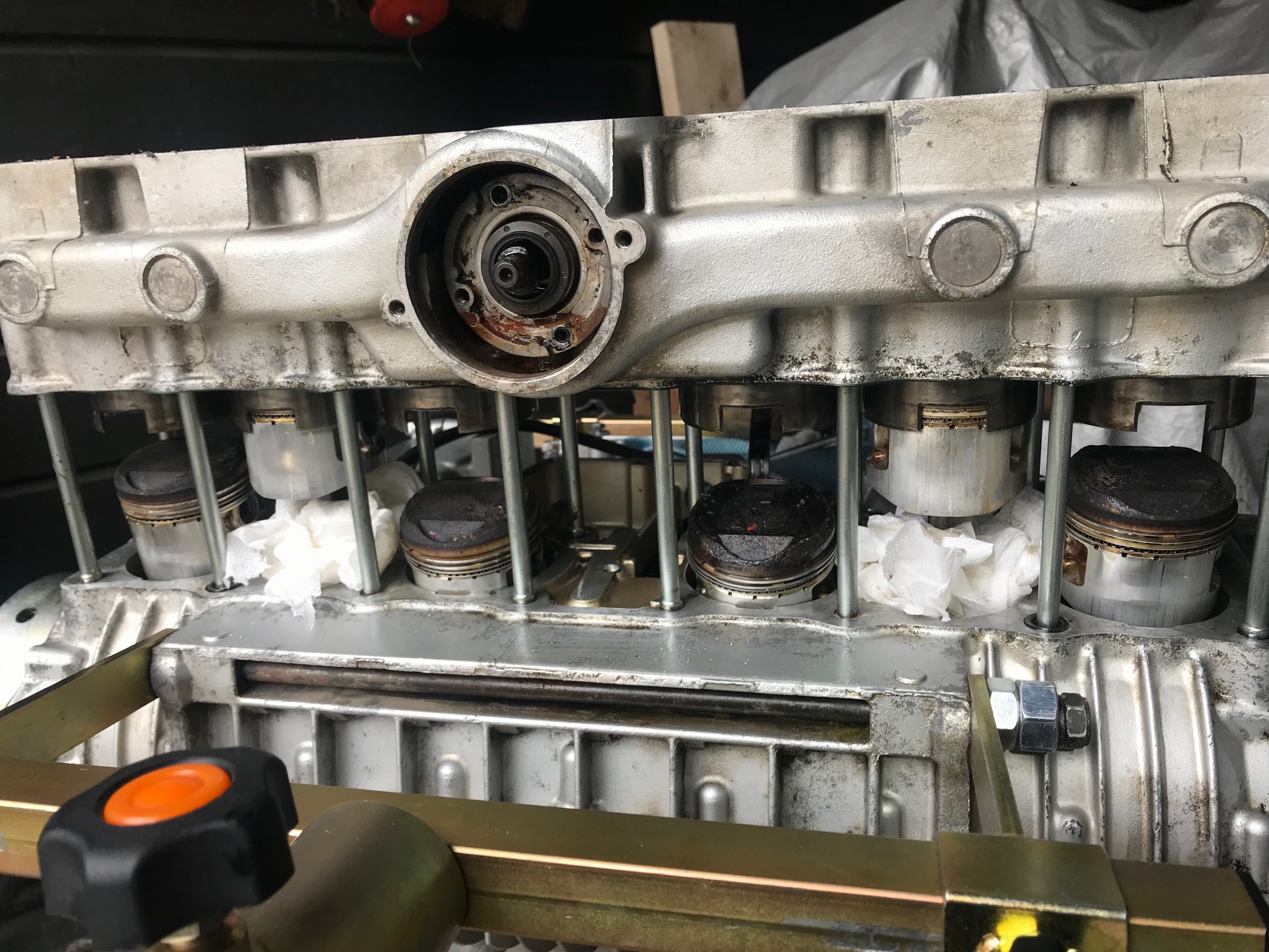

Re: Engine rebuild

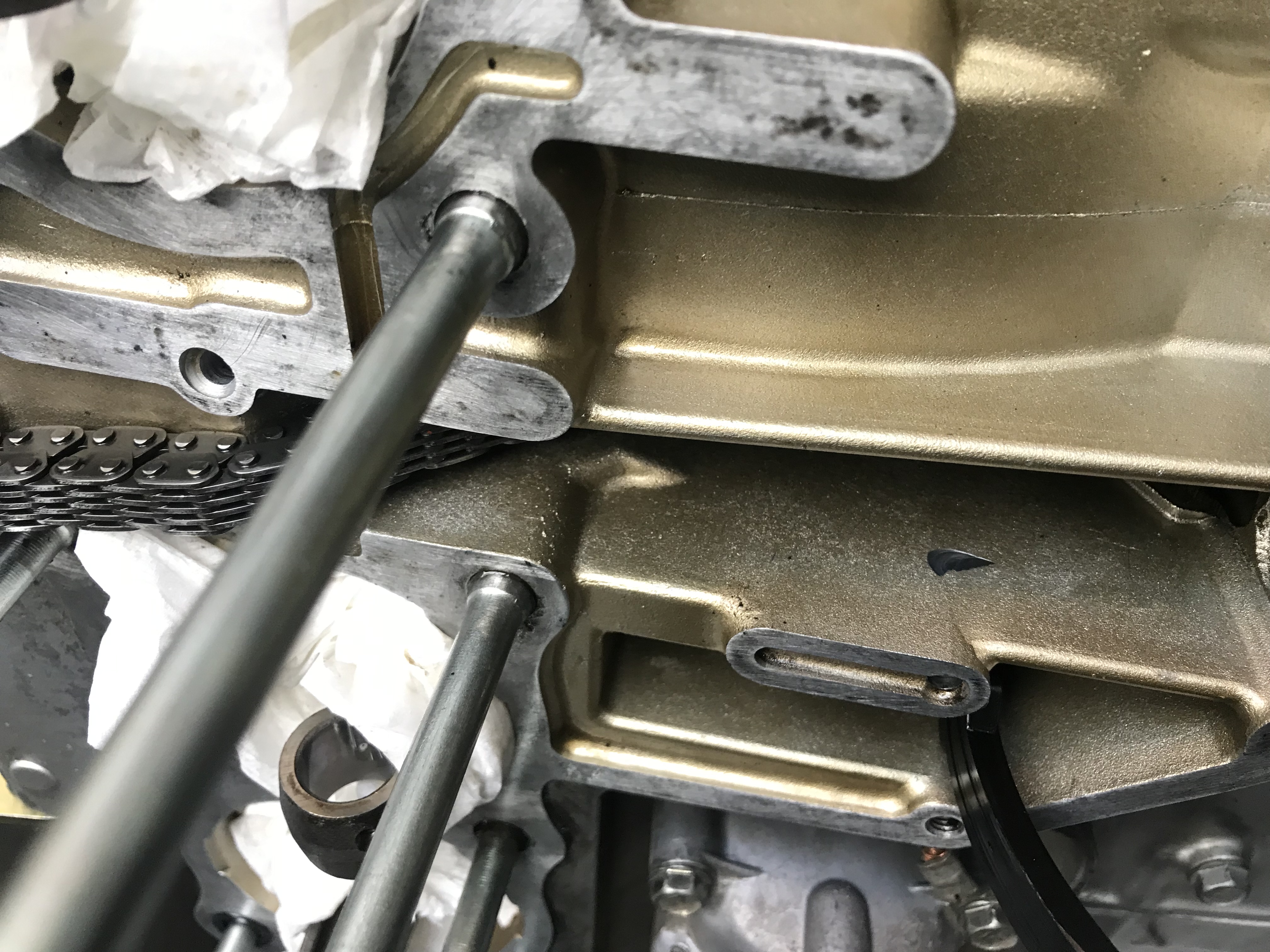

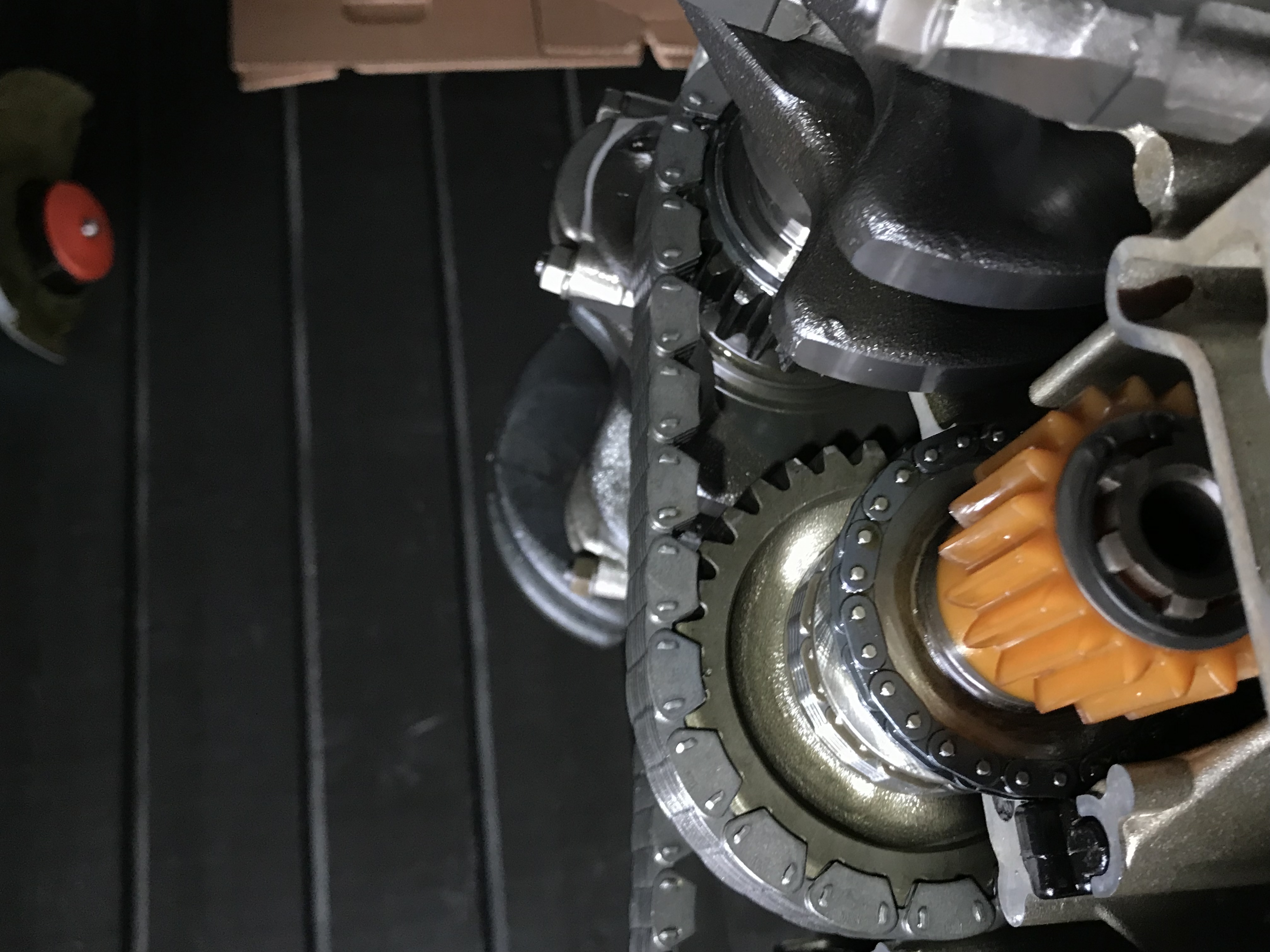

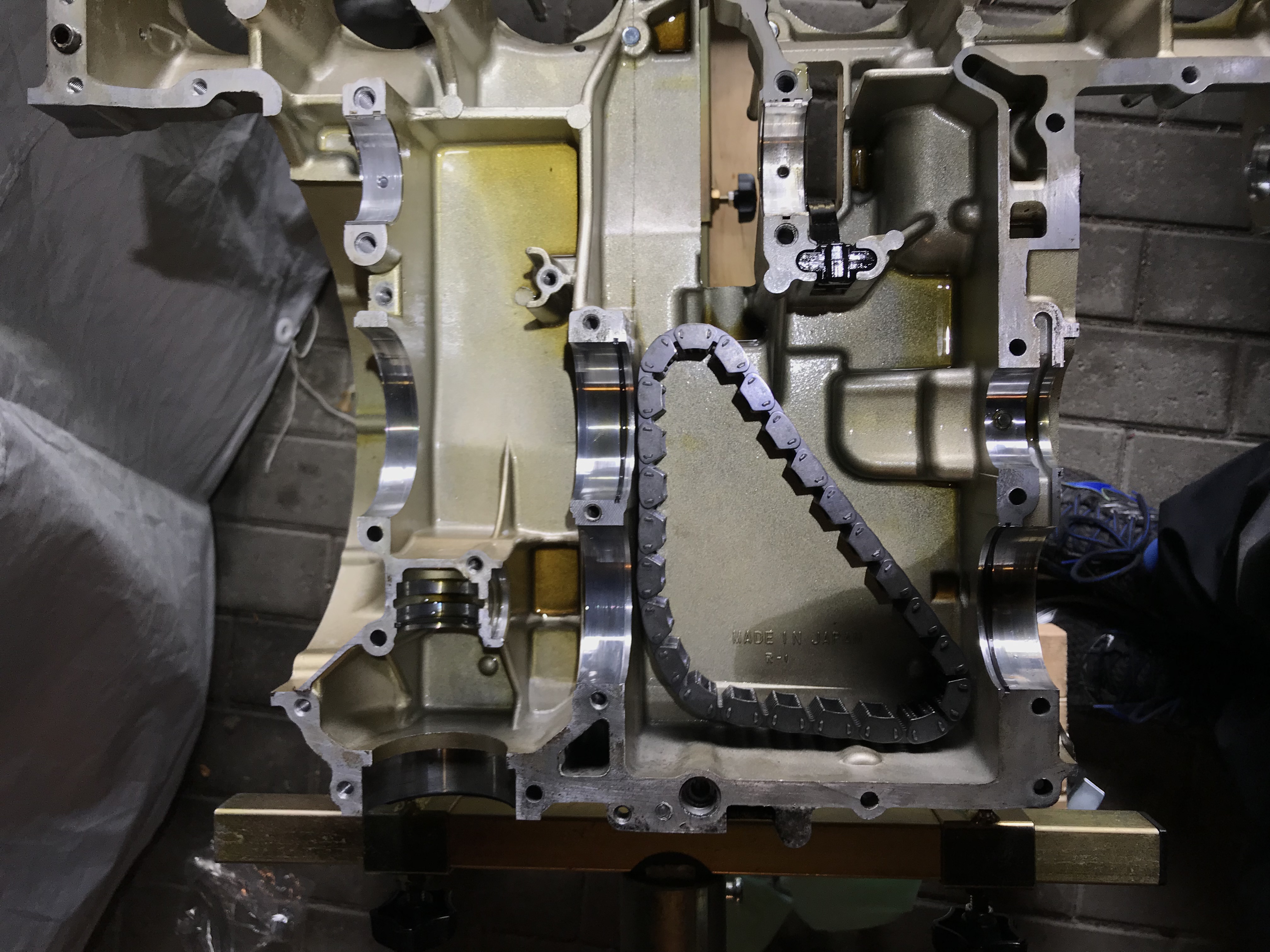

I’m a bit surprised to see this mark at the crank case. I think it’s from the idler gear cam chain, probably because of too much slack.

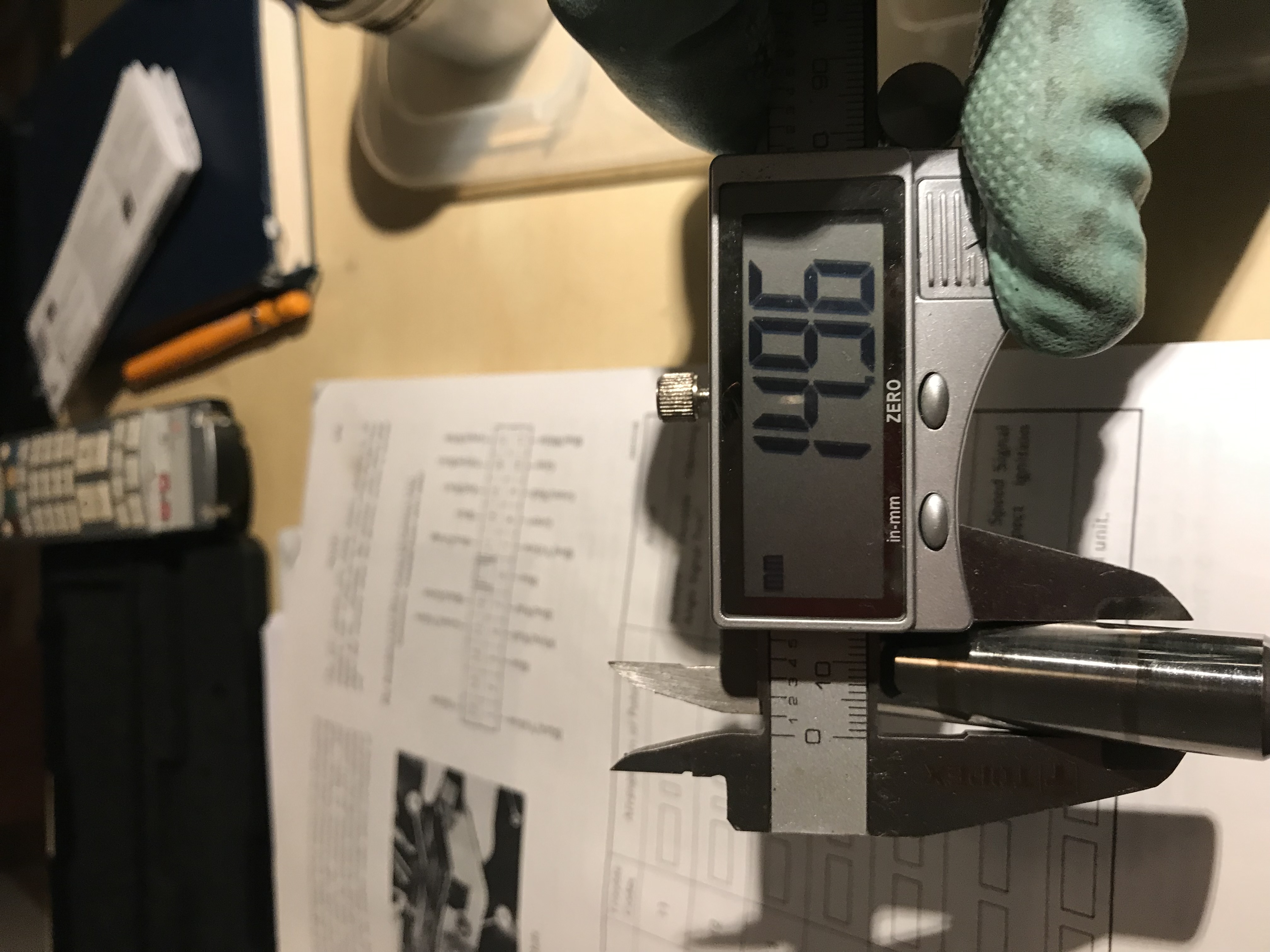

I have measured the cam shafts, both are below service limit. How critical is that?

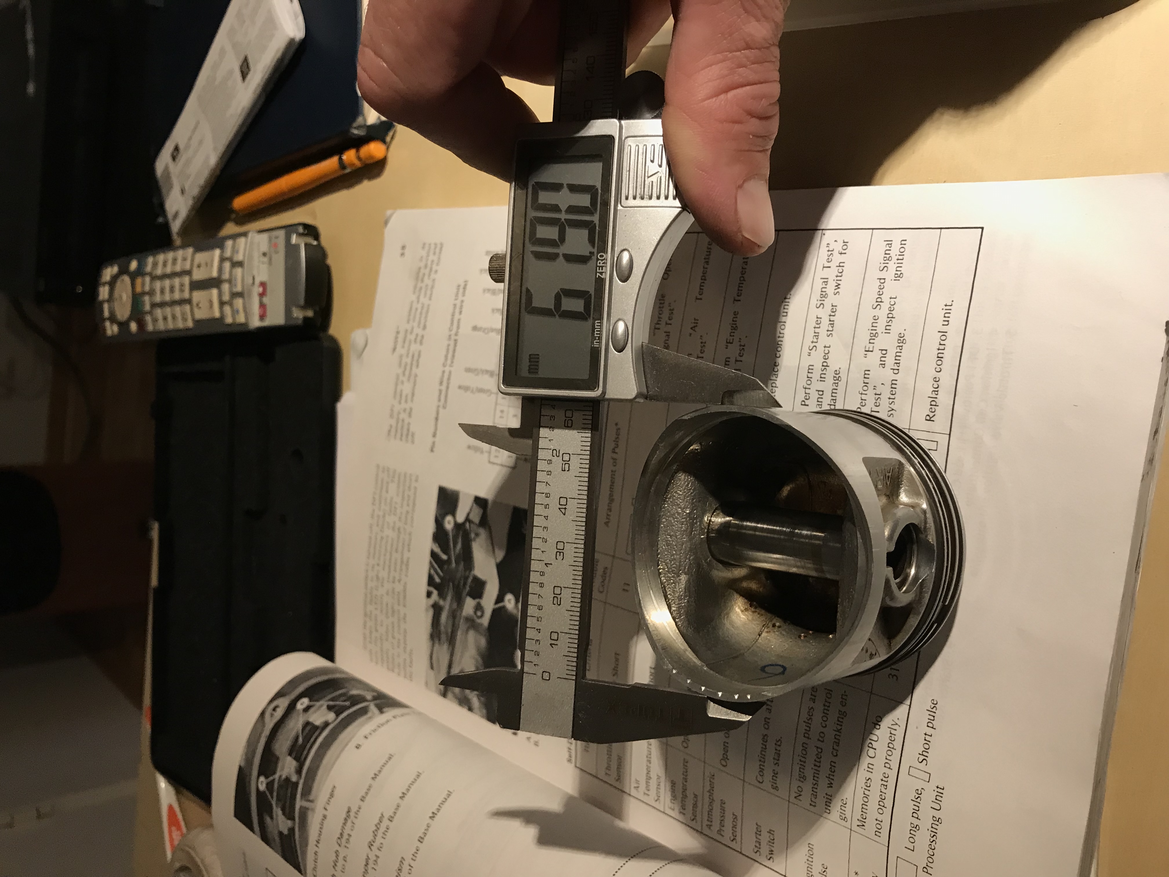

The piston is at service limit (61,85mm). Is it okay to just replace the piston rings and hone the cylinders? Thinking to change valve seats and checking the valves.

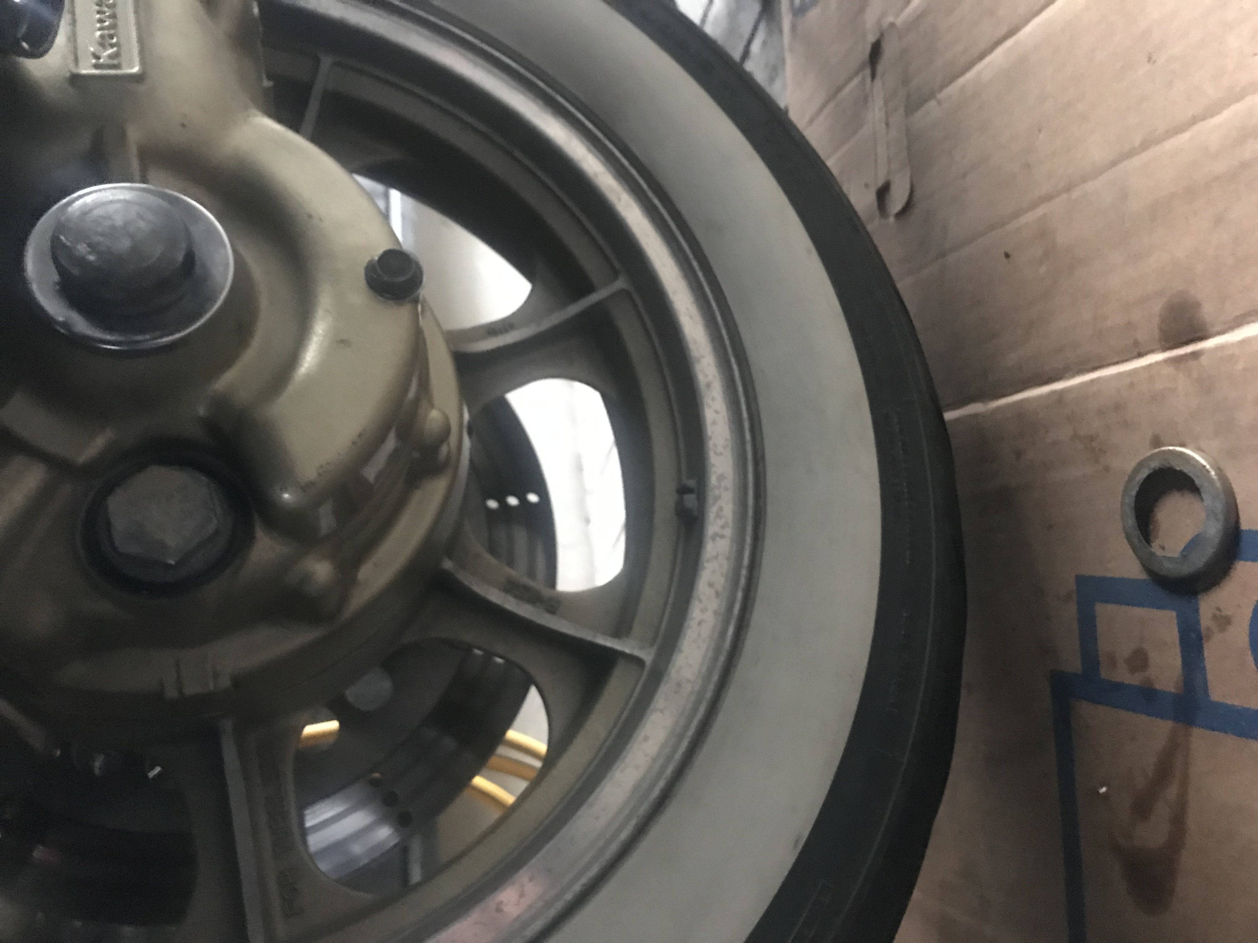

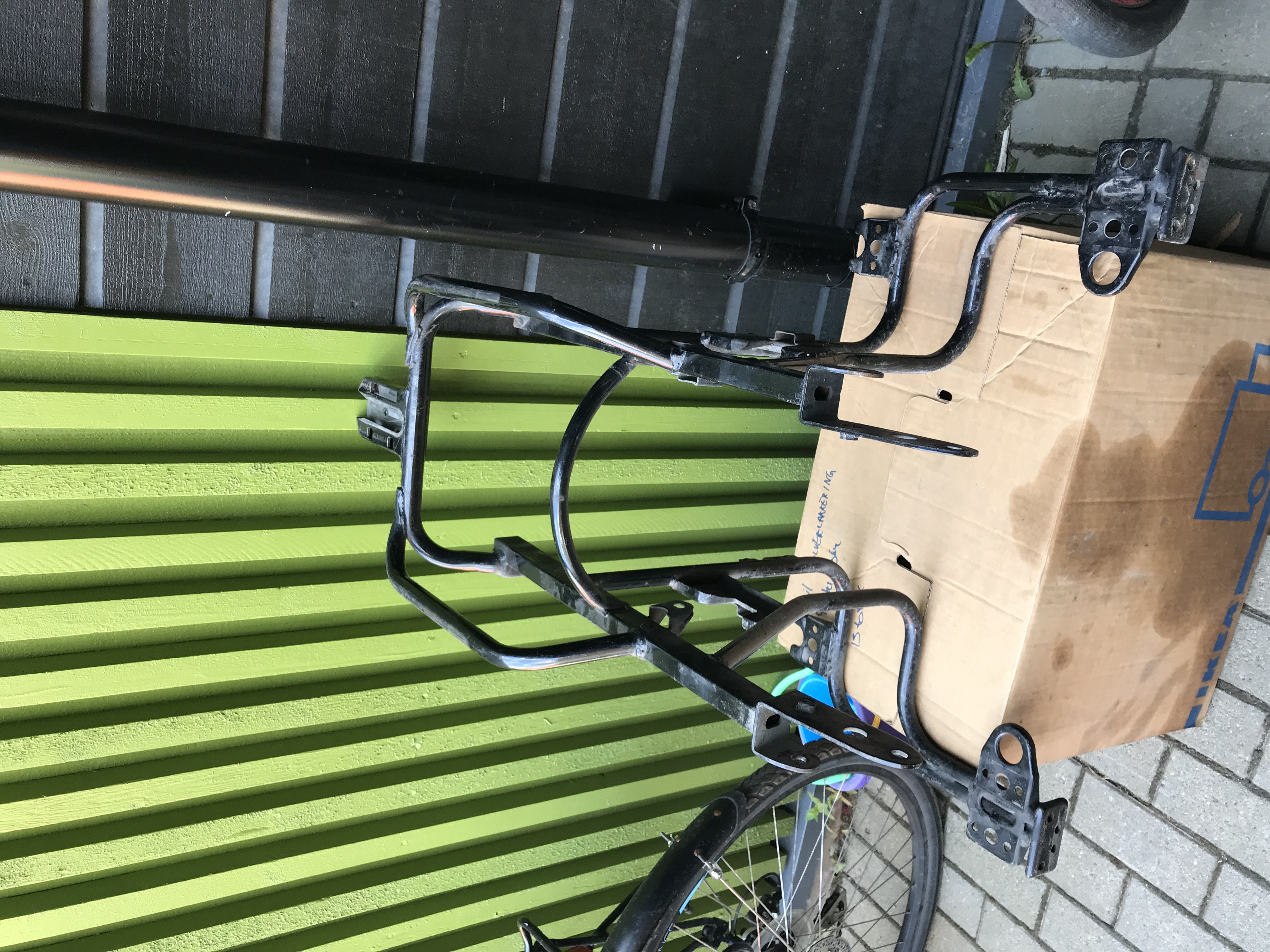

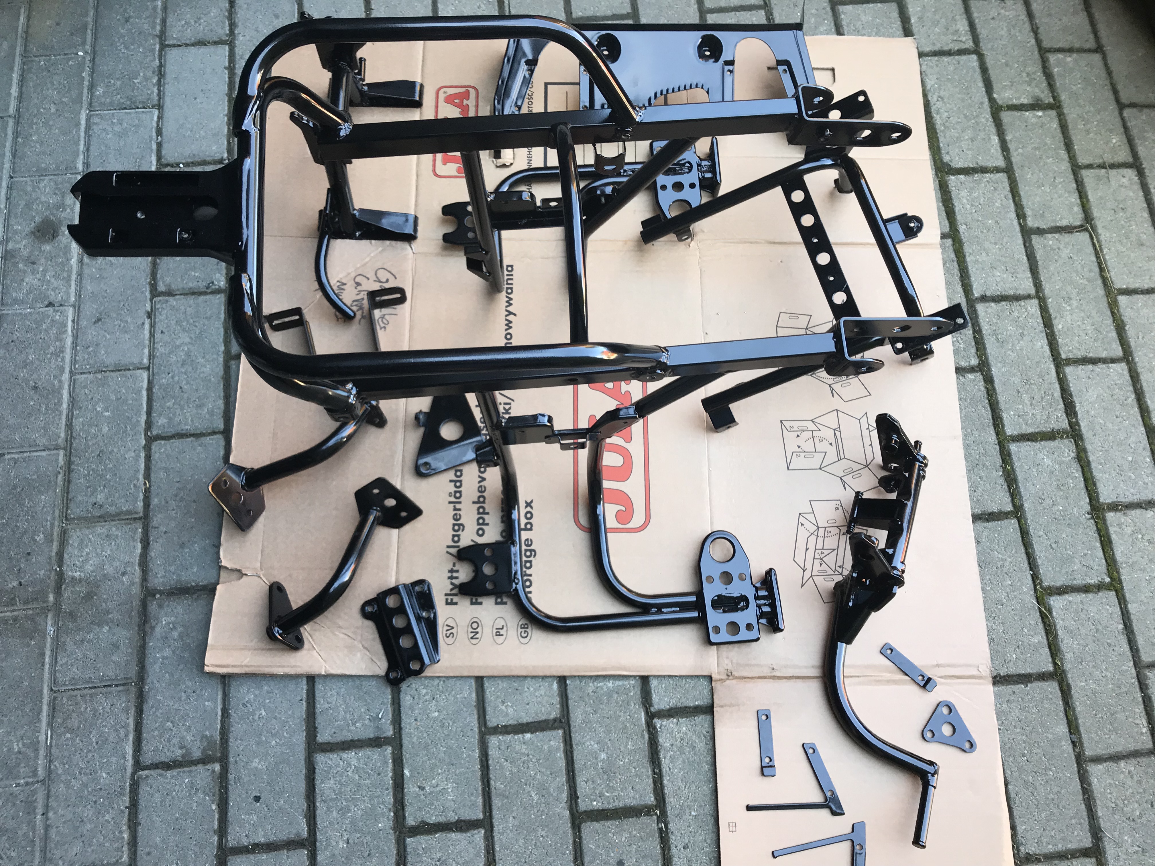

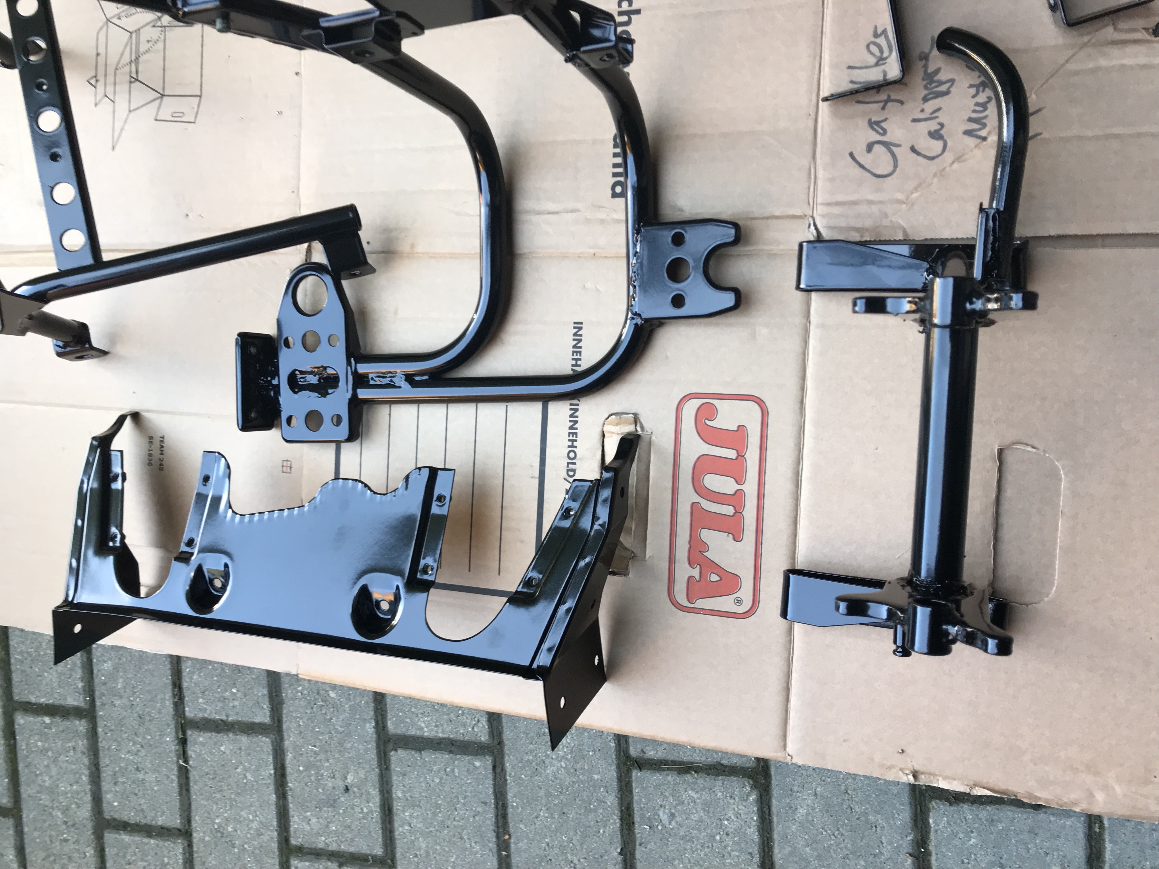

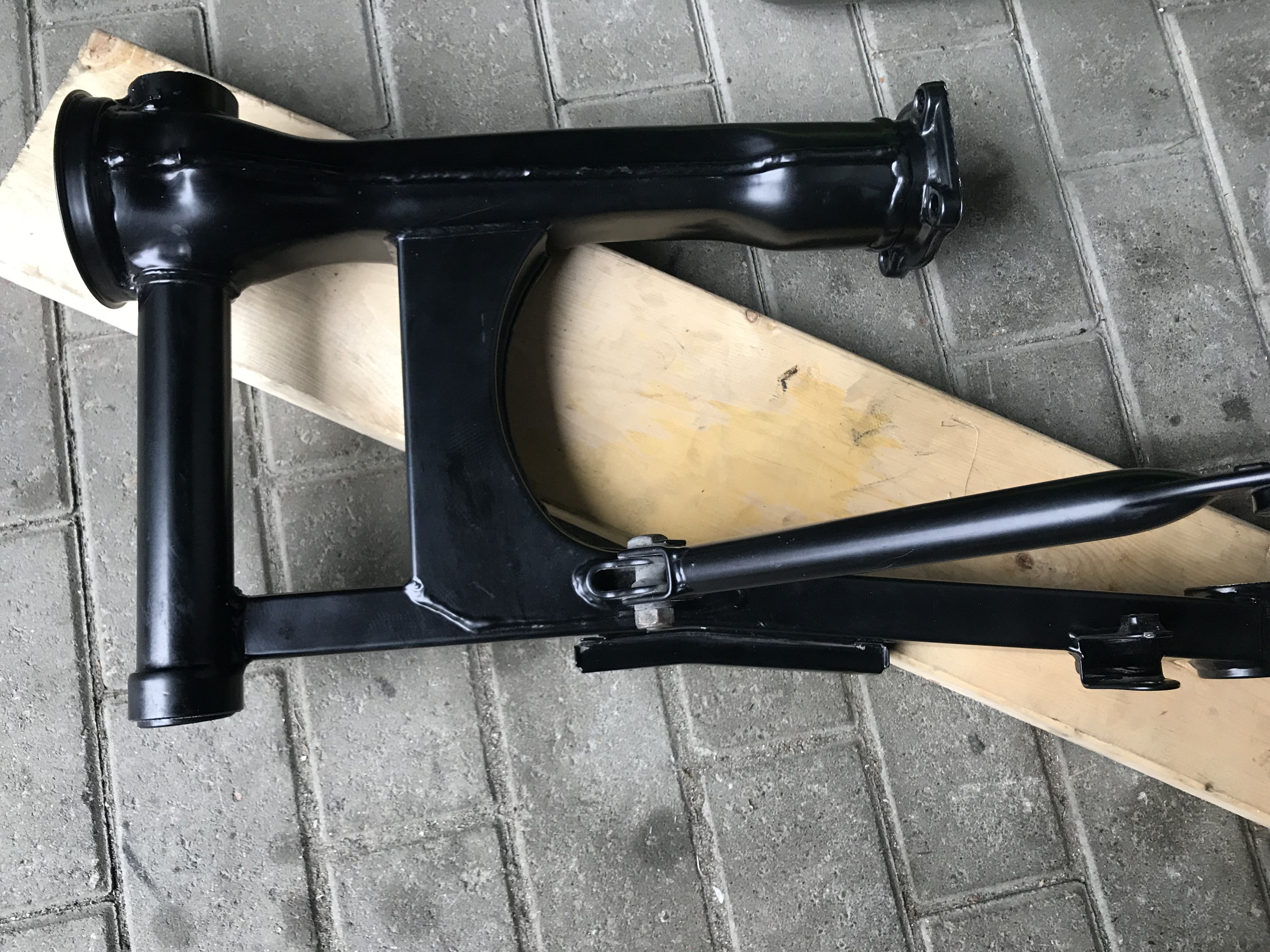

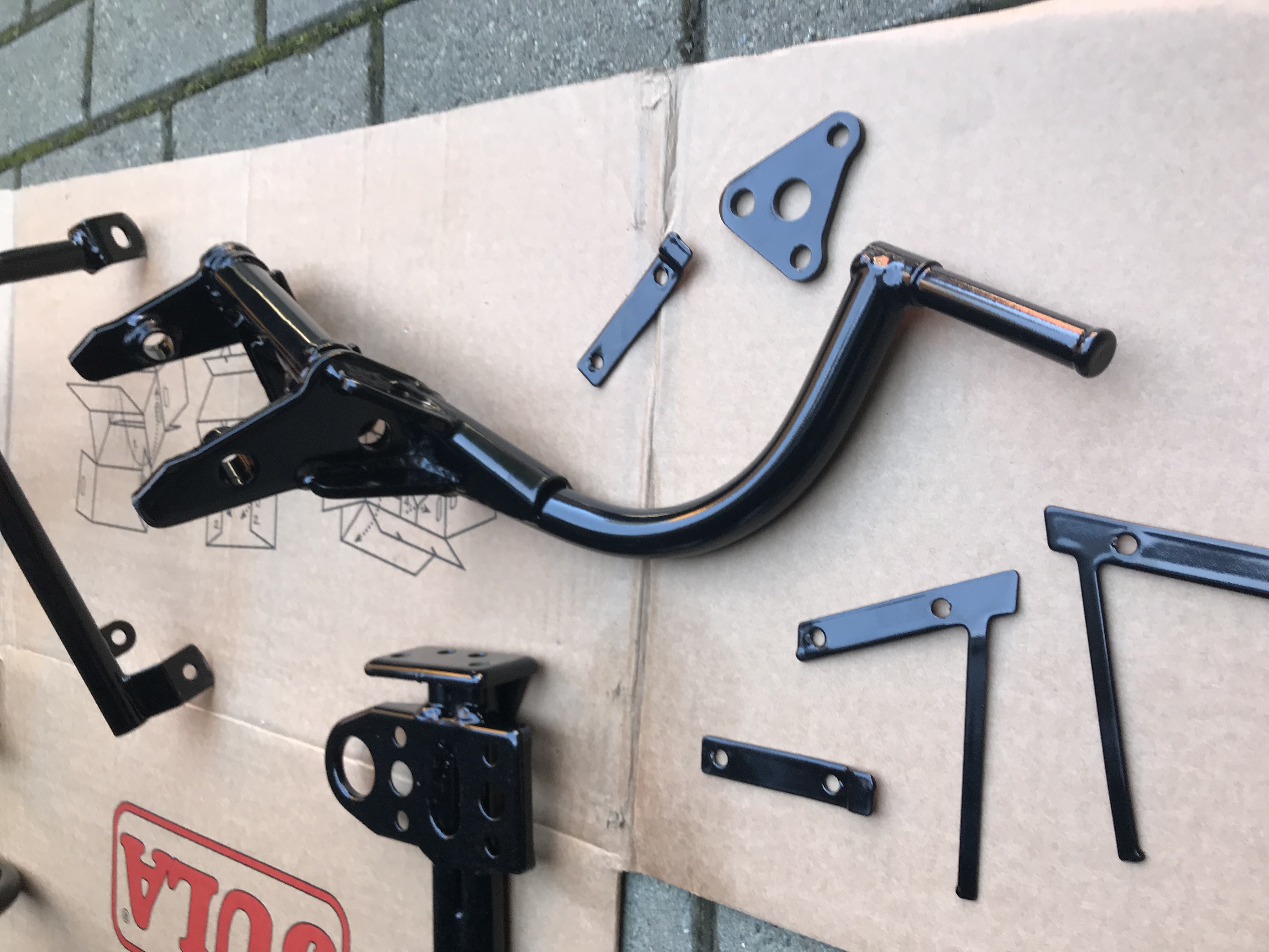

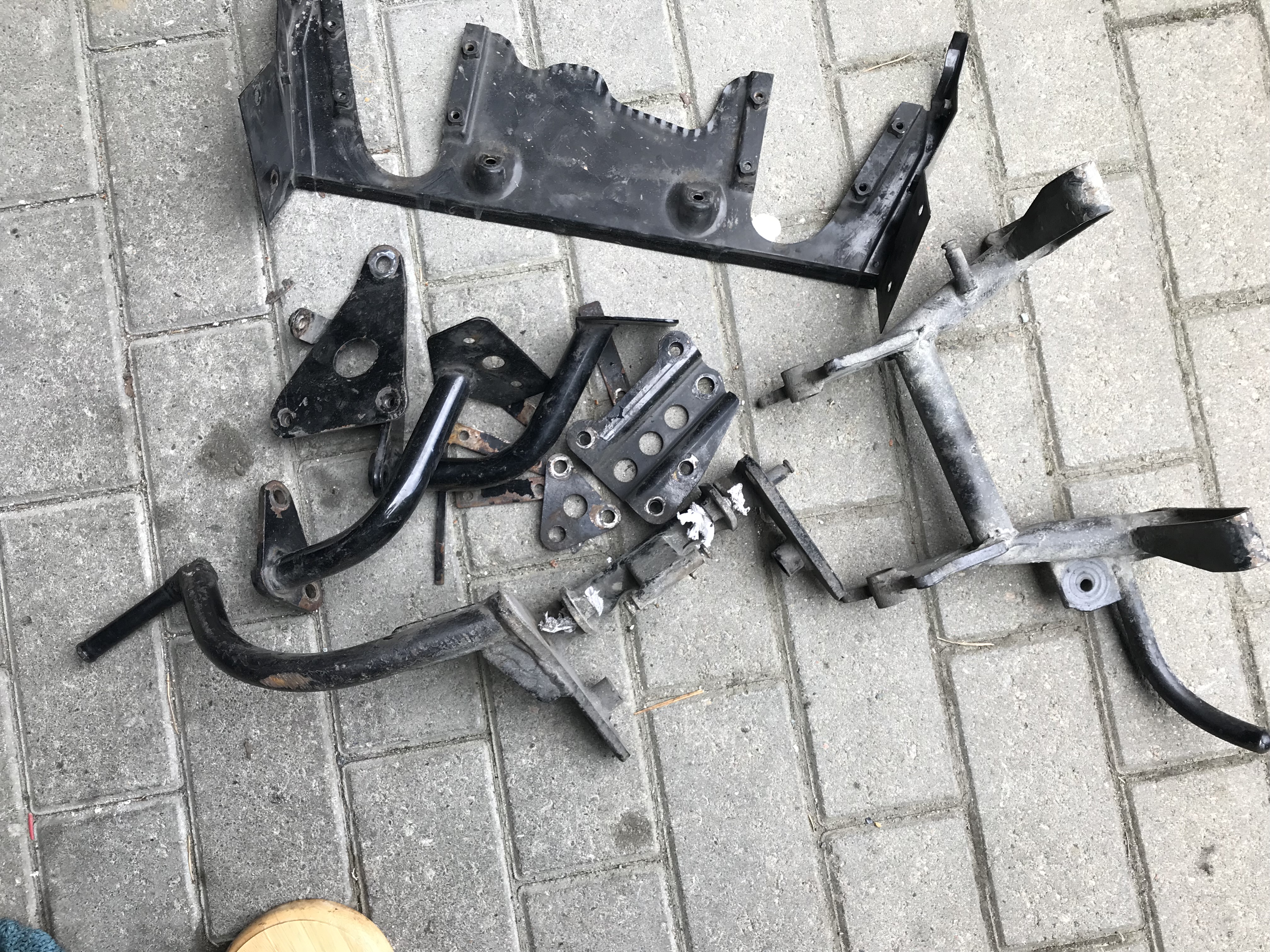

A little update. Thought all was ready to split the crankcase, I followed all steps in page 86 in the manual. But it turns out that the pickup coils assembly also need to be removed. Can’t find that this step is mentioned in the manual. Anyway, that’s a new delay. Will need to order or make tools for that operation.
In the mean time I removed some brackets and other parts including the rear frame, for blasting and powder coating. I’m not going to strip the entire frame. The goal is not a complete restoration, but have a good everyday rider
Last year I got the swing arm, rear caliper, brackets, covers and trip computer powder coated. The results was nice, taking the rest now.

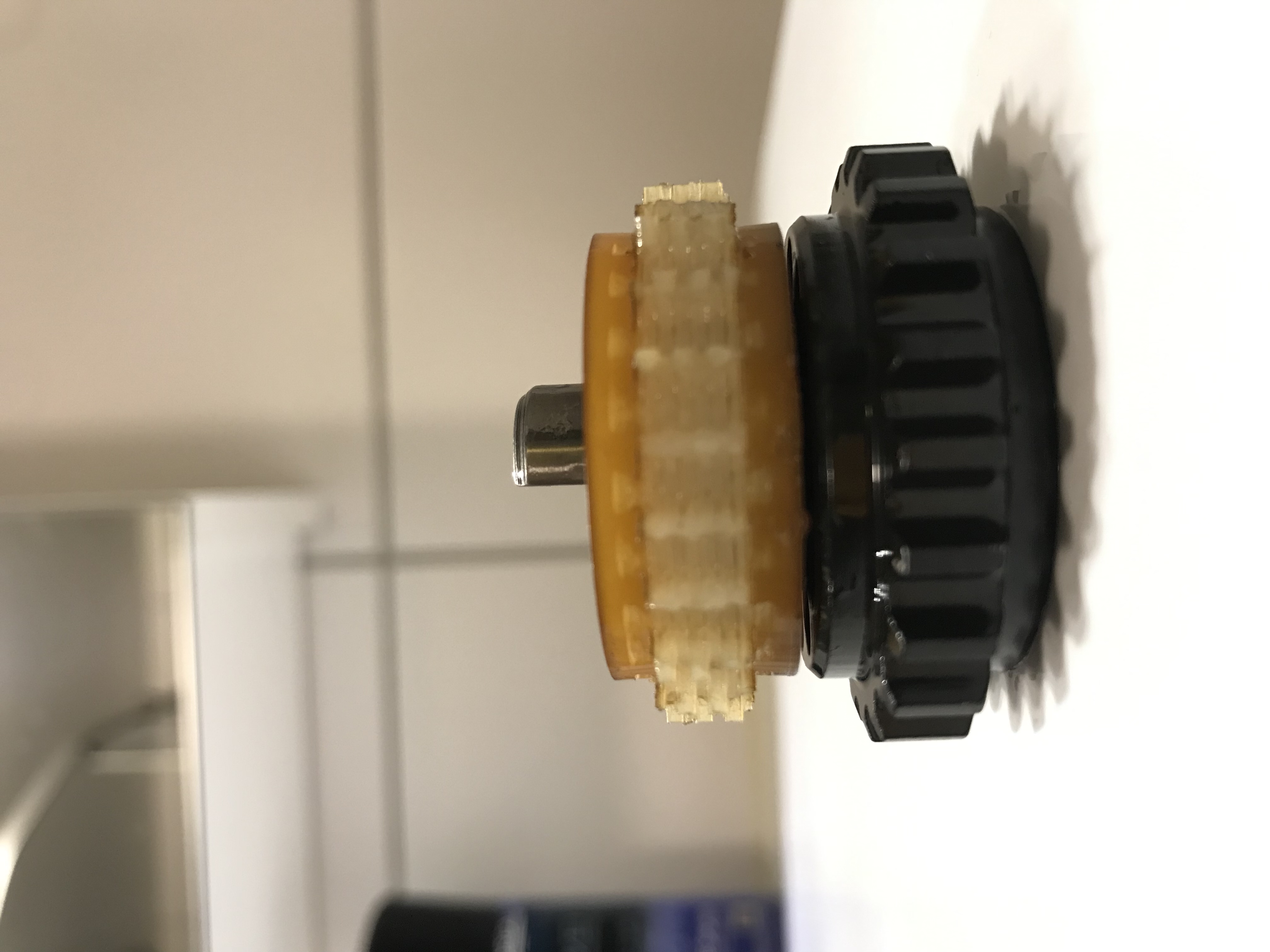

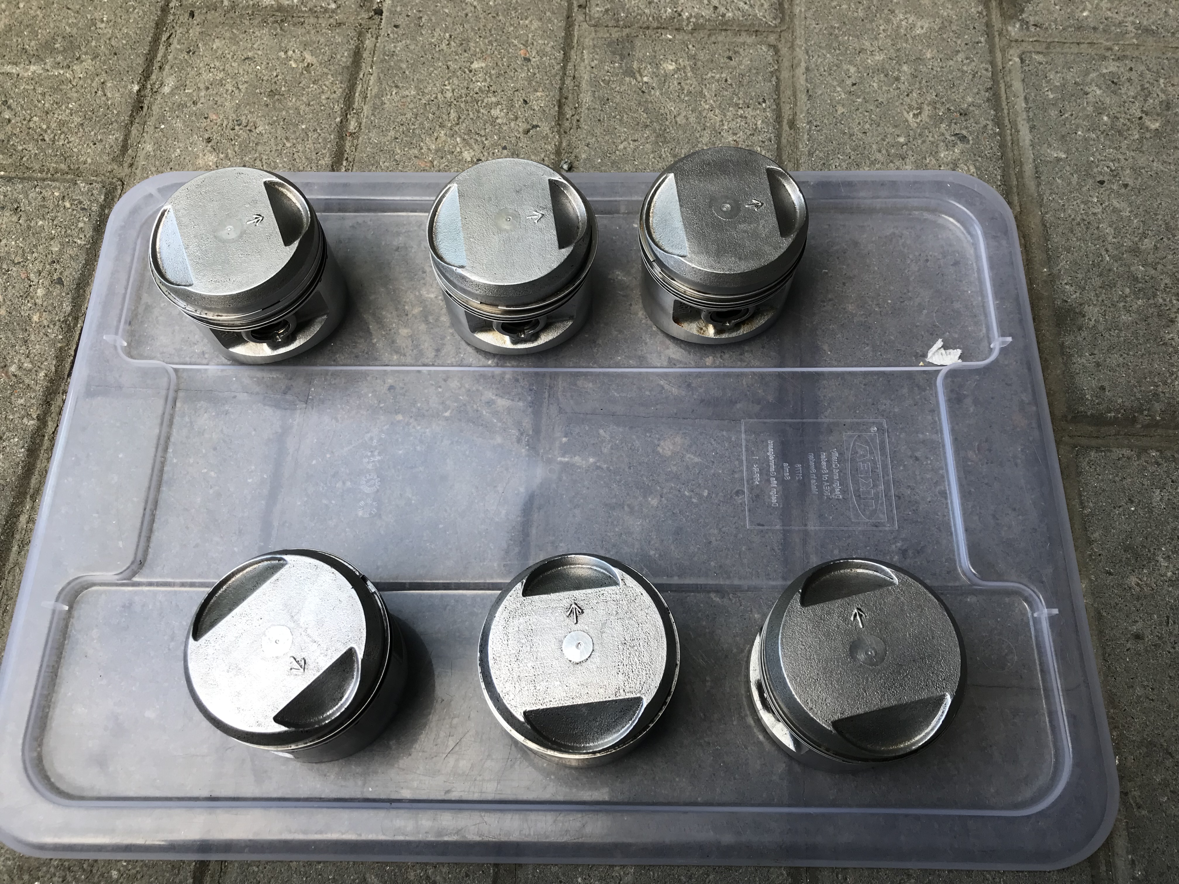

Pistons cleaned
According to my digital caliper, pistons is at service limit (or almost)
D.I.D Cam chain arrived yesterday. Endless type.
I had a Morse cam chain already, open type. Since I’m already going to split the cases I’m going for the endless type, D.I.D
The Morse chain is slightly thinner than the D.I.D don’t know if there is difference in the quality.

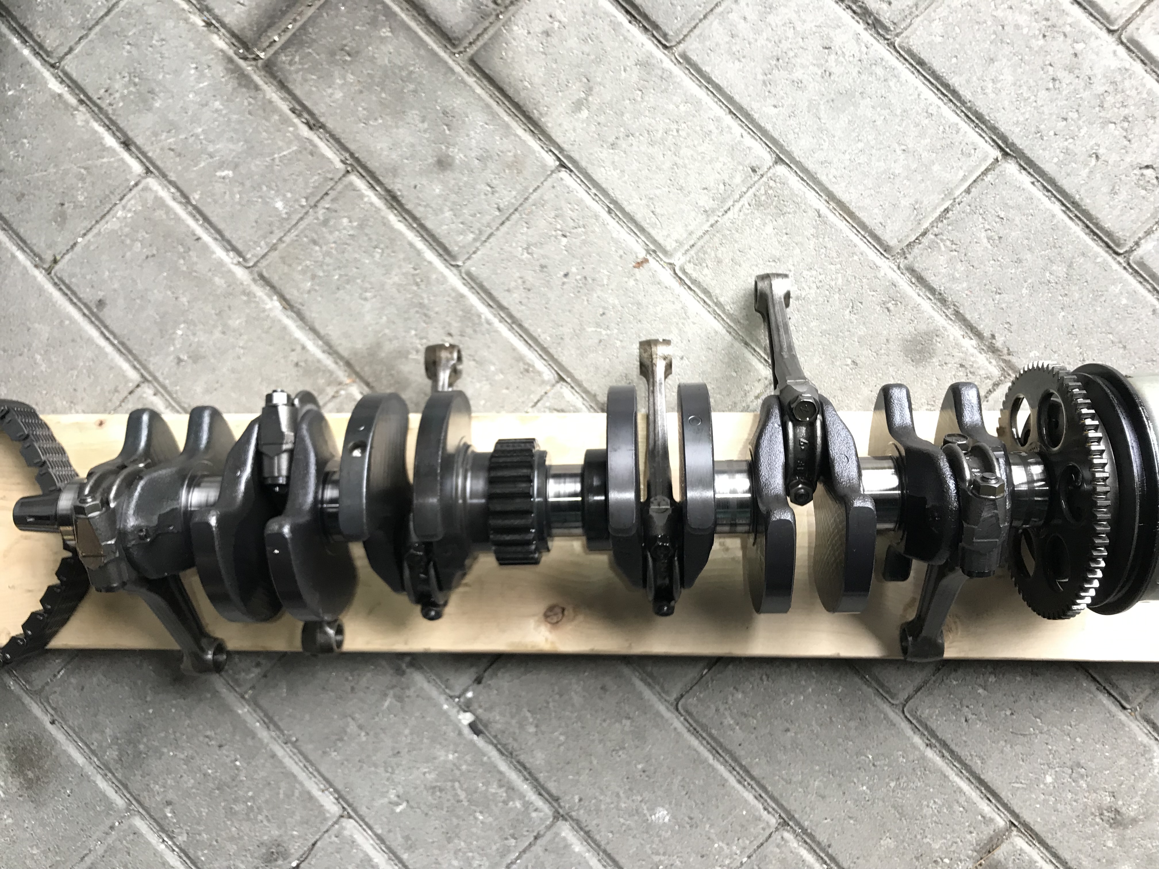

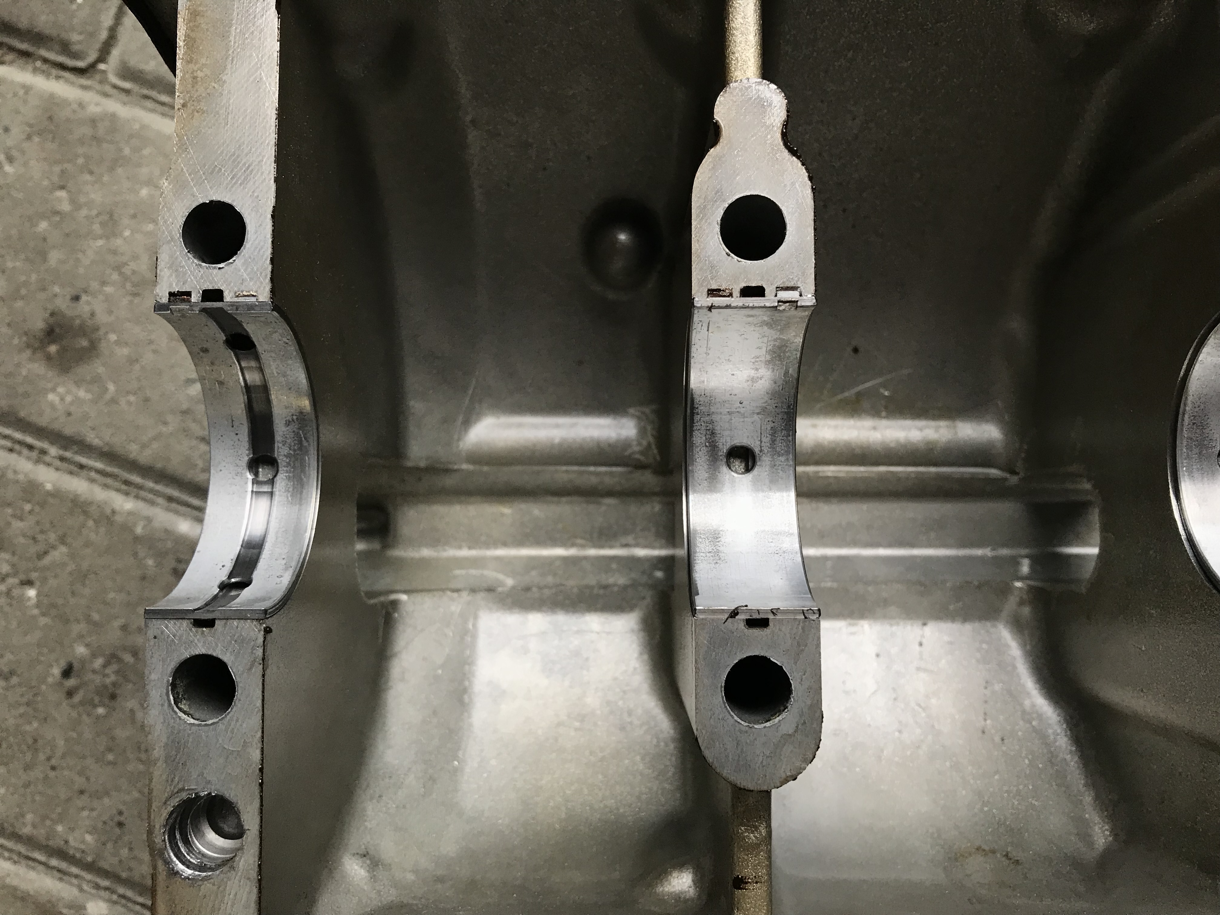

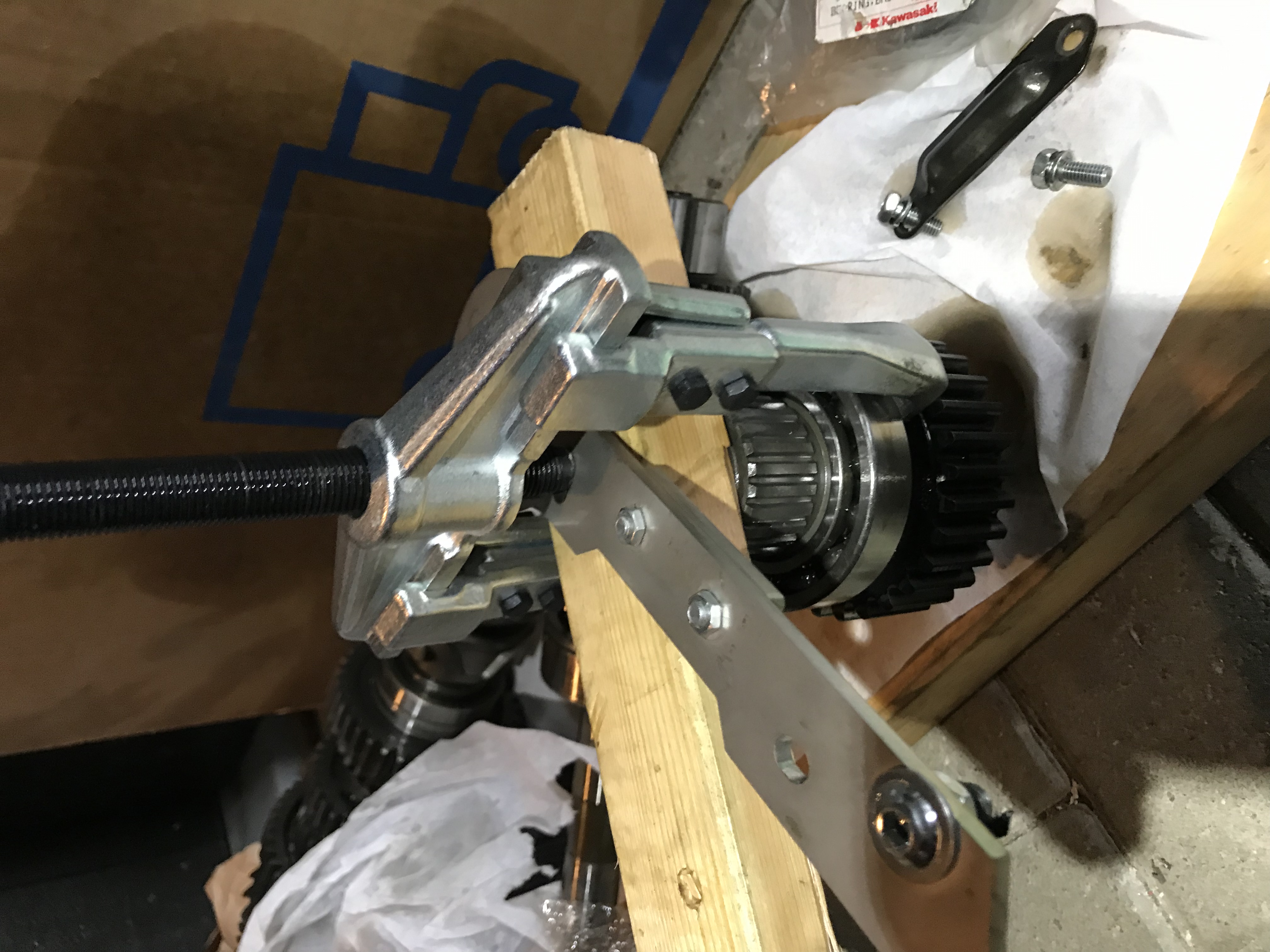

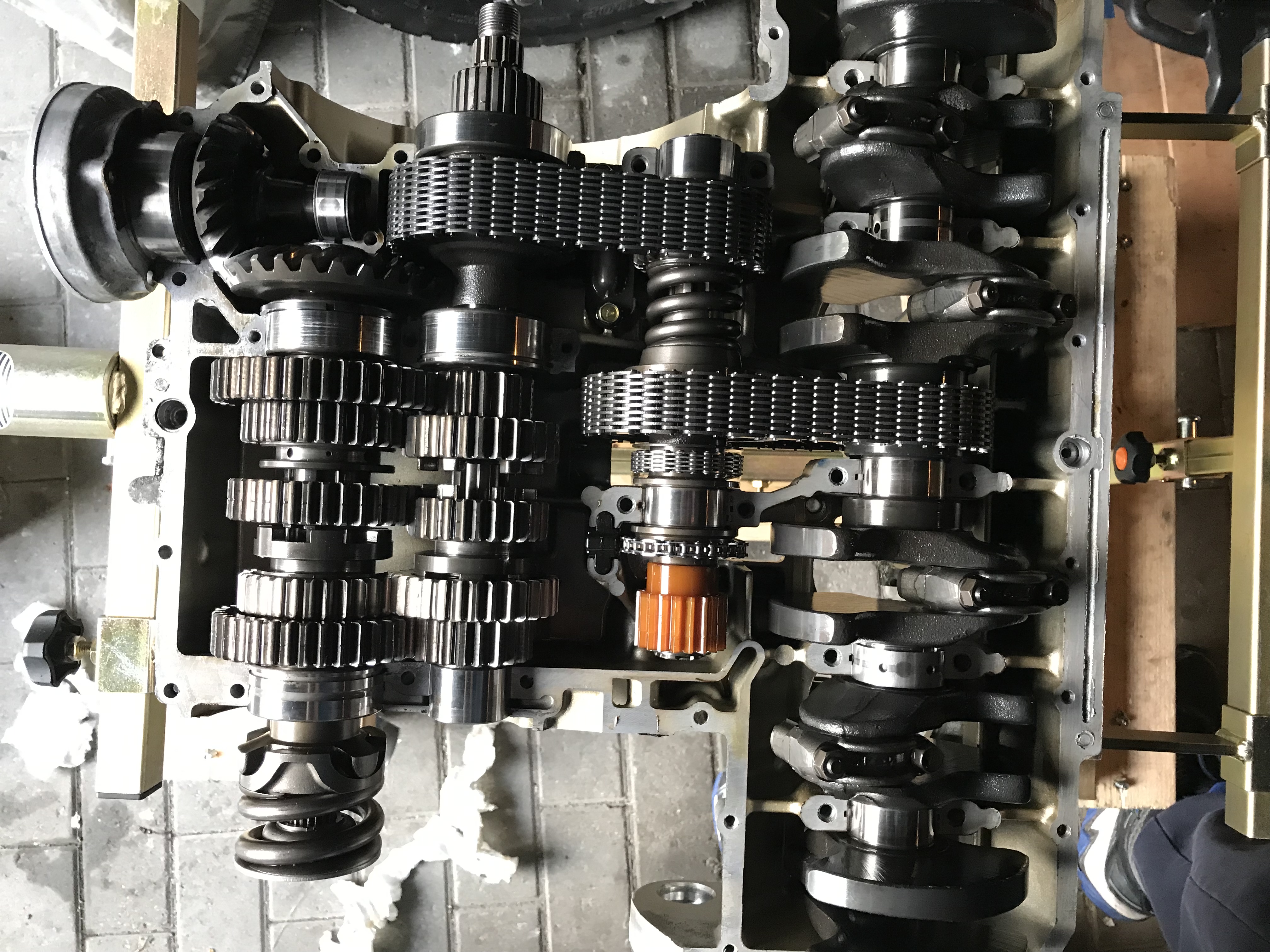

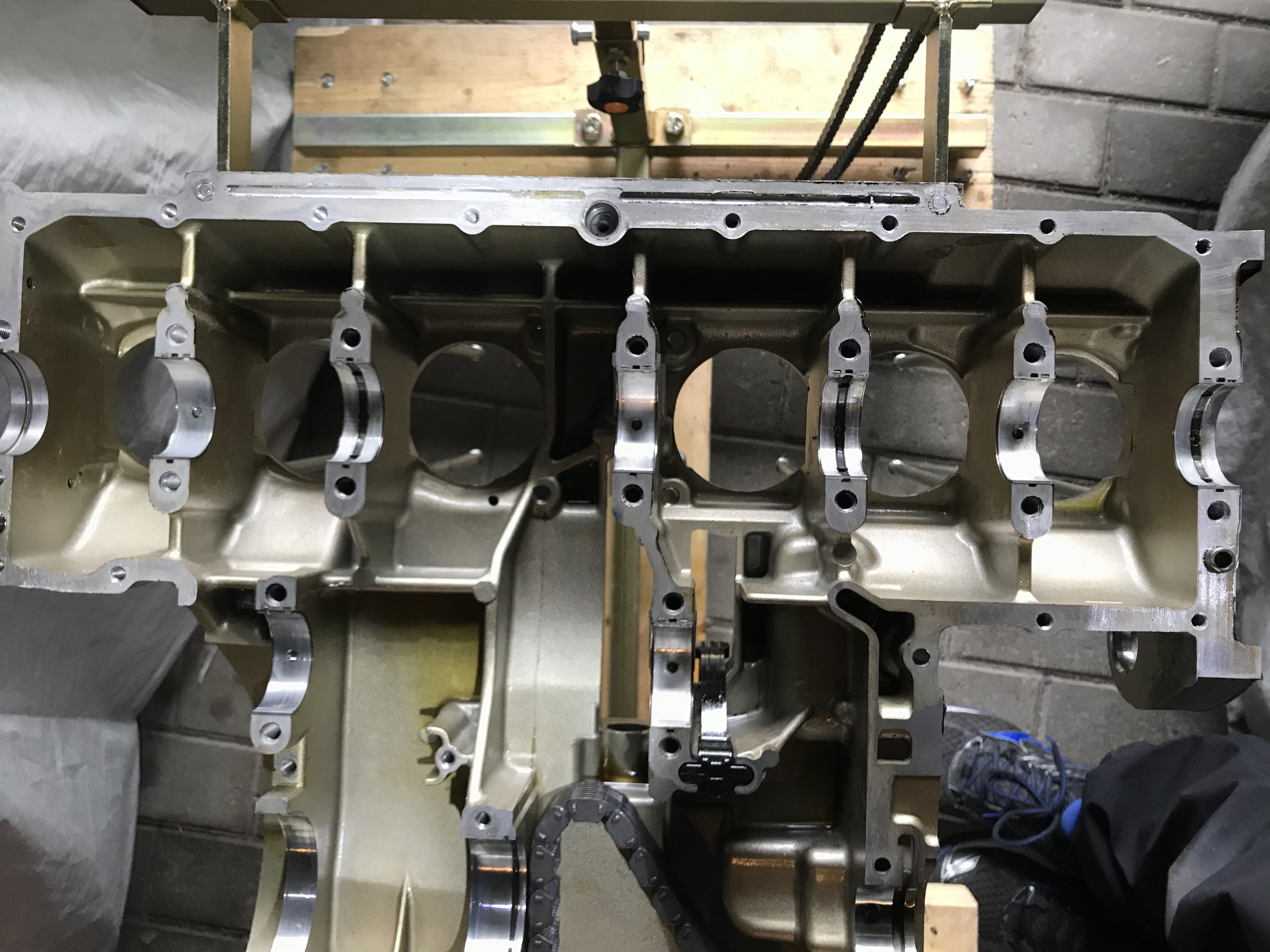

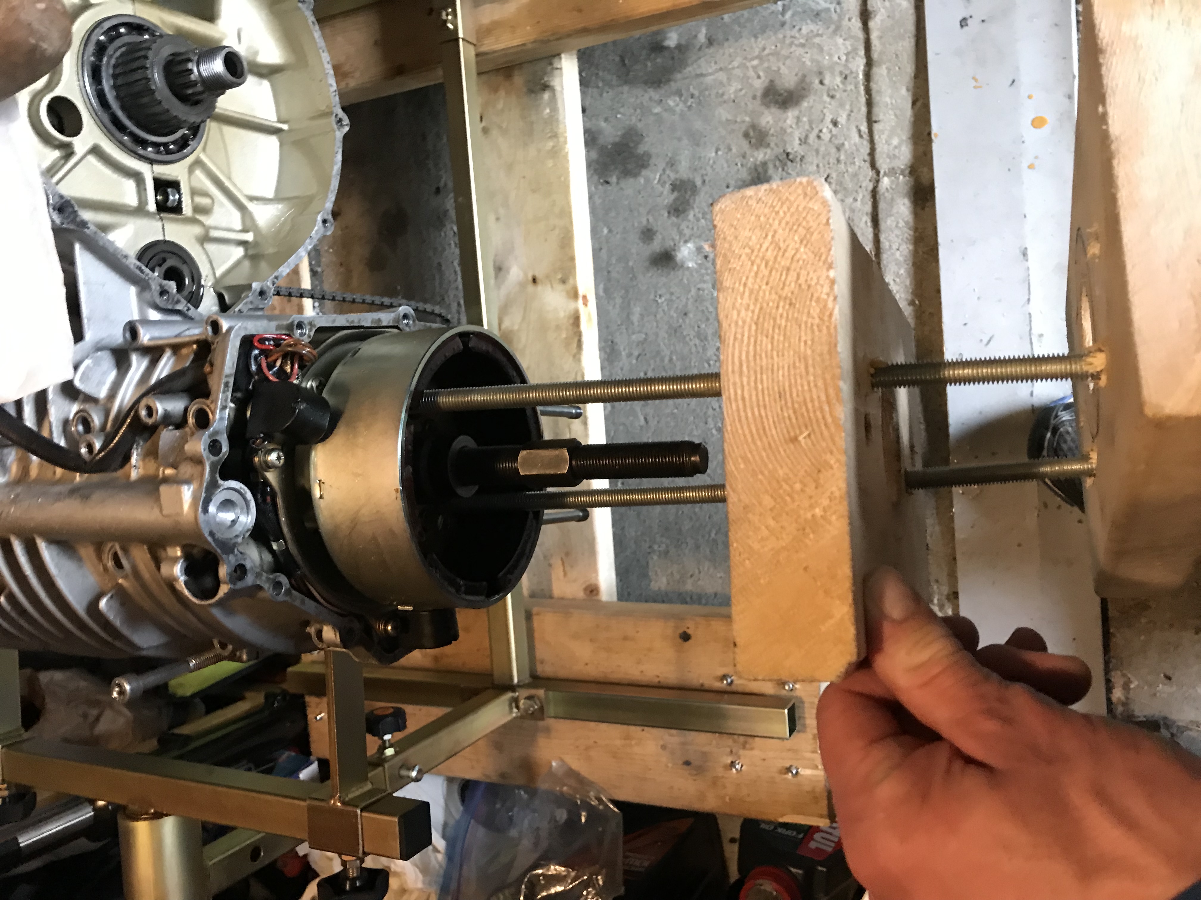

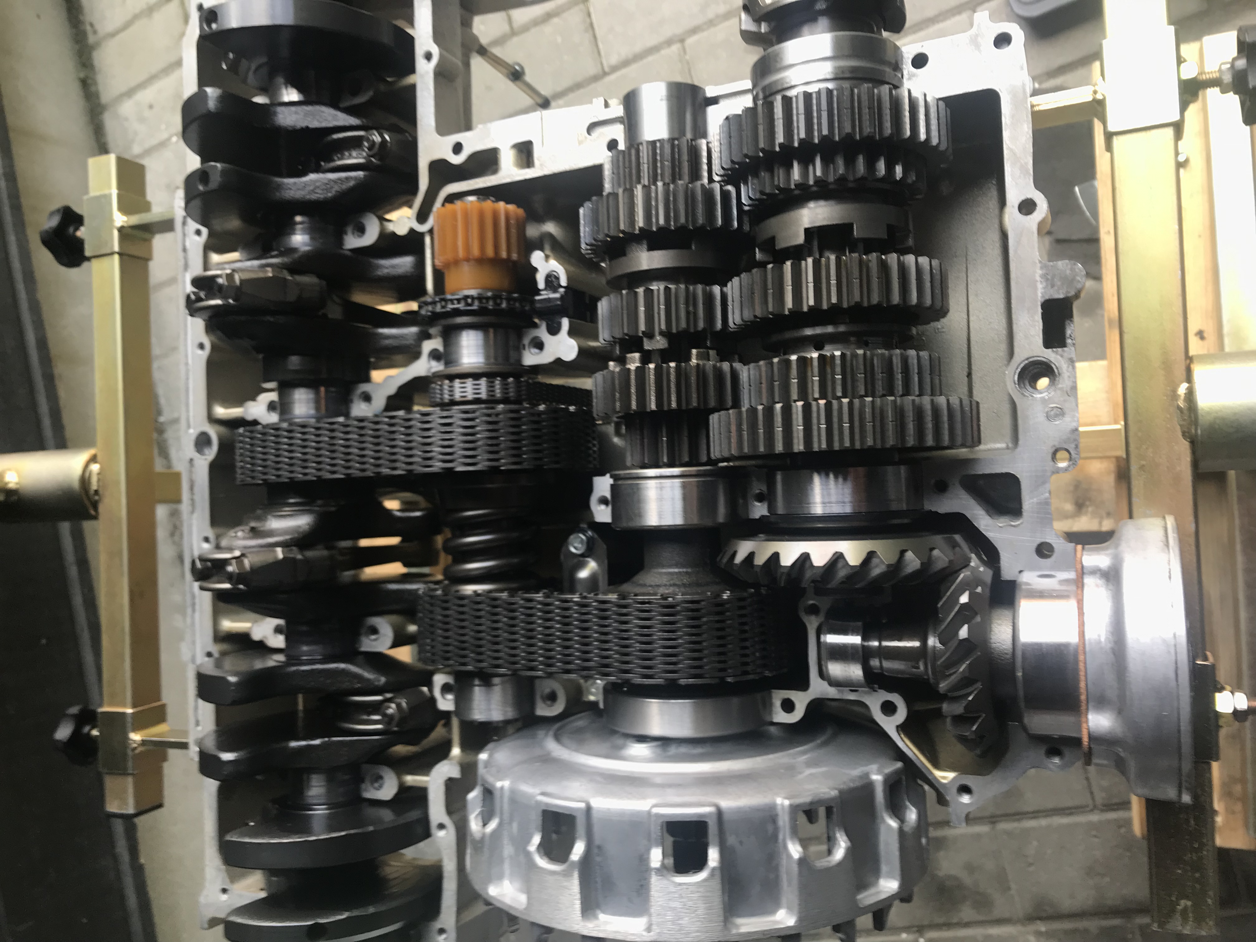

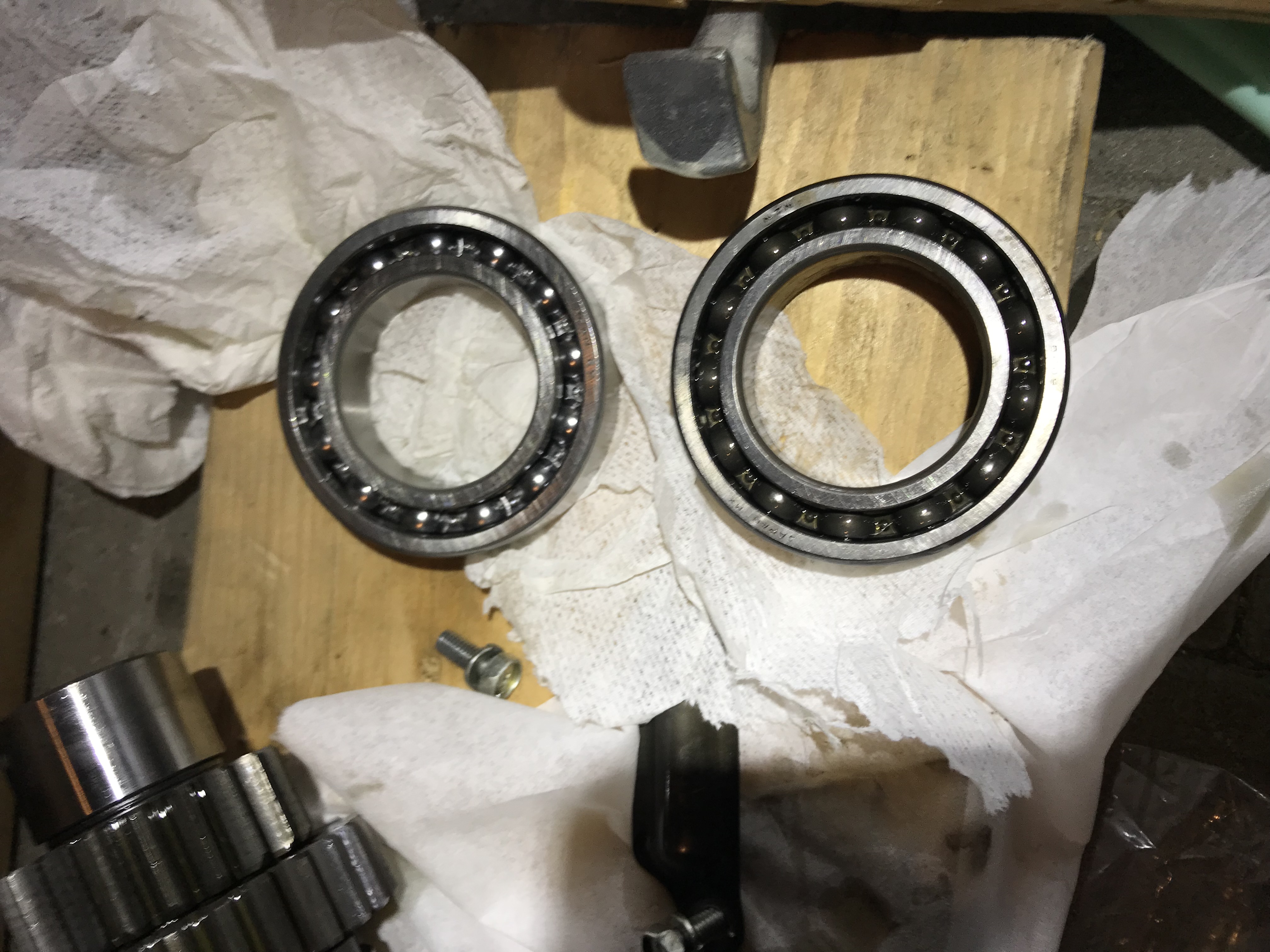

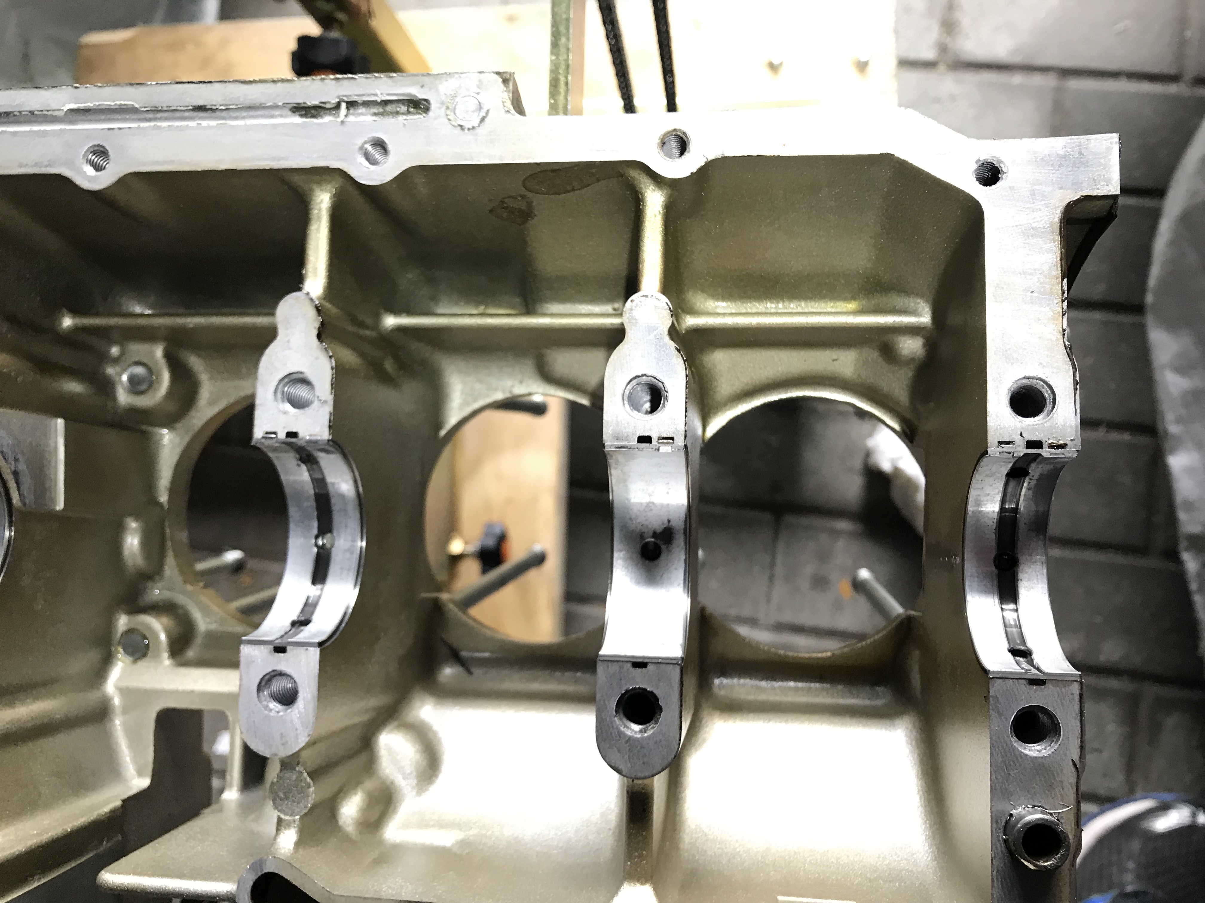

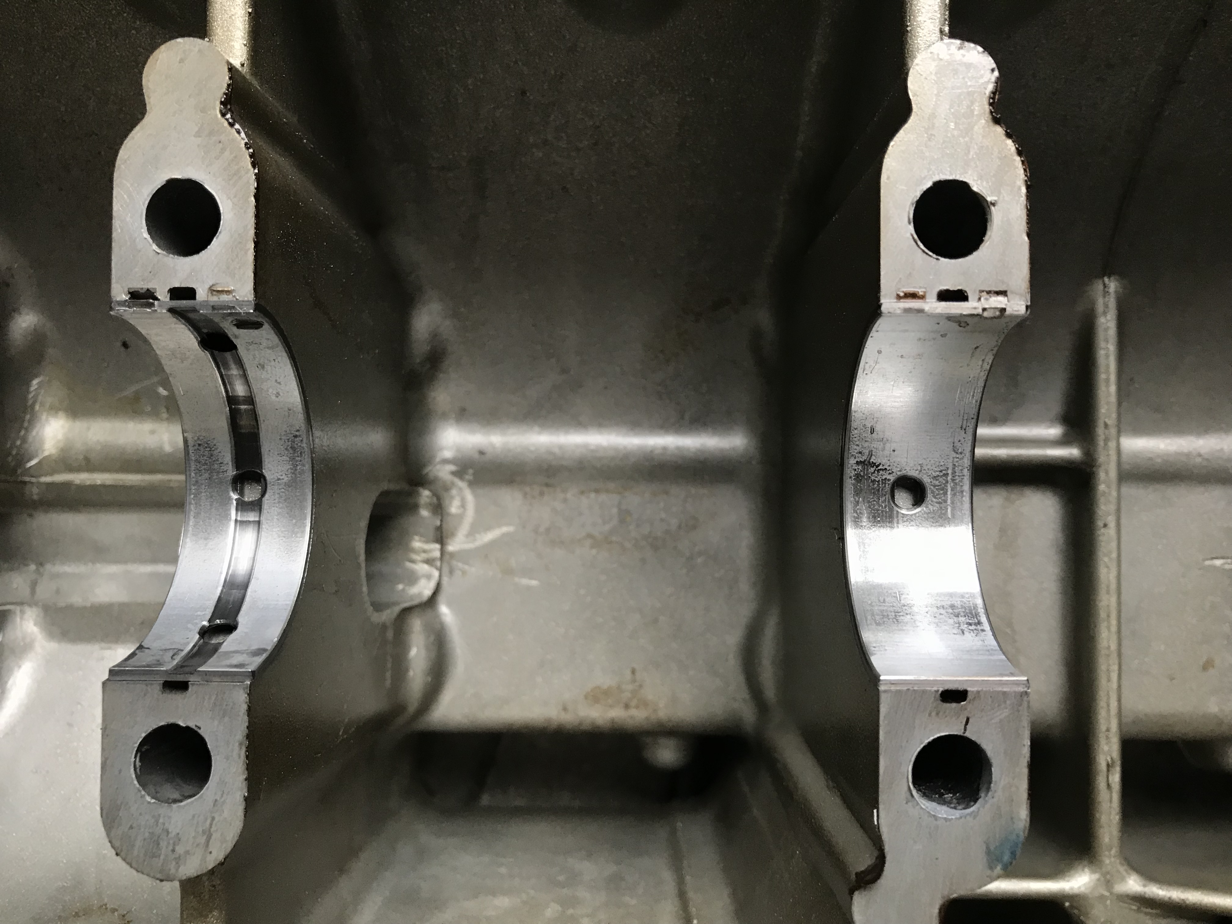

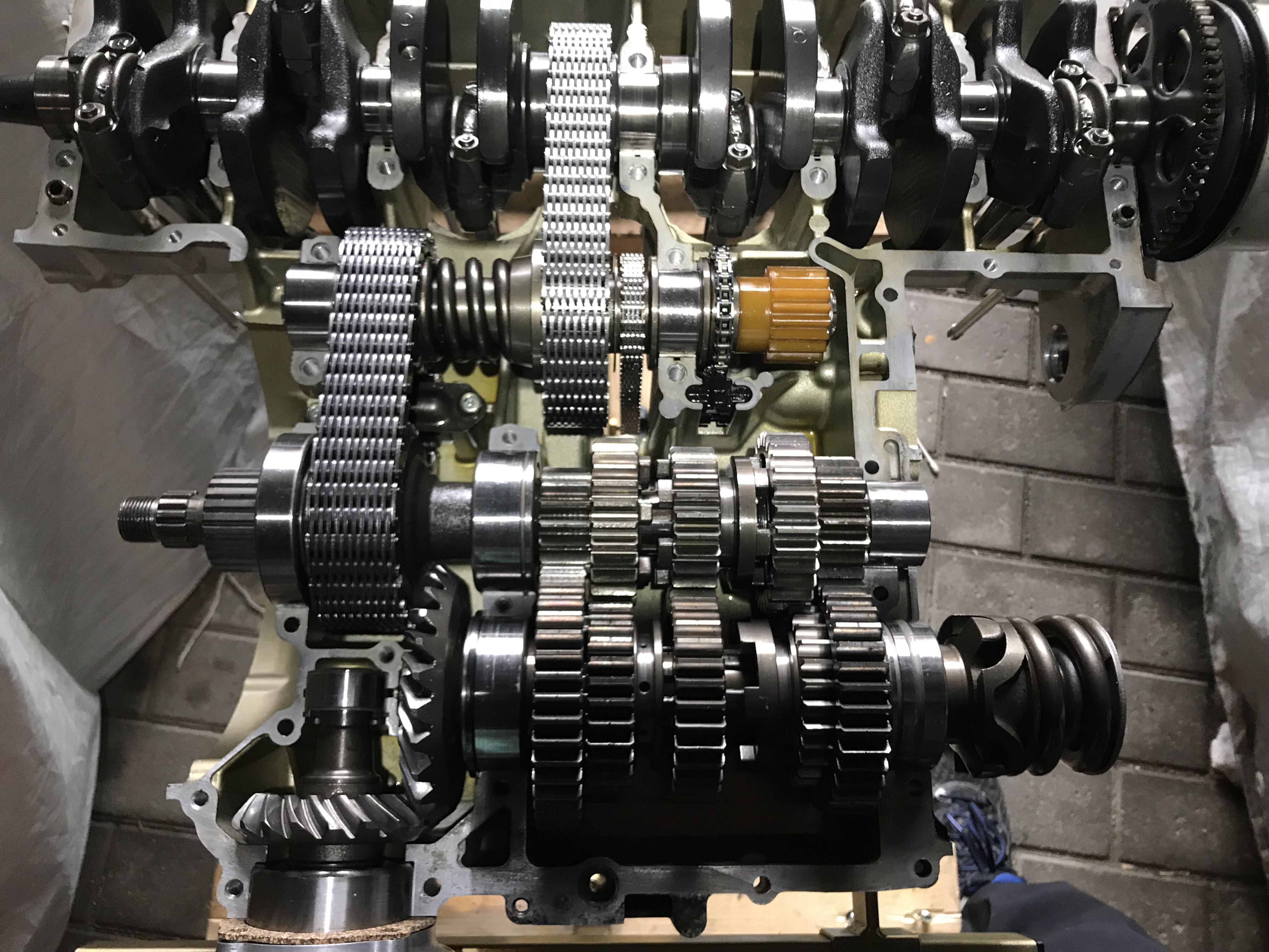

Today my special tool for removing the rotor arrived. Splitting the cases was easy with the right tool.

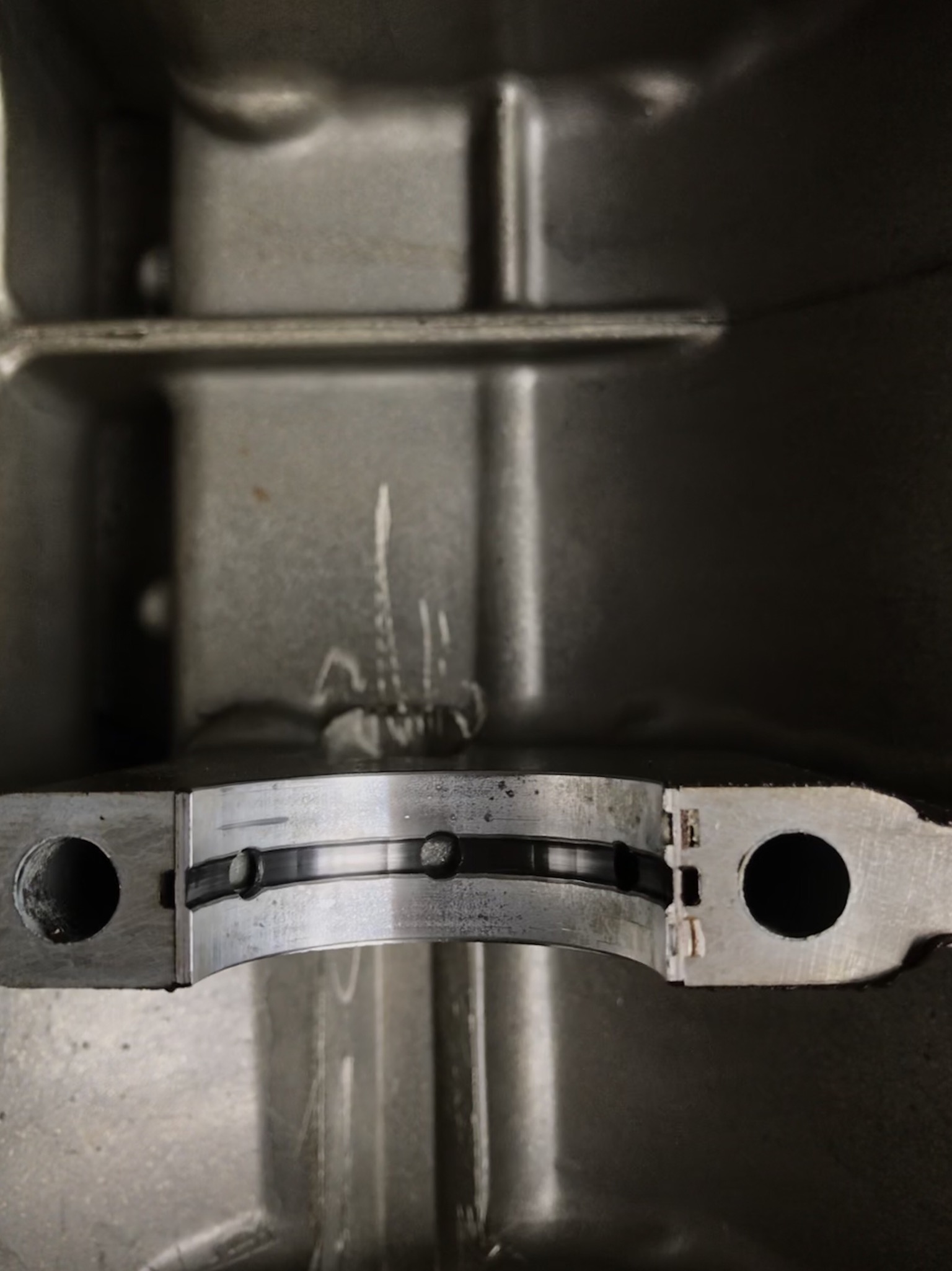

I don’t like the look of the crankshaft bearings, I’m afraid they are worn out? Maybe the crankshaft to, need to measure it.
The positive side is that I’m learning so much and the primary chain and secondary chain was all within service limit

Re: Engine rebuild
From the picture,I would not change the bearings until I checked the clearance with a product called plastigauge.We use it a lot in our repair shop.Google the product,and you can see how you can check bearing clearances with it.
If the clearances are with in spec,leave them inn.Your picture only shows normal polishing of the bearings(from the clarity of the picture).

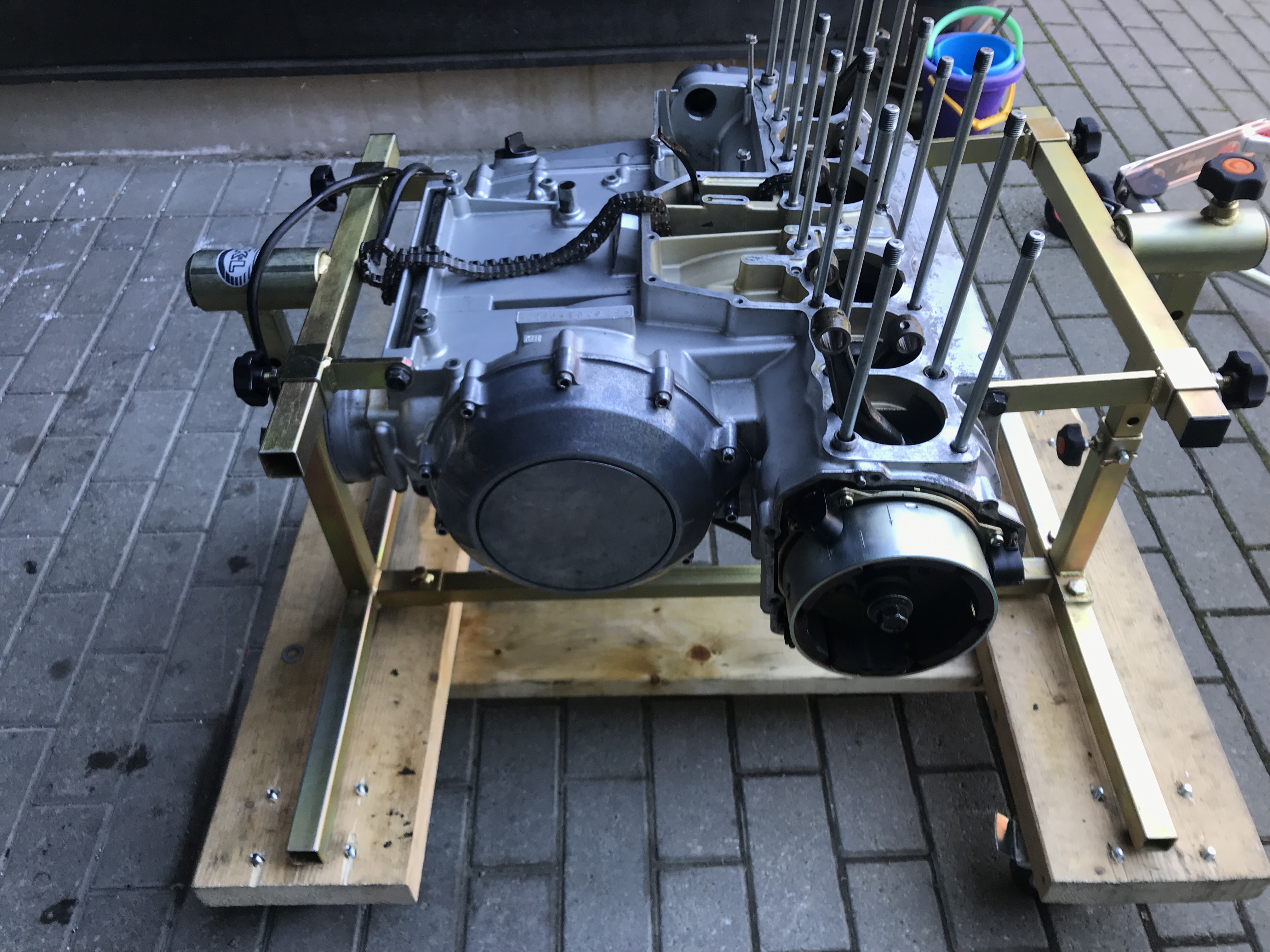

Today was a good day, I replaced some new parts The primary chain, secondary chain, secondary bearing (didn’t know it was gone, luckily a previous owner had bought one before and it followed the bike when I got it), transmission, and camshaft chain.
Haven’t decided what to do with the bushing, connected rod. The manual is very clear that all bolts and nuts must be replaced if the bushing is replaced. Right now the flanged bolt is out of stock at the dealer. Can’t find it on eBay either. Maybe I just leave it.
The primary chain and the secondary chain wasn’t that bad, 16mm slack. Since I already had new one I replaced both chains. Now the slack is 6mm

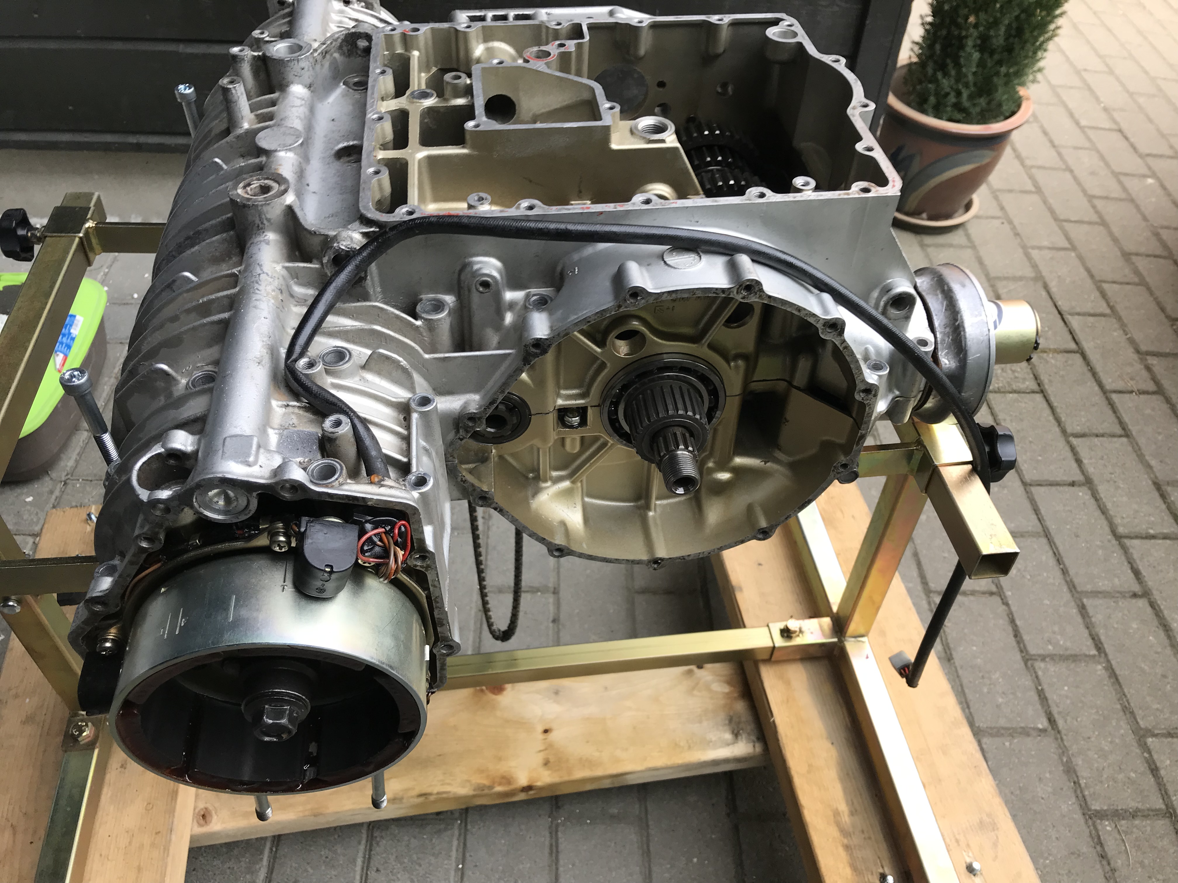

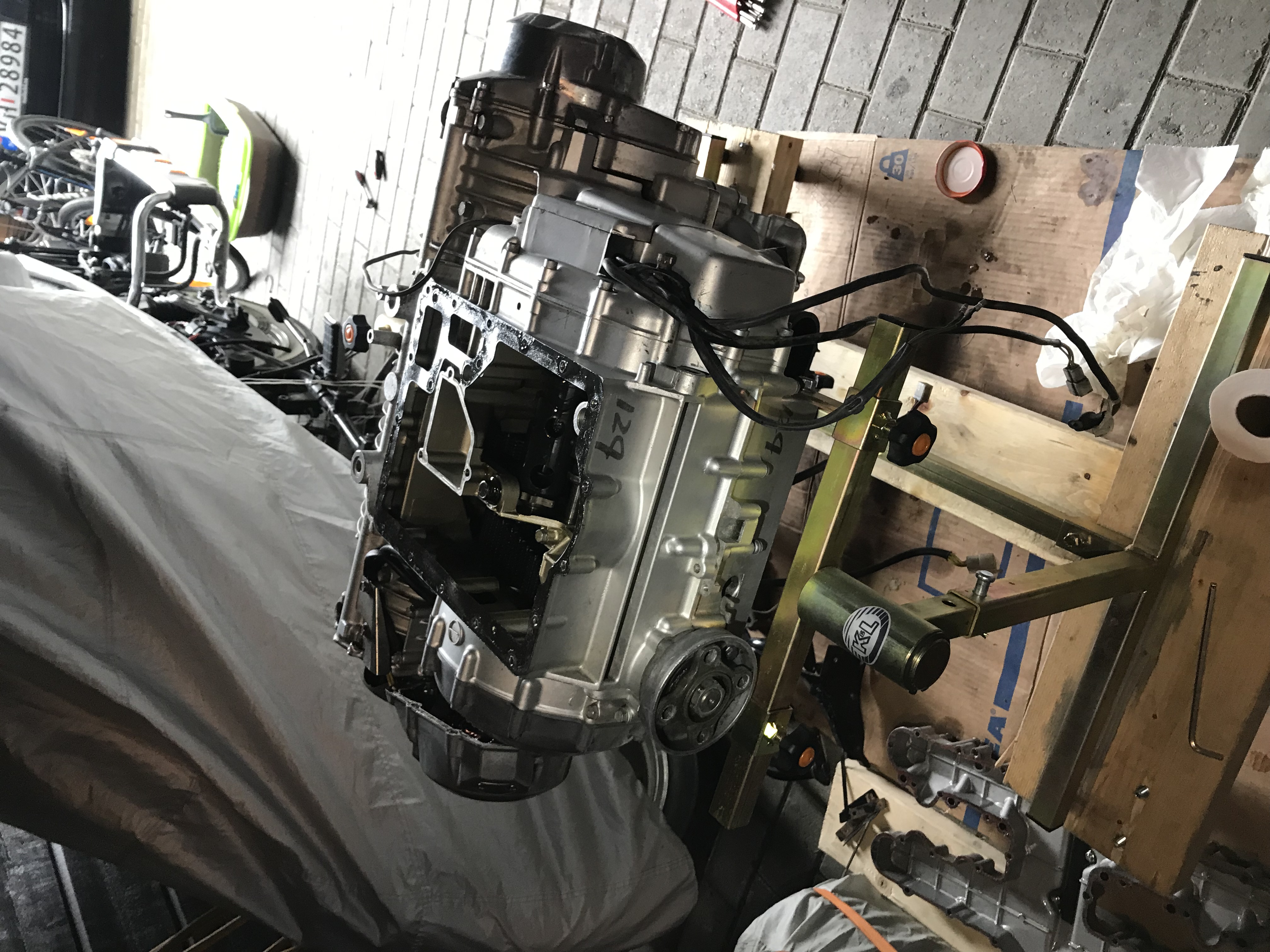

A little update.

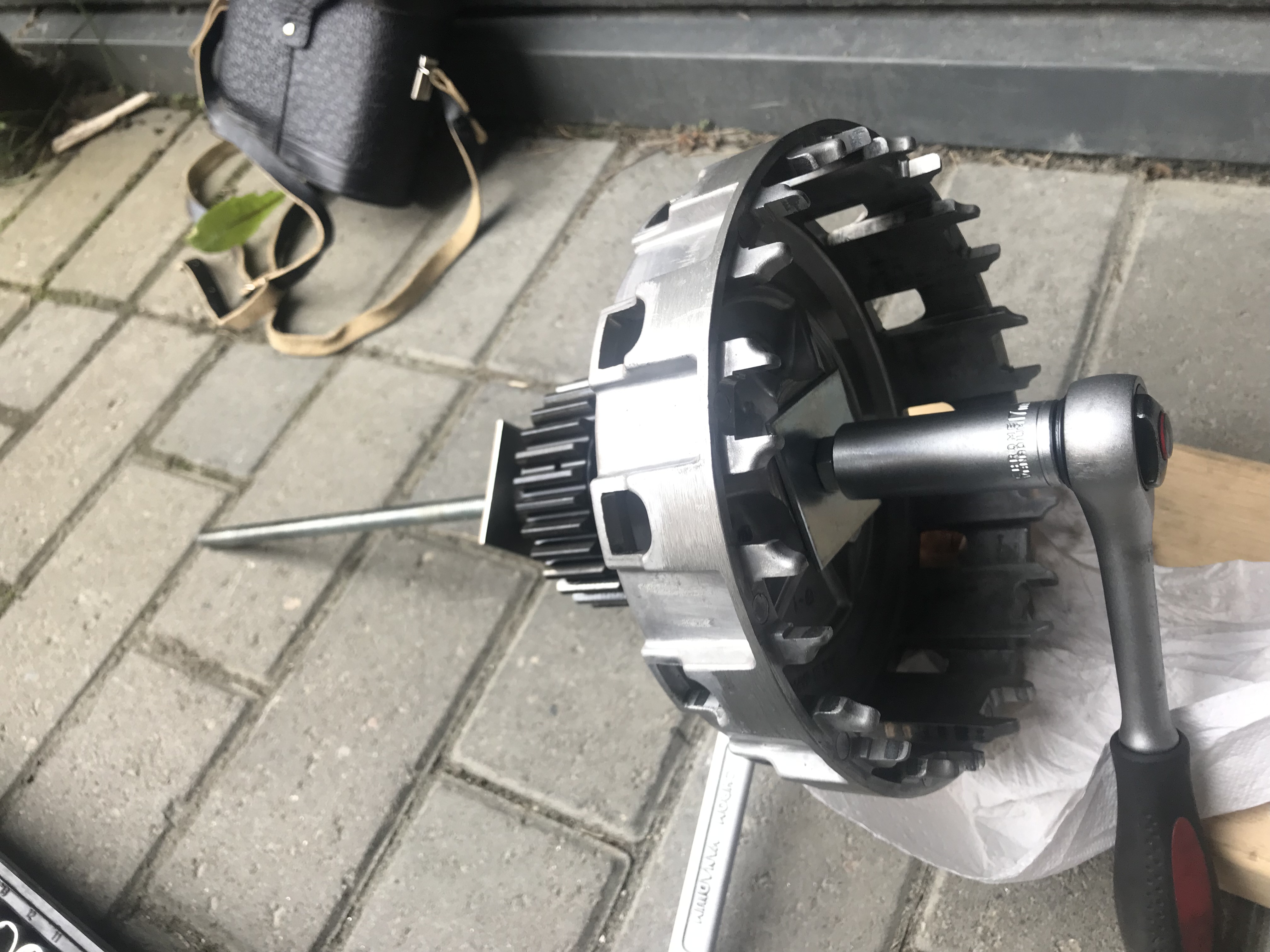

Decided to put the clutch basket on before reassembling the cases. Much easier and better for the transmission and bearing.
Beginning to look like a engine again. The cylinder block and head is at the machine shop. Will take a couple of weeks before it is ready.
Waiting for a new head gasket.

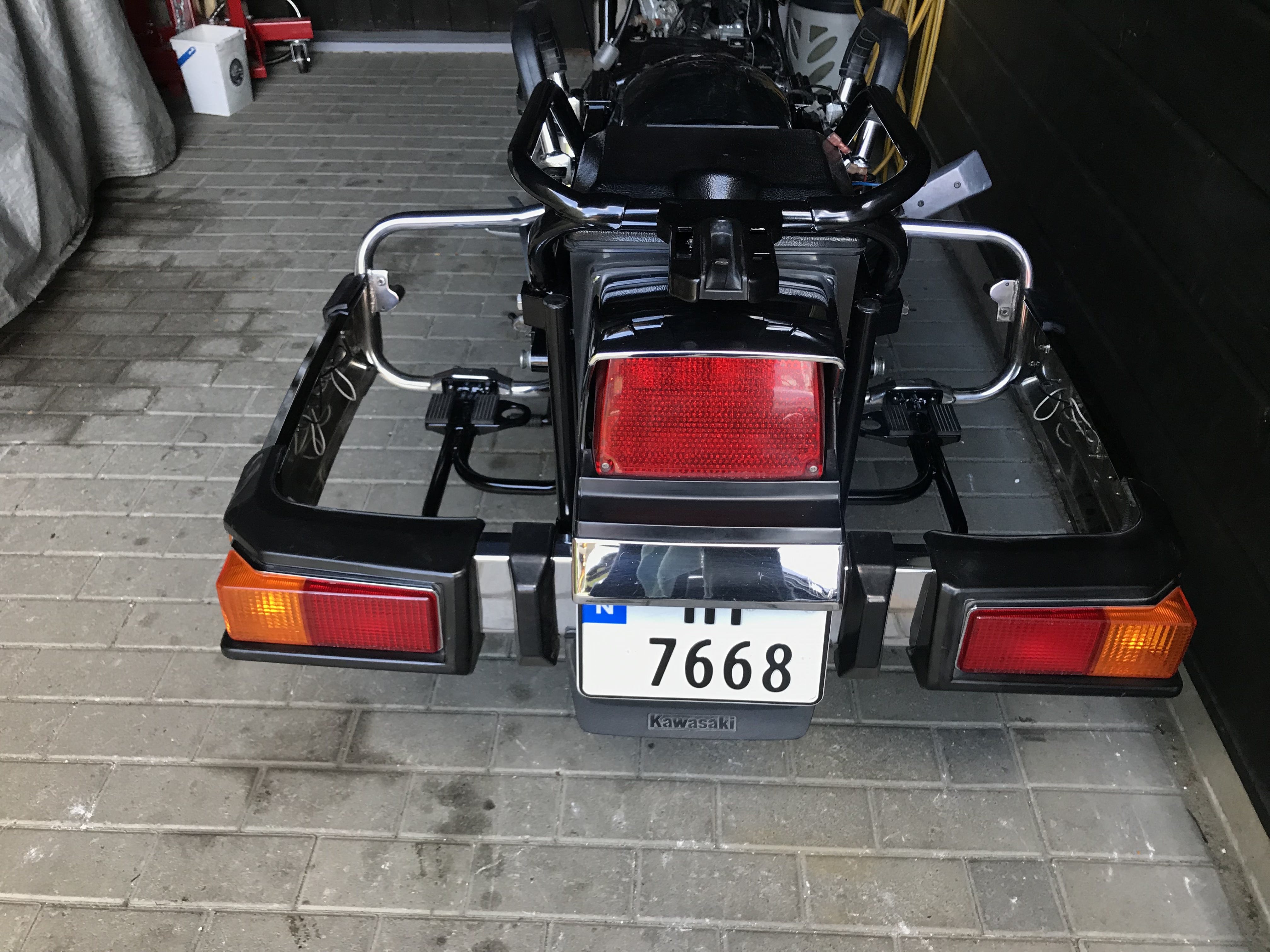

Some progress on the bike: Mounted the powder coated parts and half off the engine back in the frame. The engine was hard to put back, because there was little space between the engine and the propeller shaft.

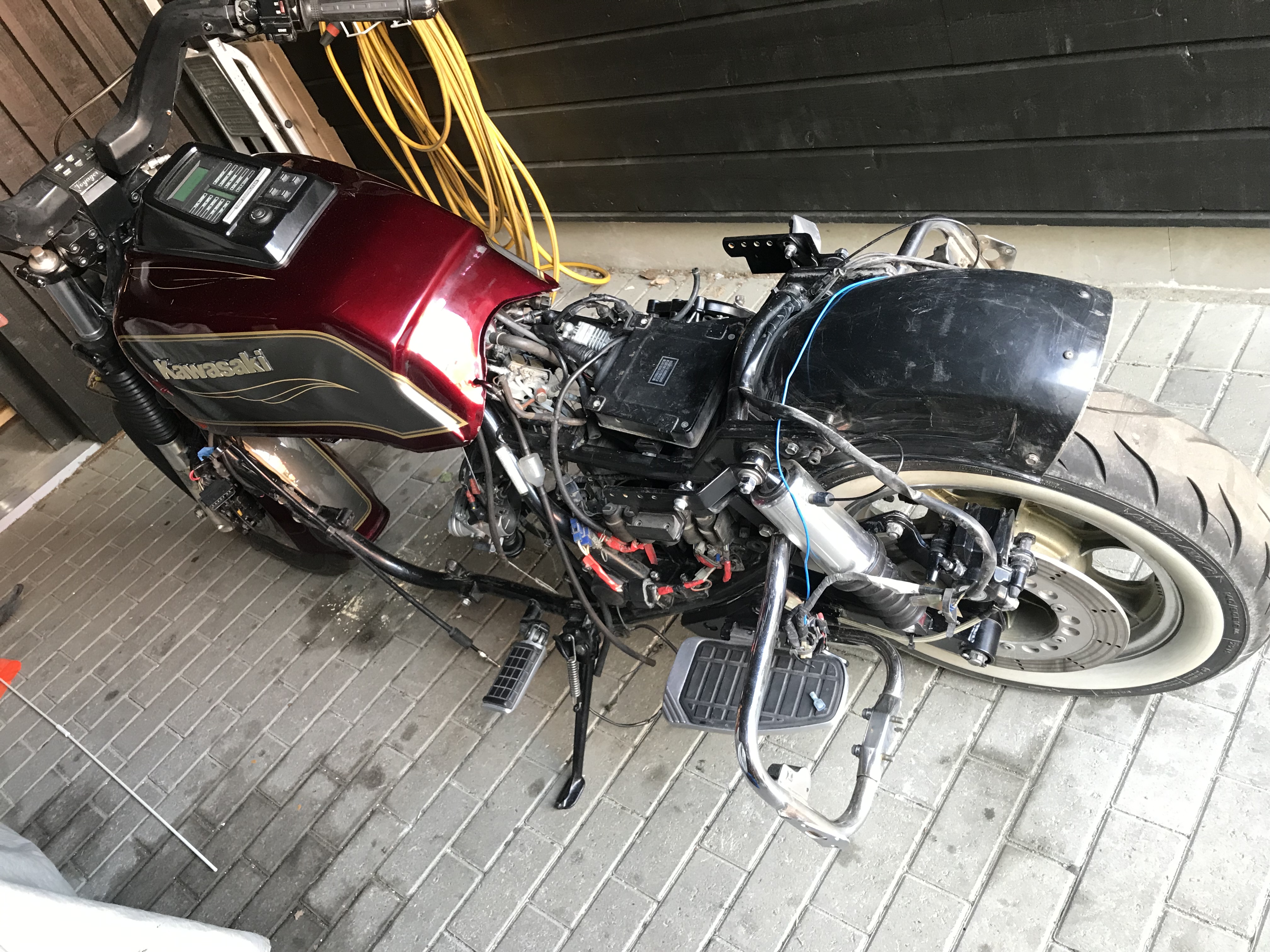

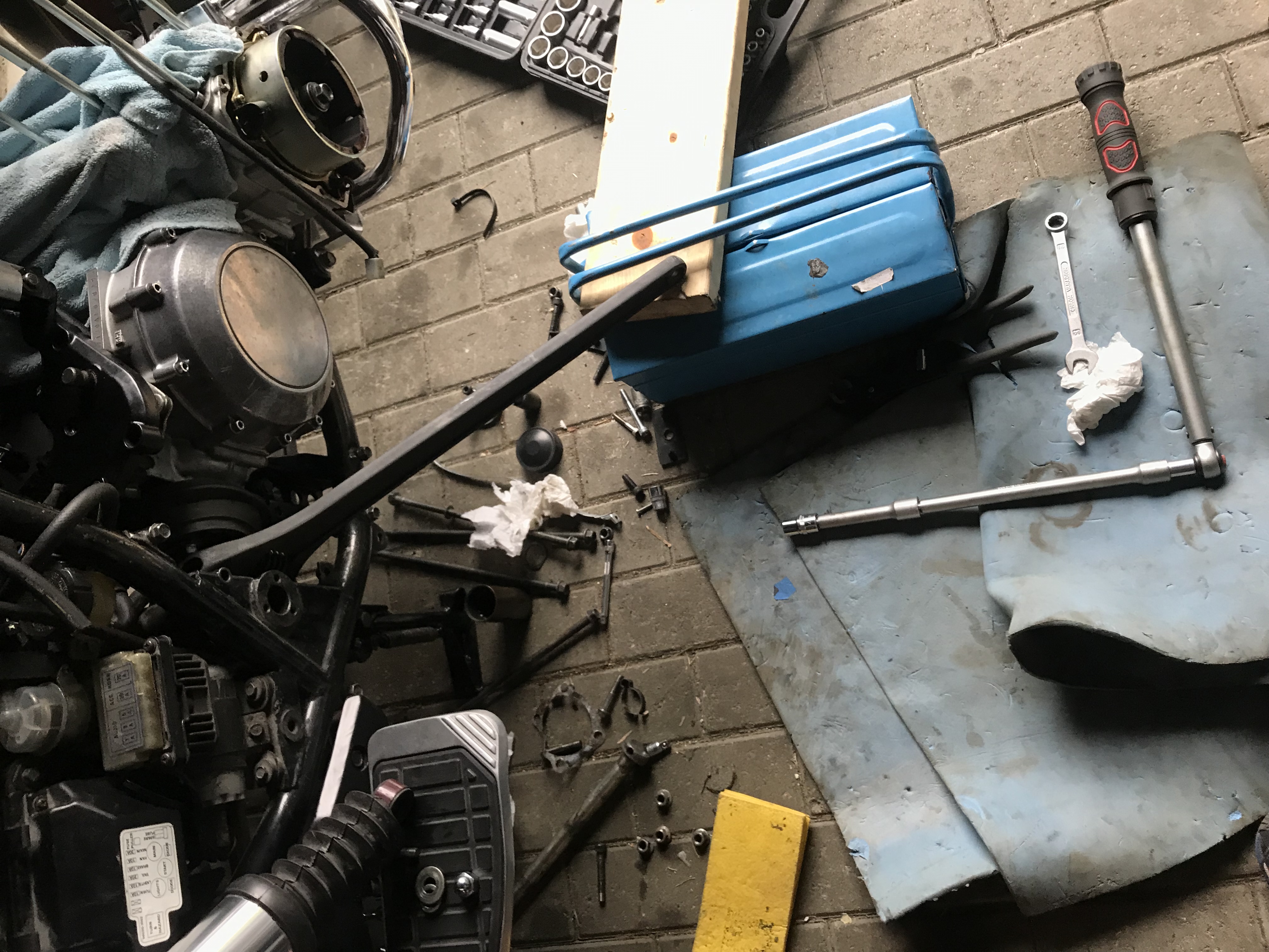

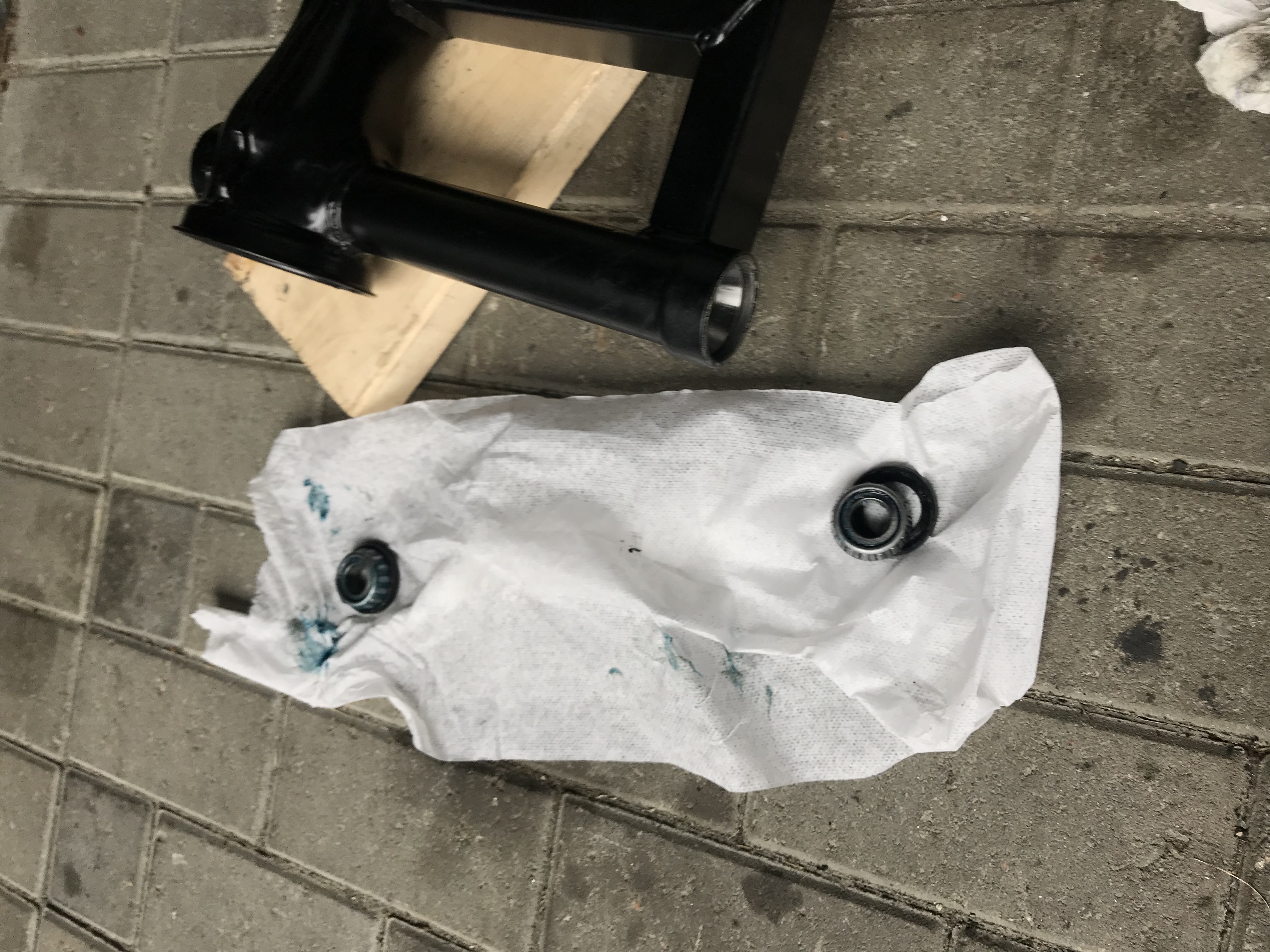

Hello. I have worked on my bike a lot, but it doesn’t look like it.

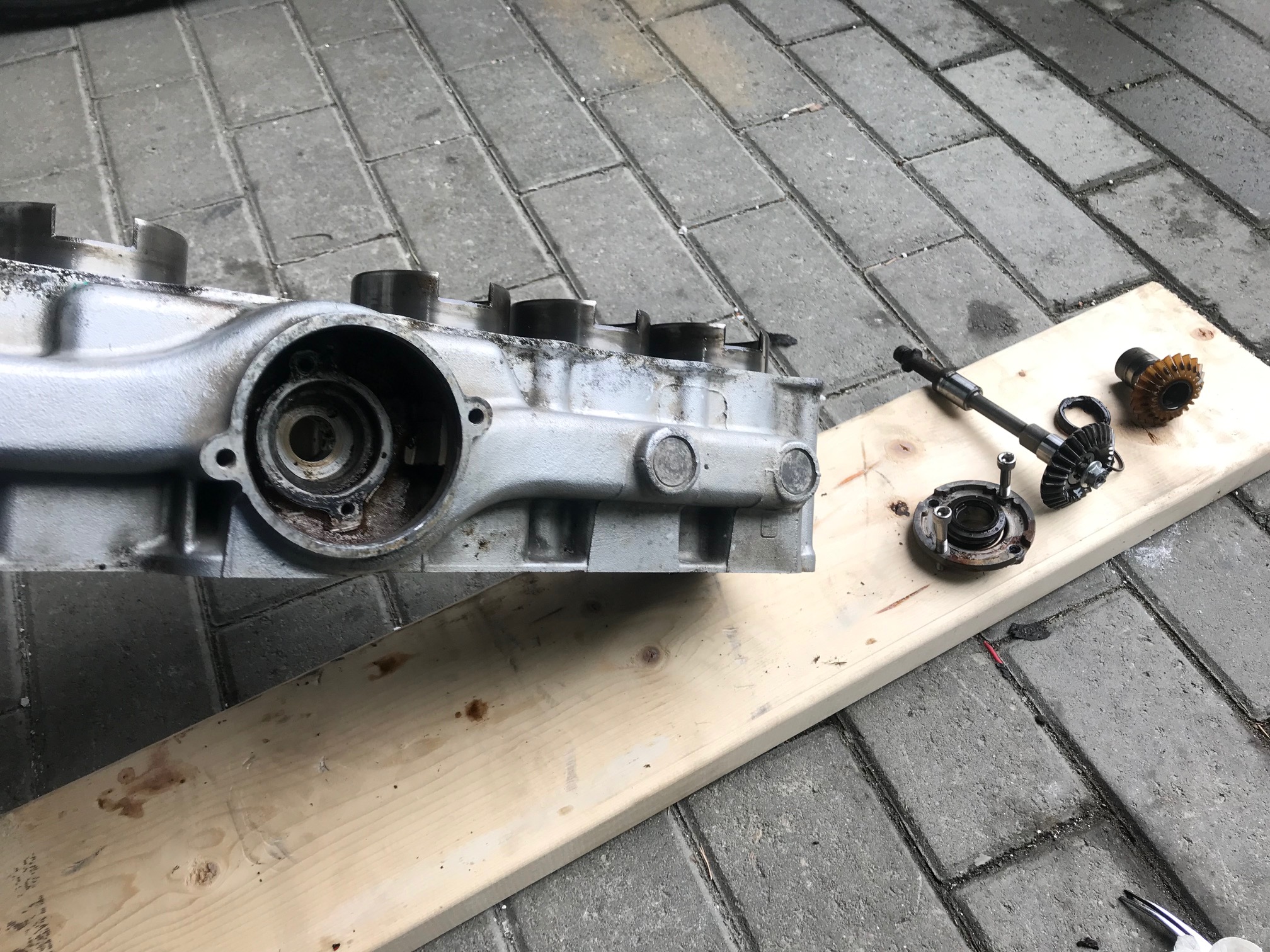

To get the right torque on the universal joint couplings bolts, I had to remove the swing arm (Should have done that earlier). At the same time I greased the swing arm bearings and the pinion.
I also change the final gear case oil and for a moment my heart stopped. Thought I tightened the oil filler cap to hard and destroyed the treads, but luckily it was only the ring at the cap itself that fell out. Have to buy another one.
I torque all the bolts as required in the manual.
Put the air filter back in, not sure if it can stay there when I put the cylinder head and block back in, will see. It’s so good to put things together again. See it become a motorcycle again. My plan is to ride this great bike in August. But now it’s soon vacation and a pause in this project.
