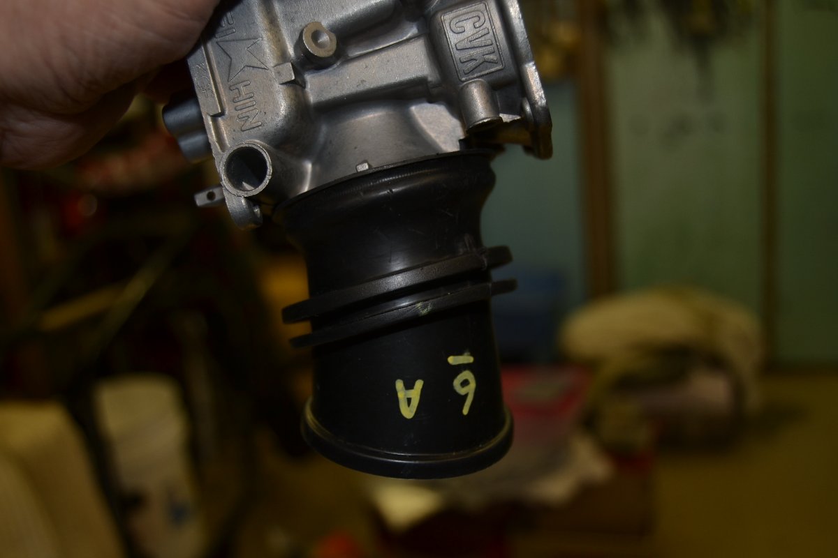

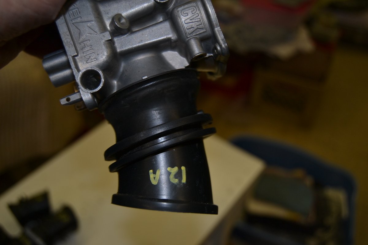

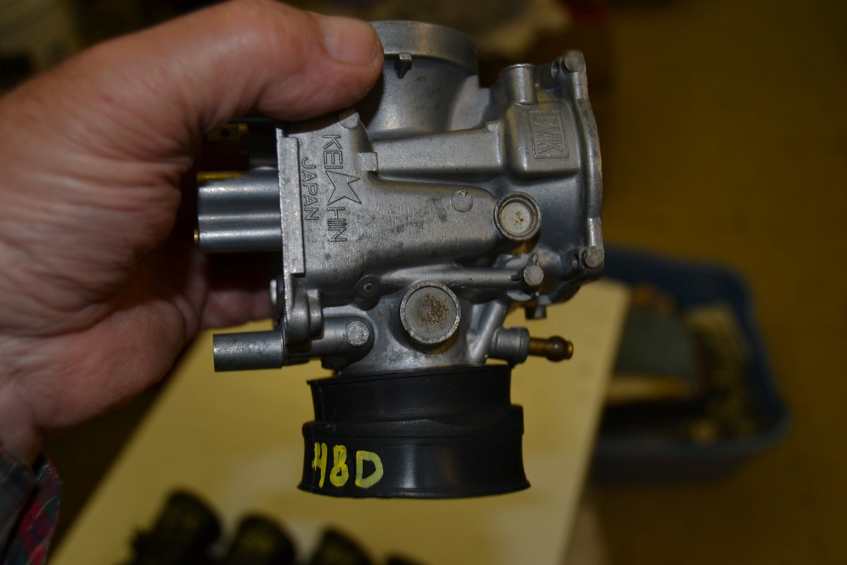

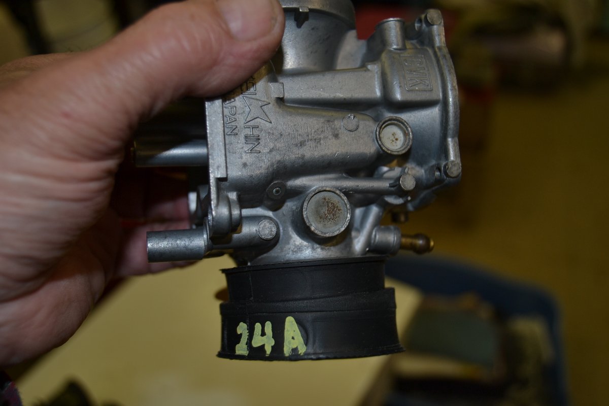

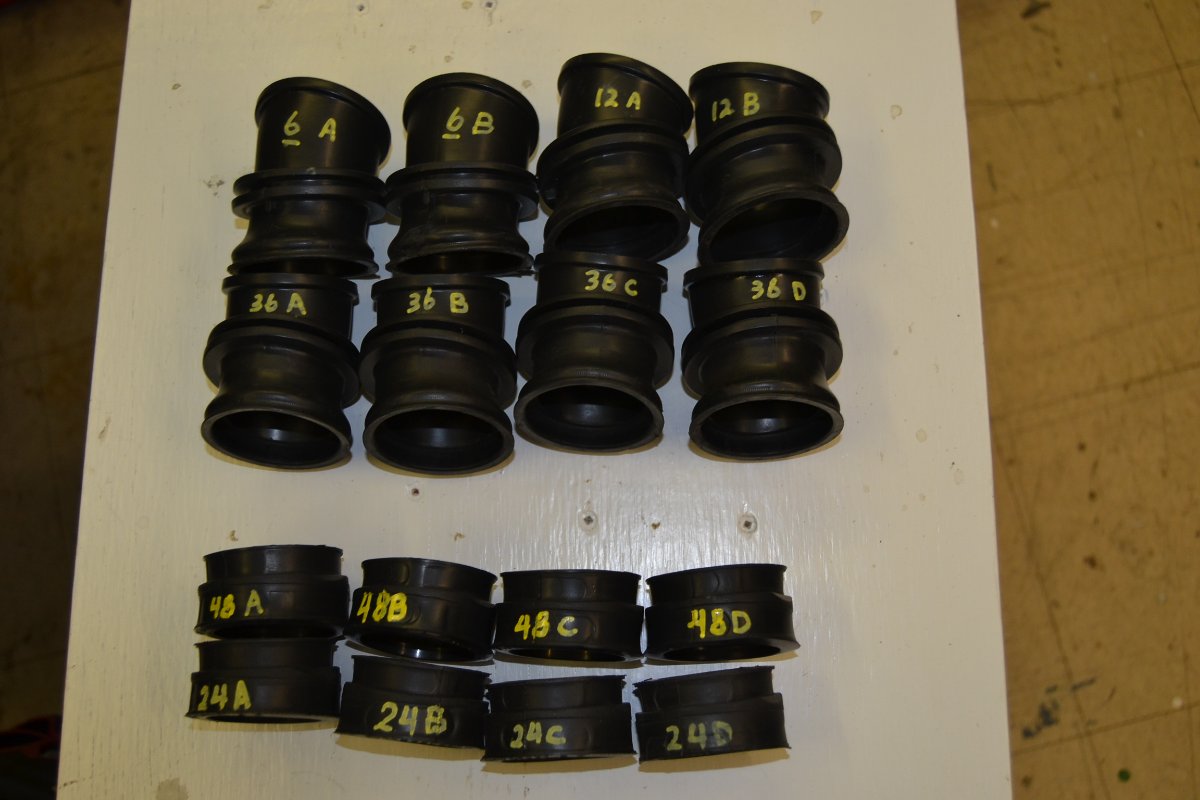

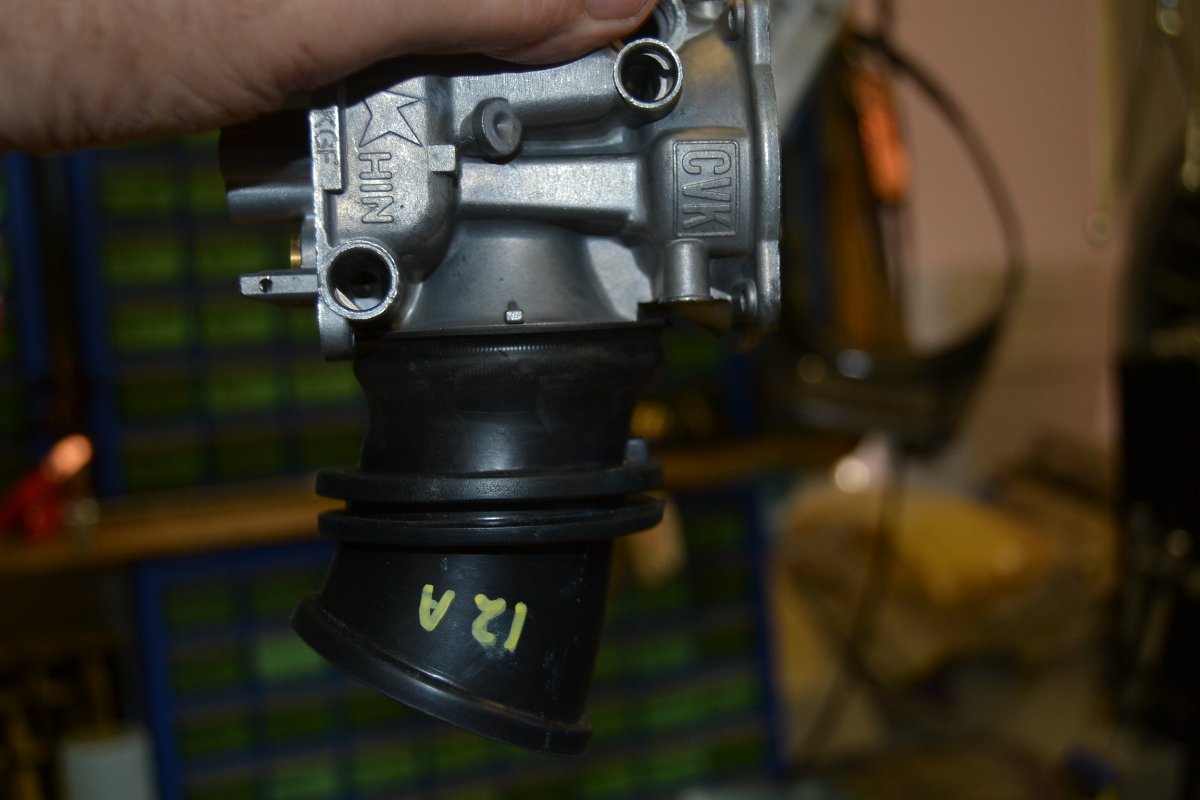

The results are in! I started with 8 hard holders and 8 hard deformed ducts and did 2 batches of testing. The first batch of 4 holders and 4 ducts were soaked for 24 hours, removed, soaped clean, rinsed and evaluated for pliability and swelling. Then the holders were immersed for a further 24 hours whereupon they were soaped, rinsed and evaluated again. The ducts only remained in the solution for a further 12 hours as opposed to the additional 24 hours for the holders. The results for the holders are given in my post of Thursday May 21st. As mentioned the ducts of the first batch were immersed for a further 12 hours due to the relative thinner cross section versus the holders. This gave the ducts a total immersion time of 36 hours. At this point the 36 hour ducts did not show any increase in pliability nor swelling as compared to the 24 hour immersion time. On to test batch #2.
For the 2nd test batch I immersed the remaining 4 control, hard holders for a total time of 24 hours only and found the results to be similar to the 48 hour immersion time: very pliable but with less swelling than the 48 hour holders. This seems to be the "Sweet spot" in so far as timing goes for the holders.
The remaining 4 control ducts were immersed and after 6 hours I removed 2 of the 4 for observation. They were very pliable and did not exhibit any noticeable swelling. After an additional 6 hours I removed the remaining 2 ducts and found no increase in pliability versus the 6 hour ducts, nor was there any additional swelling evident. So for the ducts 6-12 hours seems to be the ideal amount of time.
I have included some photos which show the holders/ducts after completion of this experiment. As well several of the photos show my"Drop test" for the ducts. One will notice that the ducts still hold onto the flange of the carburetor without the aid of the roll-up spring.
The holder photo can't show the fit onto the carb due to the external shoulder on the carb and corresponding internal divet of the holder interior passage. You will have to take my word for the fit: it was snug with all of the holders except for the one from the 1st batch.
The fit of the holders onto the cylinder head stubs was also checked and in all cases it was still snug, even with the holder from the first batch which was loose on the carburetor mouth flange.
So to sum up, the ideal time for holders is 24 hours and the ducts 6-12 hours depending on degree of hardness at the start. Anymore time than these suggested timelines is risky in so far as swelling is concerned, and there does not seem to be a corresponding increase in pliability. The one minor irritant in this has been the smell of wintergreen: it has penetrated the holders and ducts and I have had them outdoors to try and eliminate the scent. I'm sure it will dissipate with time.
