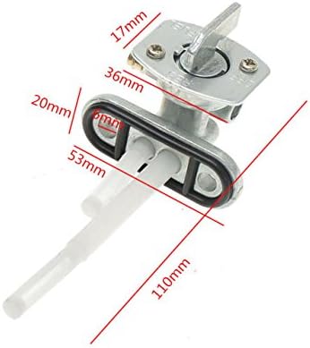

I'm pretty sure this will work, it's for a Vulcan 1500. I'll have to re-route new fuel line to connect to the side of petcock instead of straight out the rear directly behind the petcock like the original.

Here are some measurements I made of my tap. The critical measurement is the bolt hole spacing which I show as 43.5mm - not sure how accurate that is as there seems to be various taps at 44mm spacing. If you have your original tap, you should confirm the spacing measurement and check if the potential replacement has the same spacing.
Edit: if you can confirm the OEM bolt spacing (and any other measurements) and let me know, I'll update the drawing and repost (if necessary).
