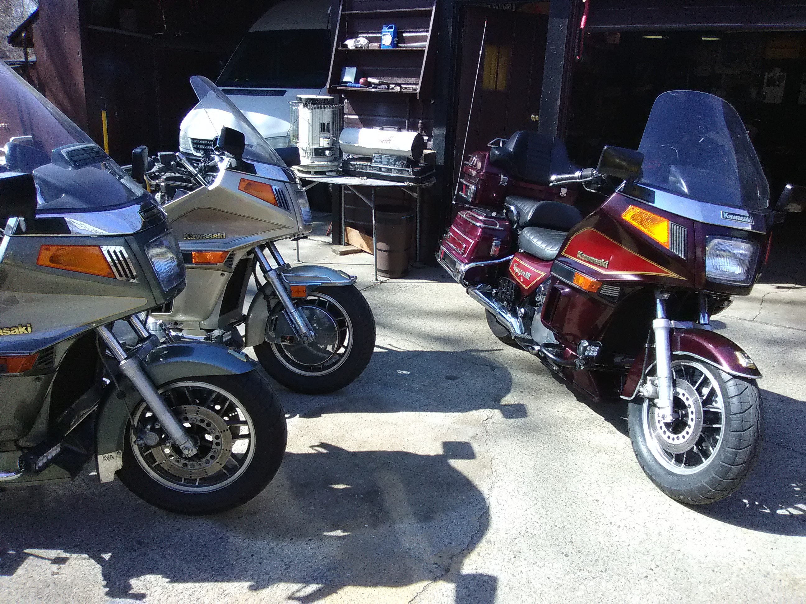

........I didn't have a bike to work on for a few days , after finishing my winter maintenance on my '03 and "88 XII's, finished my son's Z 1000 , chomping at the bit for new projects for after I get home from work , and weekends , ....so , I took a road trip from Toledo ,down to Columbus in the Benz....and got these 2 bikes ,neither bike ain't run in years ...$500...."I'll take em both" let's load em up !

Great buy Tony.
As much as I like the big XIIs I gotta say that the XS 650 was always one of my favorite Jap models having been weaned on british twins back in the mid-sixties. My first bike was a 1956 Triumph T110 which I got my license on back in 1966.
The 86 has a lot of rear end Markland bling which is a bonus, should one like that sort of thing. Hopefully it can come back from the sabbatical it has been on without too much effort.
These 2 should keep you busy for a few days, LOL.

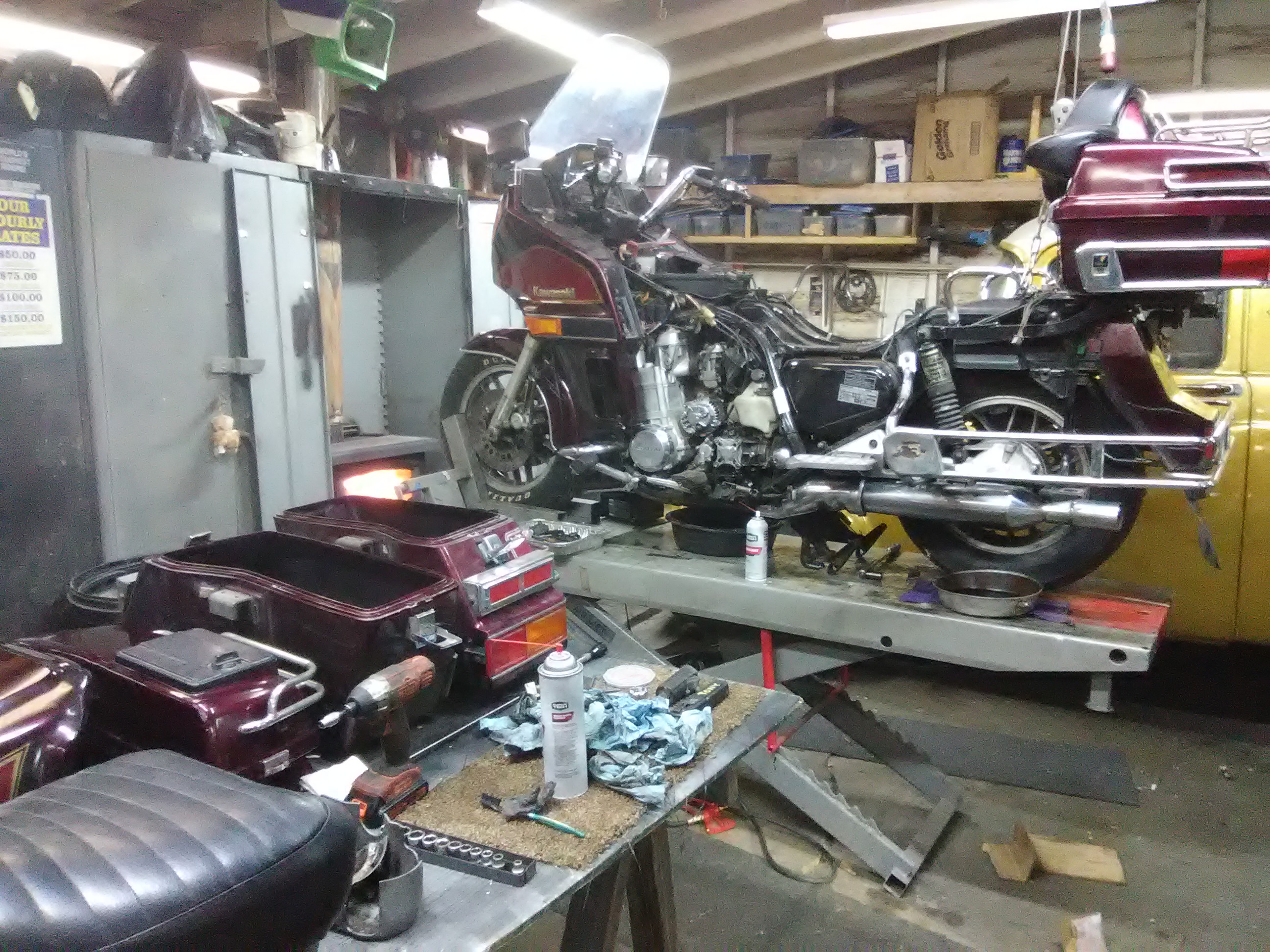

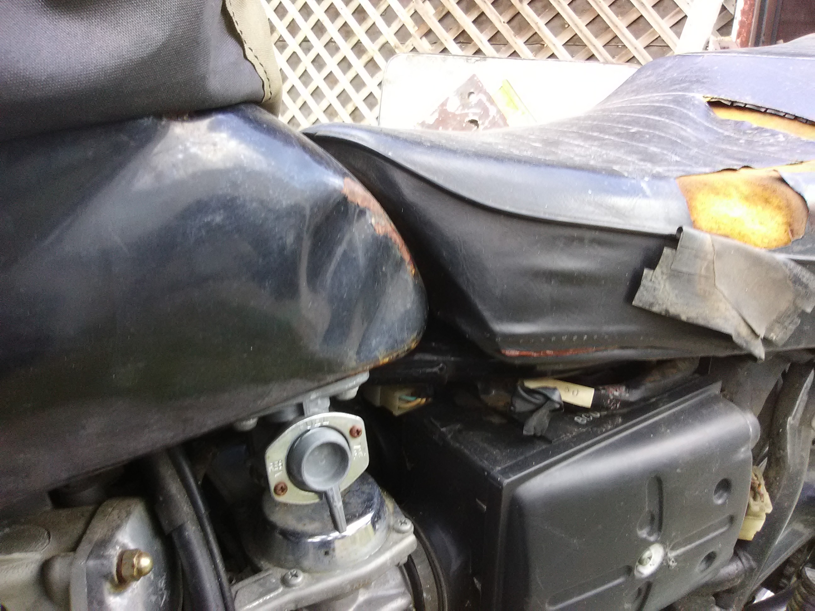

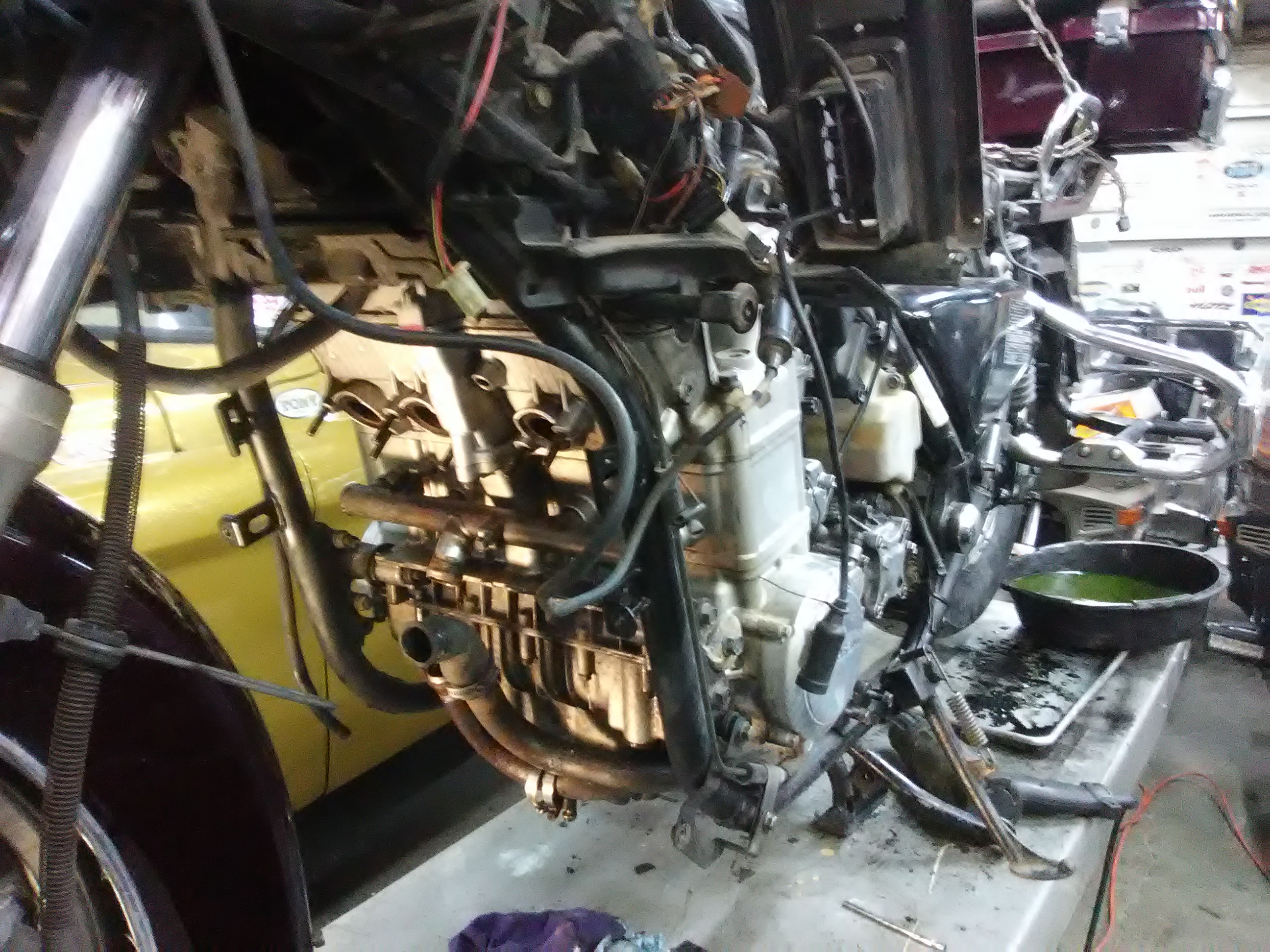

, The fun began as soon as I got the 2 bikes unloaded, rearranged things in my workshop, and got the 86' up on the airlift . Set up the saw horses,and made a parts table ......soon to be filled up ! . Nev er fails to amaze how guys let their bikes go for years , neglecting any repairs and maintenance. The P.O. told me he spent a weekend trying to get it running a year ago , I took my tools with me, and had her running in a half hour, took it for a short ride,but in less than 5 minutes I had to shut the bike off , fearing it would burst into flames , from decades of oil leaks on the exhaust ....talk about a cloud of smoke !
, Ive compiled a long list of repairs needed , and have already spent over $ 600. on parts, including a -1248 Igniter from Carl , ....things to do include : repair kits in the brake calipers(not releasing) , coolant manifold o-ring replacement , shiftshaft seal,replace , oil pressure switch replace,(these two parts were the source of the oil leaks), get the Clarion stereo working ( the guy said he disconnected it), replace spark plugs, service final drive, change oil and filter, install new front tire (the current tire, date code 1984),Get the charging system working , because the P.O said it does not work, I was shocked to see a new alt. installed when I removed the cover ! , install a new battery, And one heck of a good clean up ......and I'm sure there is some stuff I'm forgetting ! Hauling bikes in the Benz , is the way to go with the high roof ! no more taking off windshields and mirrors as done for the past 40+ years

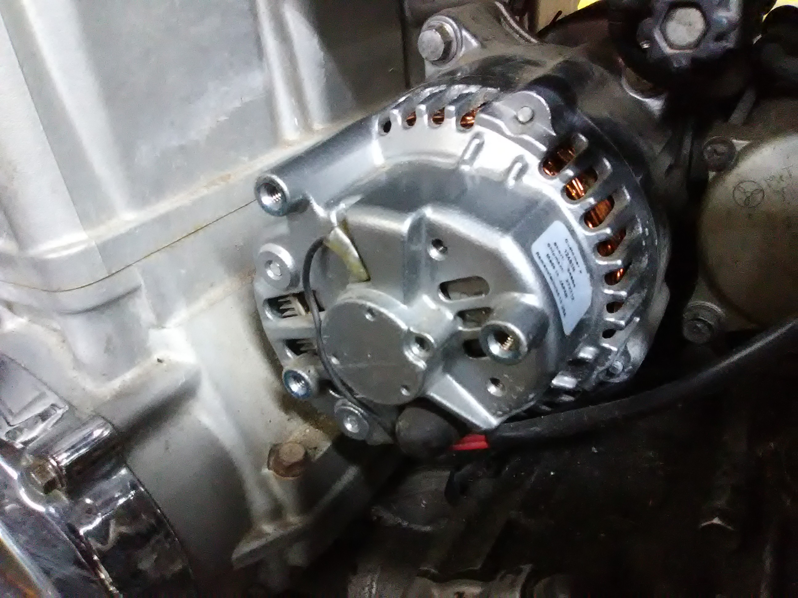

NEW ALTERNATOR? Bonus! And like you it never ceases to amaze me either about non maintenance owners. Oh well, more hidden gems for us.

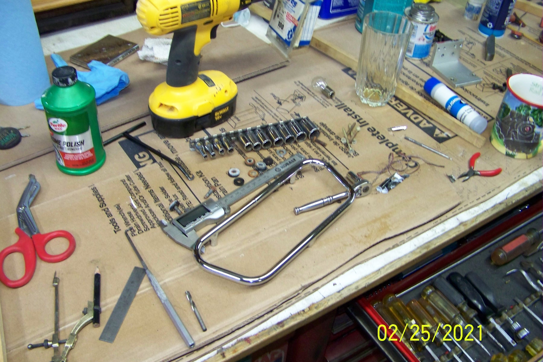

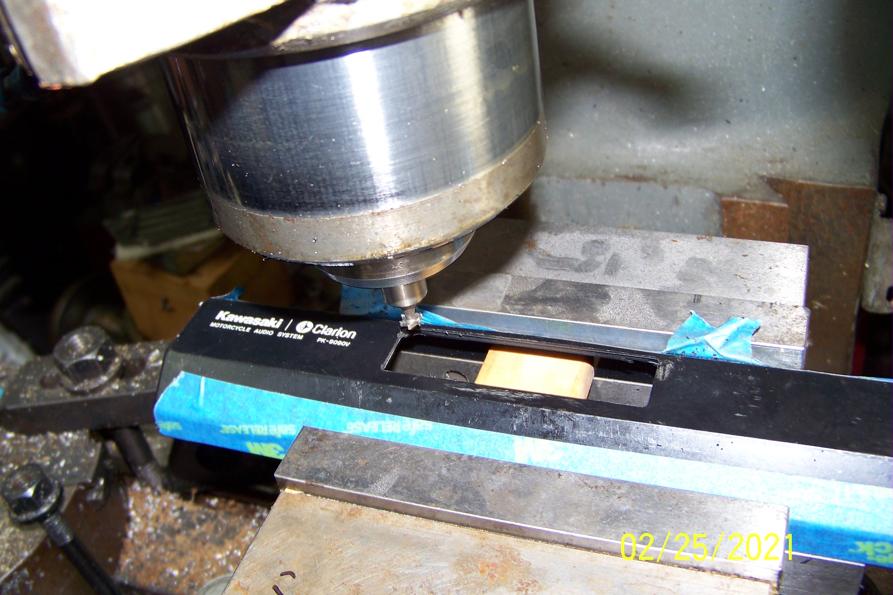

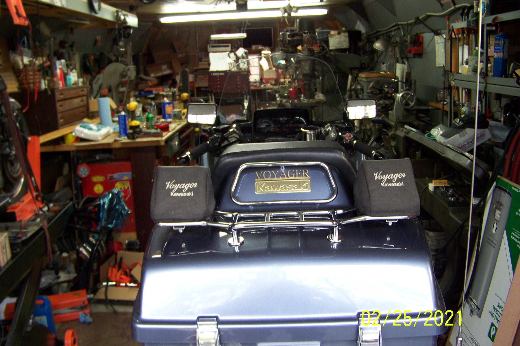

Hello from NJ. rainy damp day , but a good day to STAY BUSY in the shop. The last parts bike had this piece of bling on the trunk and after a few months outside in the rain , it cleaned up well. I am not one to like to drill holes in my bike but this was too good to pass.
With no dry roads , the radio cover ( window ) was finally done. I have had the clear poly for years. just never had the time. the inside is milled to fit the clear.
As Marie always tell me a , busy man is a happy man "

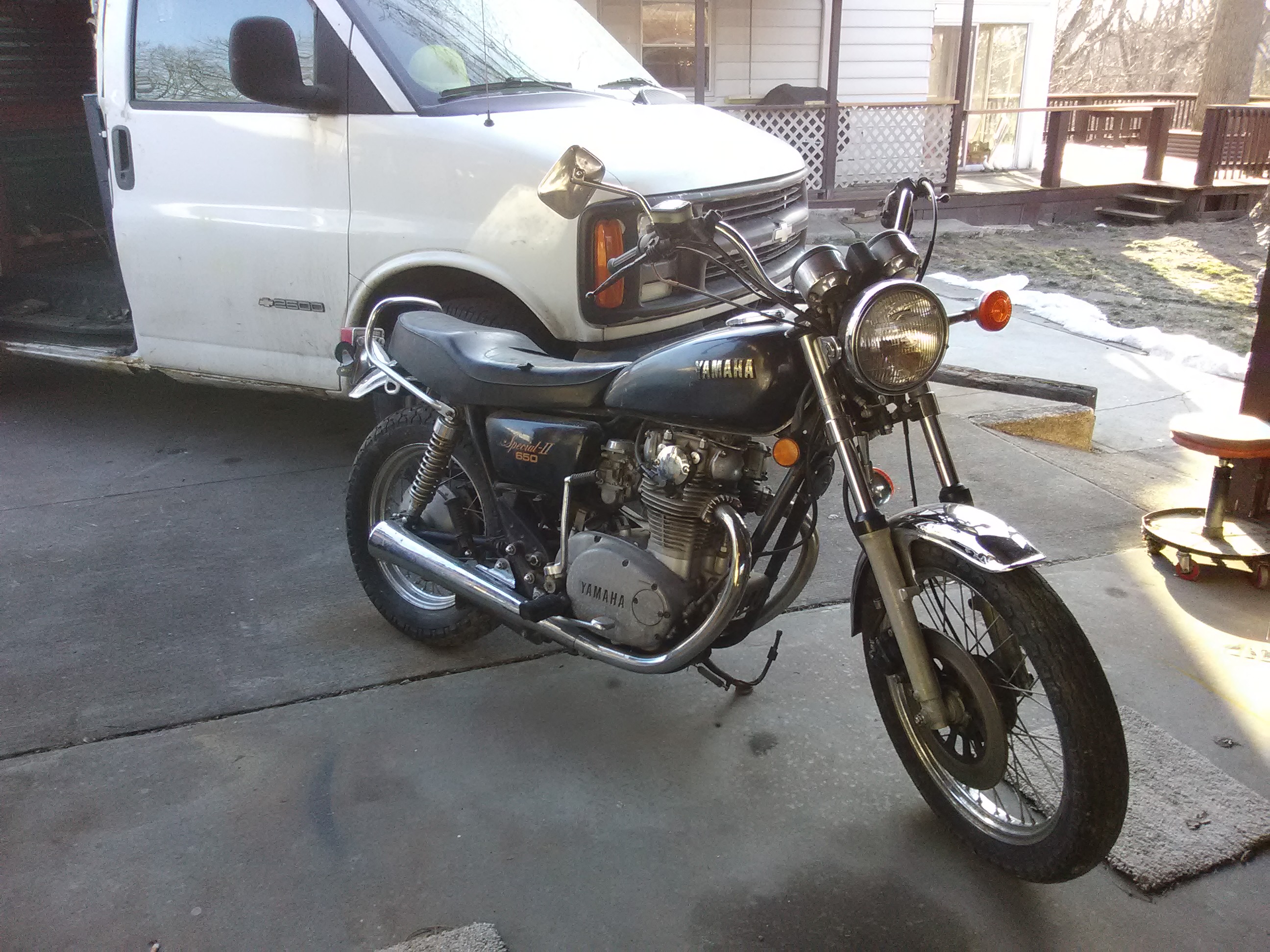

Been staying bizy completing the Yamaha 650 restoration , nearly done with it ....thought I would tell you all something that happened right near the end of this project......I have all the mechanical issues with the bike completed ,running the engine on my auxiliary fuel supply suspended bottle , so it was time for body /paint work on the damaged fuel tank ....after many many hours of work ...(not to mention the cost of epoxy paint and clearcoat) I whipped this tank into shape
, after dry time, I went to put the tank on the bike,,,,,,,,,,thats when I discovered that this is the wrong fuel tank for this bike !
, boy did I feel foolish ! ...a guy would assume that the fuel tank sitting on a bike , bought from a seller, was the fuel tank that this 42 year old machine always had ! nope ! so ,,,,to Ebay I went , and ordered the proper tank ....and started my body/paint work all over again !
The wrong fuel tank must be off a newer model ....it has a larger fuel capacity as you can see in the pics.......

Hey,Tony,I find,even at 72 years old,that I still have not learned that assuming something leads to embarrassment
That tank sure looks good though
