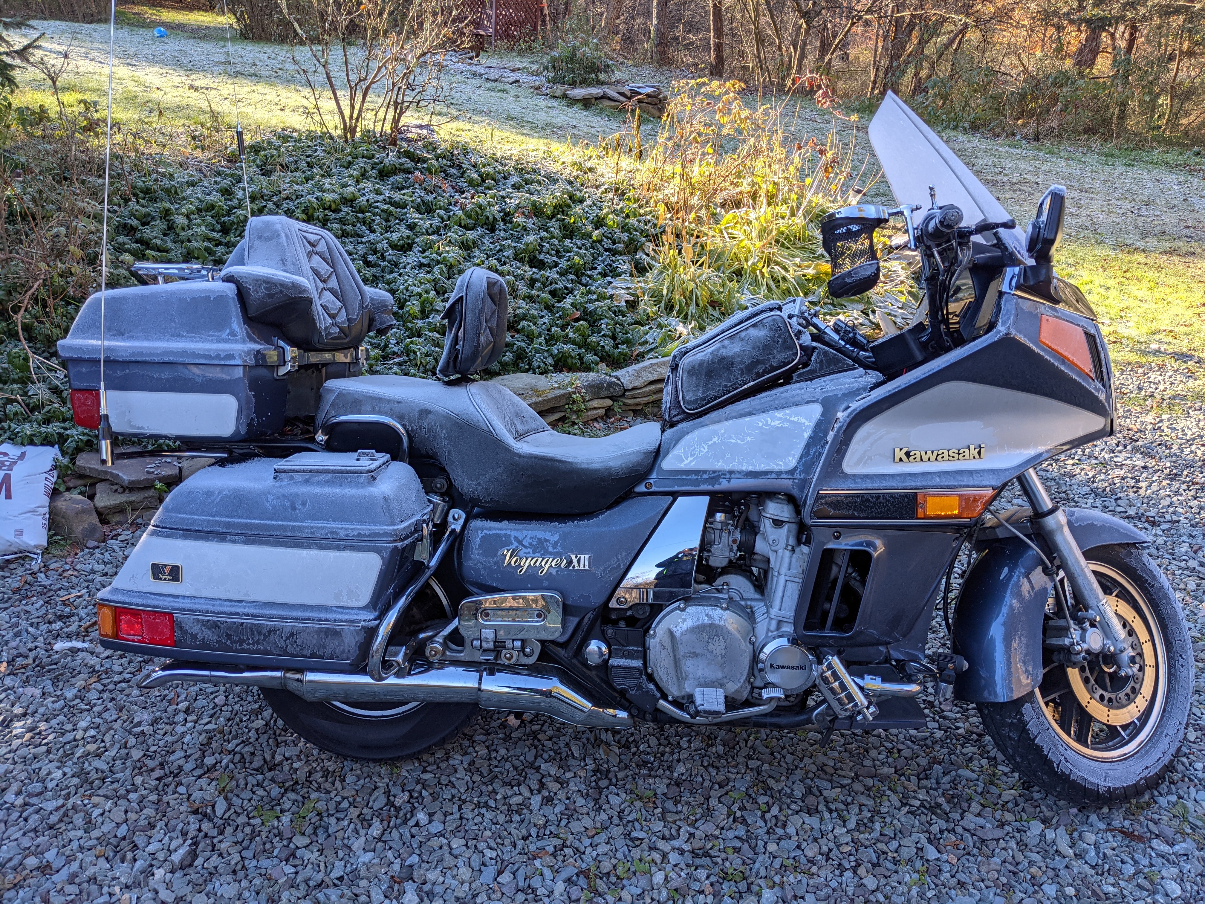

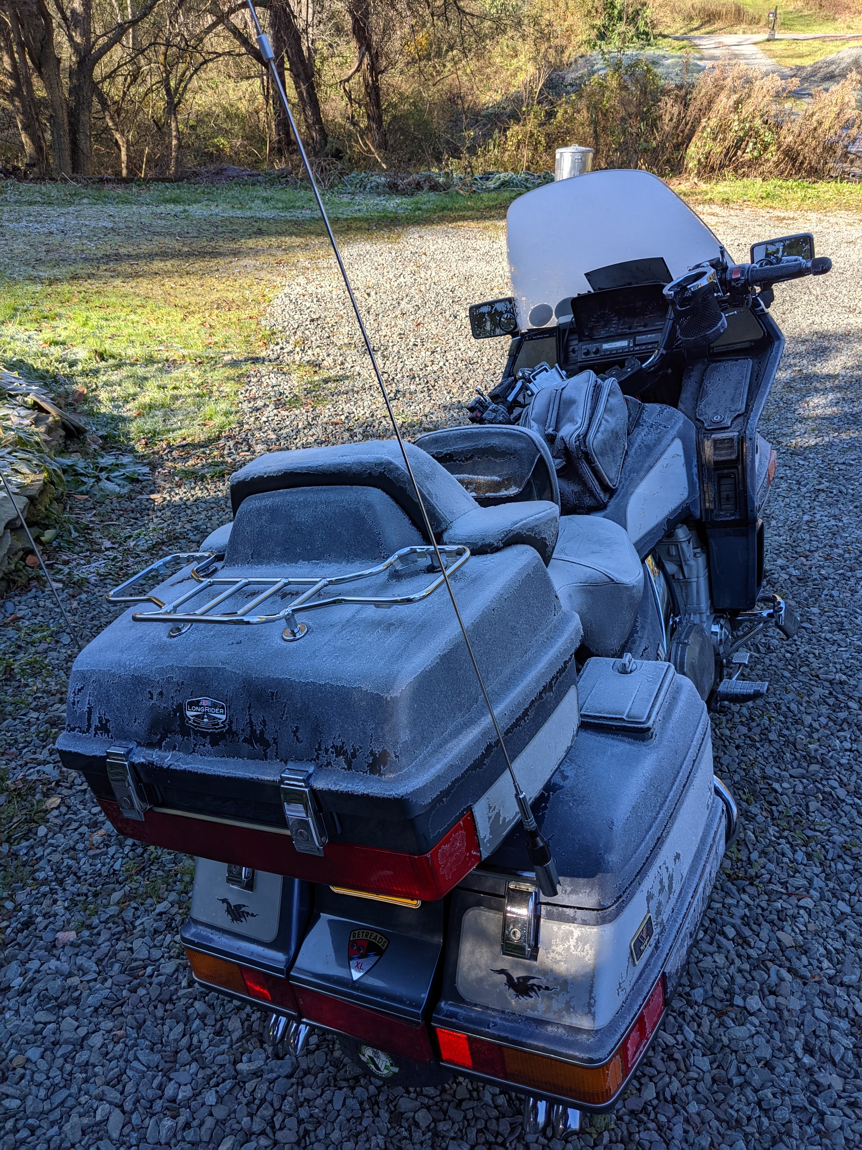

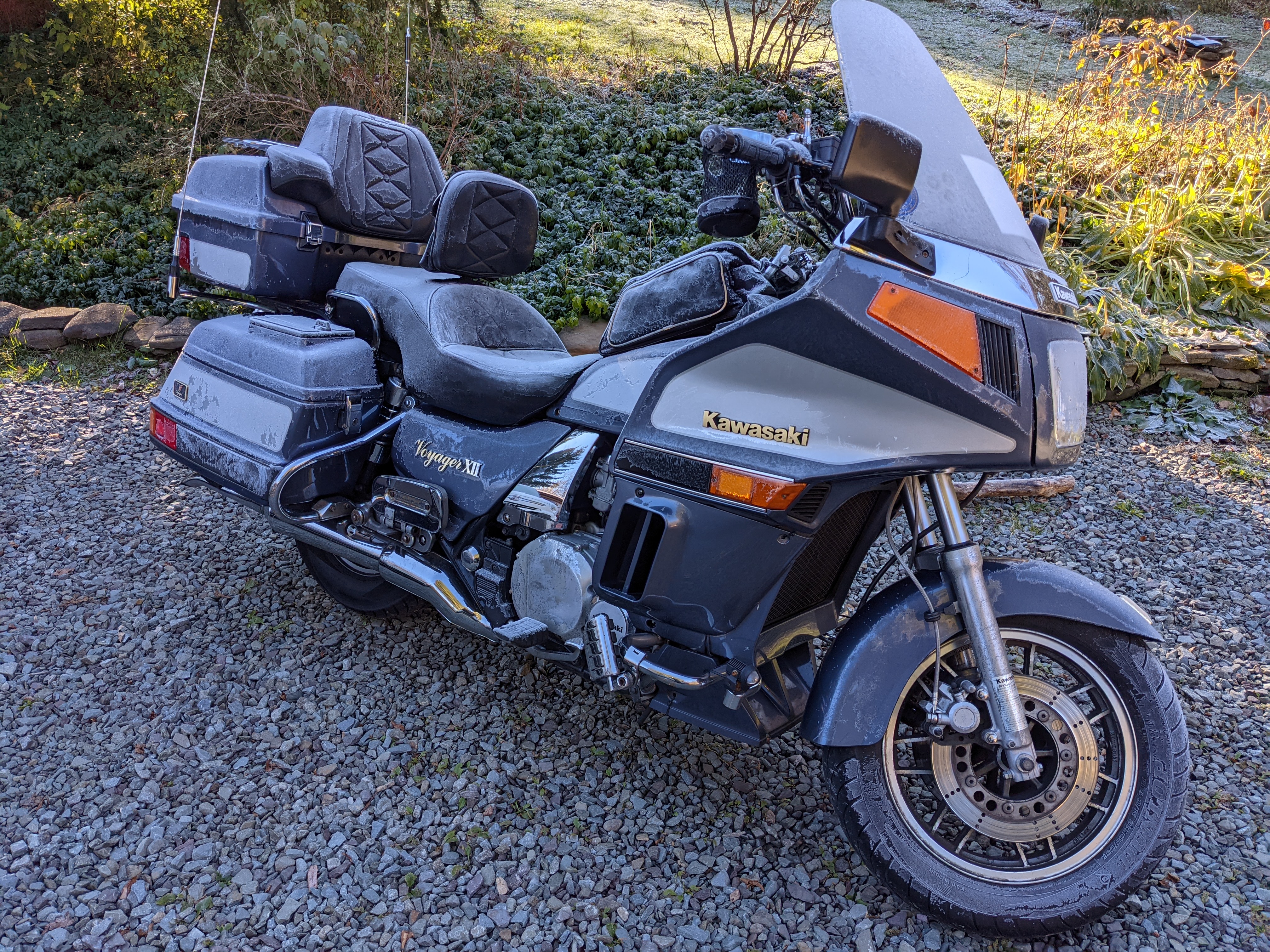

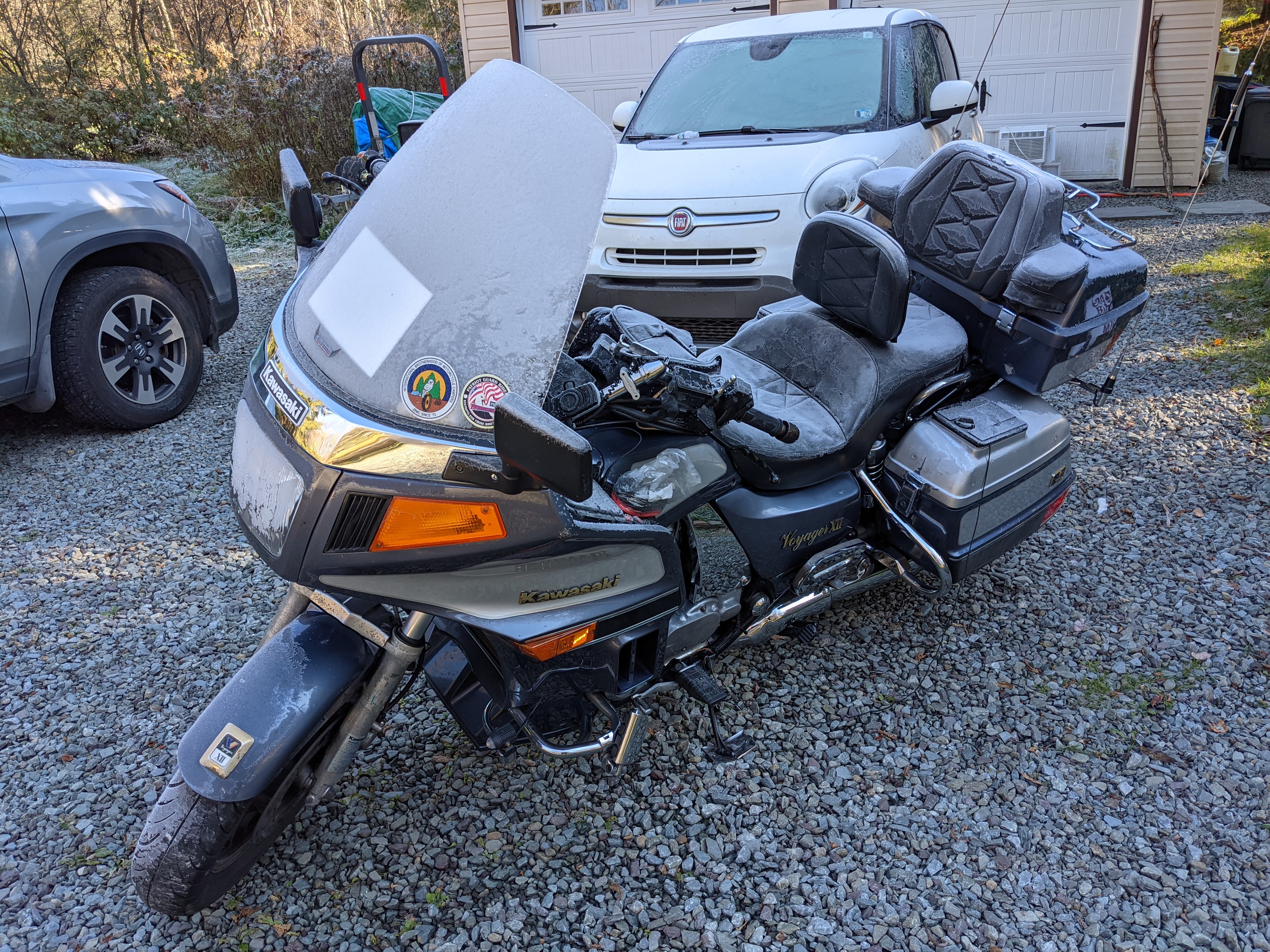

Went to visit a friend in Far Northeastern Pennsyltucky a couple of weekends ago. This is what I woke up to:
Scraped the windshield gently with a credit card. Turned on the seat heat. All was well.- These users liked GrandpaDenny's post:
