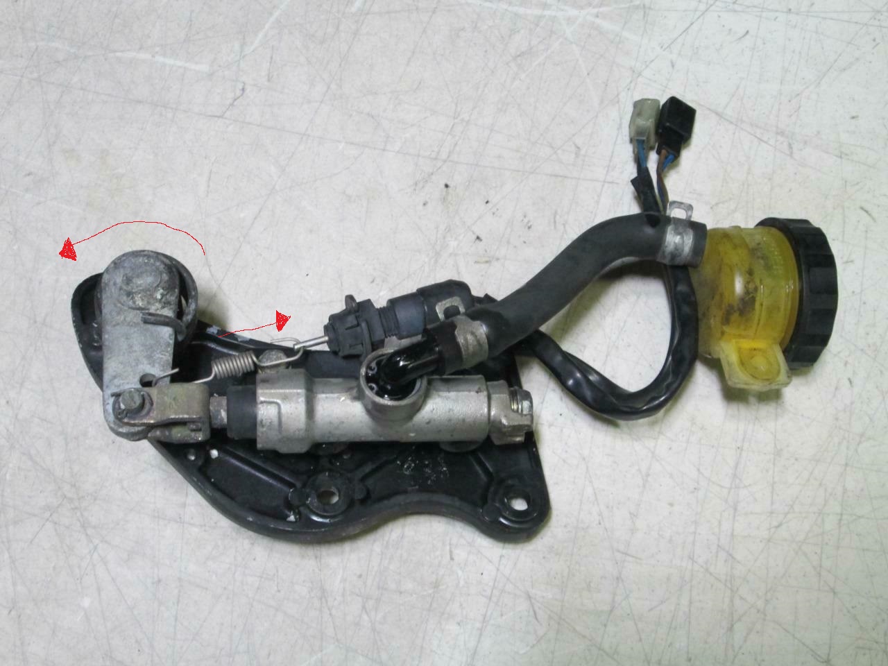

For what it's worth; the 2 red arrows show what happens when one depresses the rear brake lever: the plunger goes INTO the switch body to close the circuit. This is opposite to most rear brake switches.

Those contacts behind the cover are Normally Closed and they are for canceling the cruise control, If your lamps work with the front brake switch then look at Triton 28's picture, that is where you find the rear brake lamp switch. Perhaps the wiring plugs got pulled off or the spring or link is missing or broken. Or the switch is out of adjustment or just bad.
