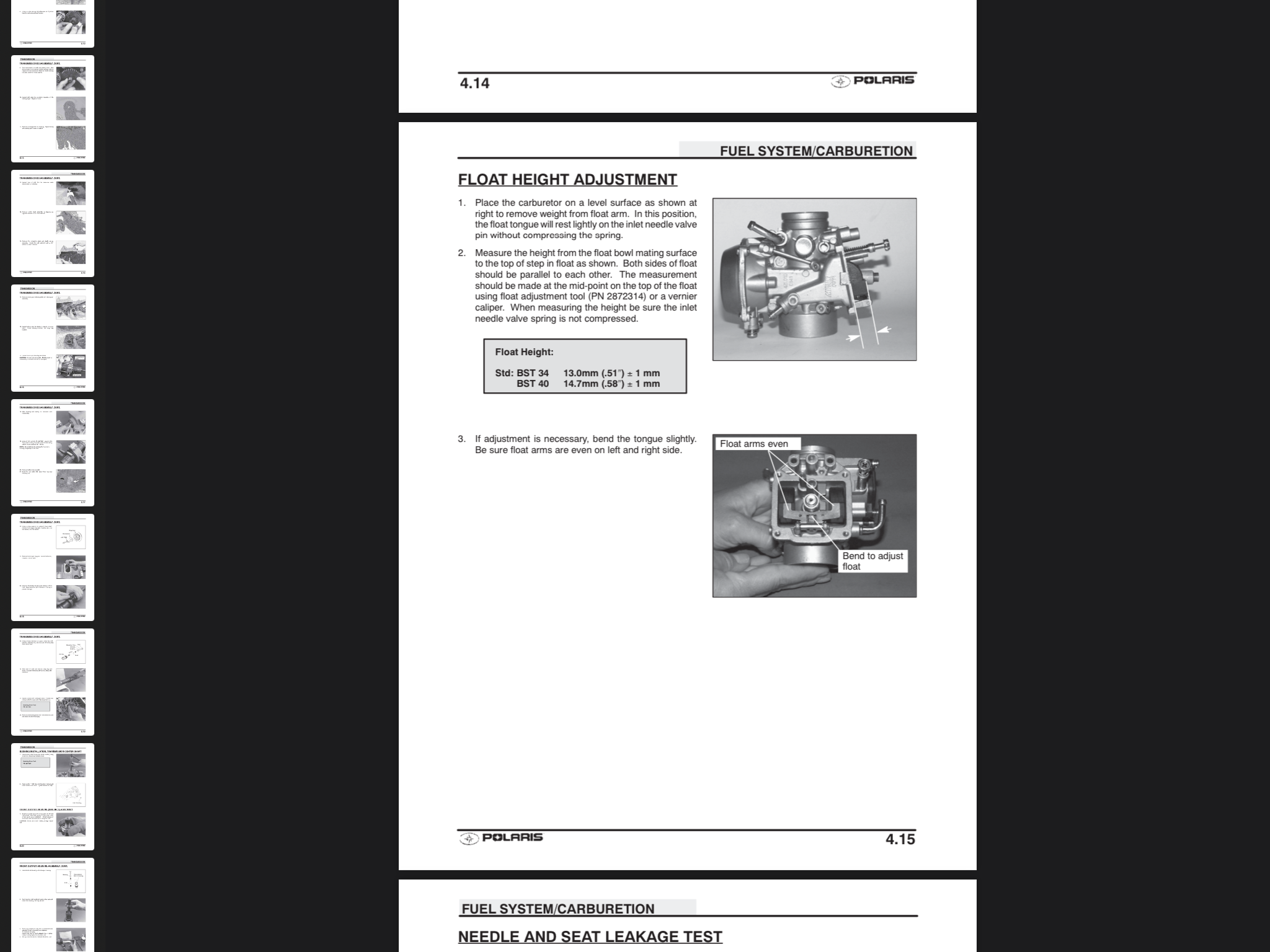

Recent conversation in FaceBook has been about if the angle of the carbs makes a difference when setting the floats. Some have mentioned that once they took them "off-level" then set them, that there were no further problems with fuel levels bouncing all over the place.
The Manual does not state, in text, the need to angle the carbs when setting float levels BUT the figure shown on page 2-10, DOES show the carbs at perhaps a 15 degree angle, front down hill.
To that end, has anyone in here set theirs while angled (not level)? I've been setting mine while level and the measured fuel levels bounces wildly around. It would be easy for me to modify my work stand to make this angle happen.

Many float needles have a rubber seal at one end, and a spring loaded pin at the other end. (Not positive if voyager XII carb float needles are this type) In this case, One of the keys to setting the float height properly, is to have the needle all the way seated, but to NOT have the spring loaded pin at the other end compressed when measuring the float height. Depending on the weight of the float, on some carbs, turning the carb vertically upside down, is enough weight on the spring loaded pin to compress it. If you measure float height with it compressed, your measurement will be wrong by a significant amount. The way to avoid doing this, is to angle the carbs away from vertical enough to take enough weight off of the float needle to uncompress the springed pin. You can see visually whether it is compressed or not. Measuring float height at this angle of carb orientation will give you a correct measurement. IChris Cochran wrote: ↑Fri Sep 30, 2022 12:51 pm Recent conversation in FaceBook has been about if the angle of the carbs makes a difference when setting the floats. Some have mentioned that once they took them "off-level" then set them, that there were no further problems with fuel levels bouncing all over the place.
I always angle the carbs with spring loaded float pins until I can visually see that they are uncompressed.

The Manual needs to be re-written to more intelligently address this point. There is zero written text stating to angle the carbs. Only the figure shows them angled.
Today I'm going to get out my miter saw and cut some wedges, then move my now vertically mounted carb mounts to the new horizontal (with angled wedges) one.
I don't know if I'll ever be able to tell if the hangers are compressed or not as my eyesight isn't what it used to be. I did get a nice magnifying glass so maybe that will tell the tale.
I had gotten fatally frustrated with these things but now my curiosity about this is overpowering that frustration and I want to see if it works.
