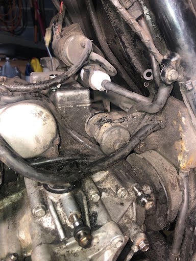

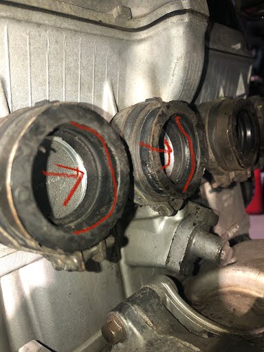

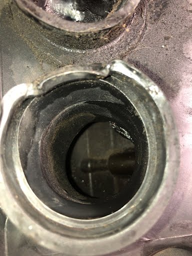

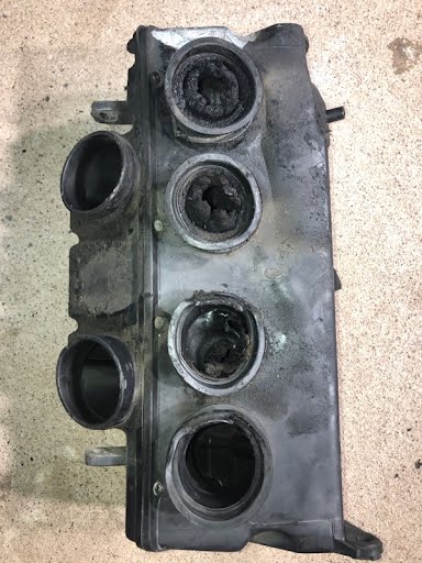

Finally getting the new carbs put in. Guess what we discovered when we pulled the lower airbox? Was hoping to get her done over the weekend, but need new carb boots, they should be here Thursday. Think the new carbs, new boots, and a new clean airbox are going to make much of a difference? :rolling:

How did it even run with all that crap,in there :hmm:

What is DSPO? And what is that crap in the airbox?

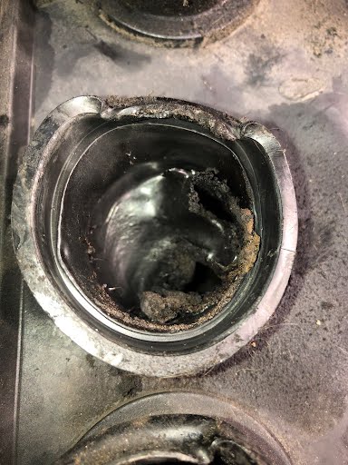

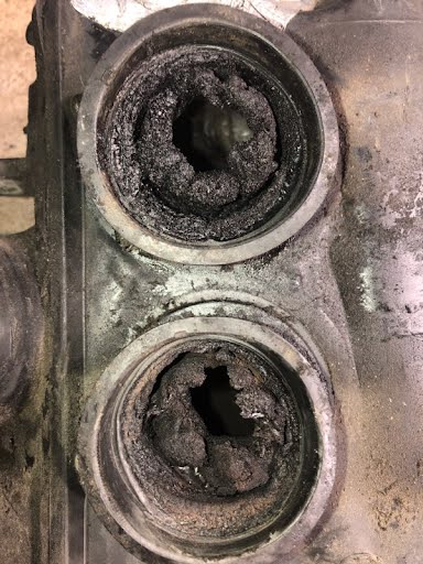

Nails wrote: Sun Mar 19, 2023 8:35 am What is that crap in the airbox?
Only the gods know, and I'm afraid to ask. Looks like plastic, oil, sludge, dirt, gods know what. I can just imagine what the carbs look like. Maybe I could send a sample out for analysis and we could do a pool, like an anchor pool or baby pool or football pool, to guess the exact composition.

GrandpaDenny wrote: Sun Mar 19, 2023 5:15 pmLooks like plastic, oil, sludge, dirt, gods know what.
I'm having trouble figuring out how all that kind of crap could possible get into the airbox. Seems like an interesting clue to a seriously weird history.I thought at first that the boots had somehow melted -- without burning up the whole bike. I've seen blow-by oil and grit, but nothing like that. Some kind of foam substance sprayed into the air filter box?

Nails wrote: Sun Mar 19, 2023 9:06 pm
At some point before I got her the lower airbox got melted - there was a large hole in the corner. It's covered by the silver metal tape you see in the photo of the entire airbox, at the top.
The clearer ports are the ones where the boots were folded over. That one looks like black plastic covering the port, doesn't it?
For all I know, this is what DSPO looks like.
Indeed, but in this case it's also got a lot of Procrastinating DS Present Owner. The airbox was holed when I bought her, as I discovered at some point after purchase, I think when I replaced the fuel filter. No, wait, that's when Gene covered the hole with metal tape. Before that I had it covered with electrical tape (hey, I used to be an electrician, I still use electrical tape for everything except what I use duct tape for!). Remember I've put 48000 miles on her since I bought her. In three years and 4 months.

I went to visit Gertrude in the hospital yesterday when I dropped my mechanic off at his house - he's letting me borrow his car to go to work. A few interesting observations:
- The old carbs don't look as bad as one would think. All the slides move freely, not a bunch of crap in the venturis.
- The mess in the airbox ports? Melted boots. Not oil and dirt. Confirms the "fire in the airbox" theory.

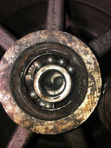

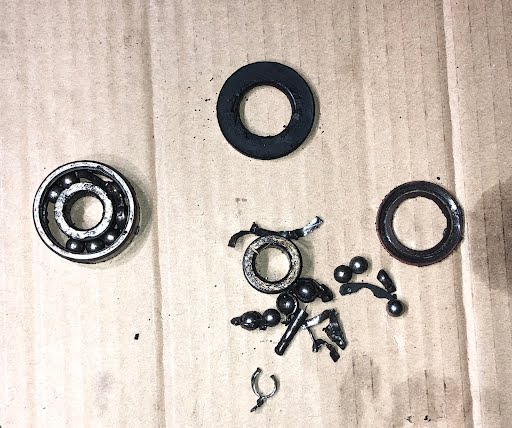

Wheel bearings were destroyed. That's probably what ate the forks. When I had the rear tire installed in June I asked them to check the wheel bearings, they said the bearings were fine.

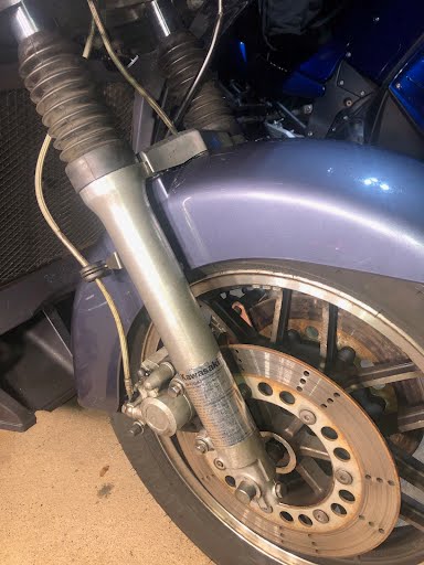

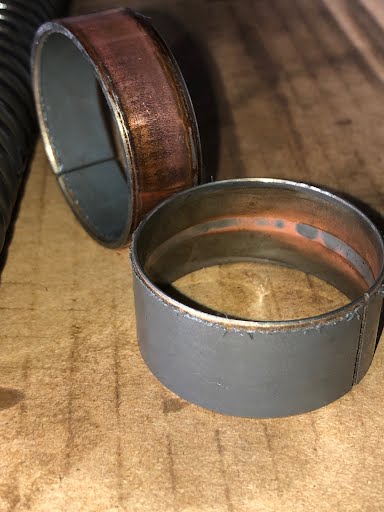

Fork bushings after 102000 miles (assuming they are original, and no reason to except otherwise):

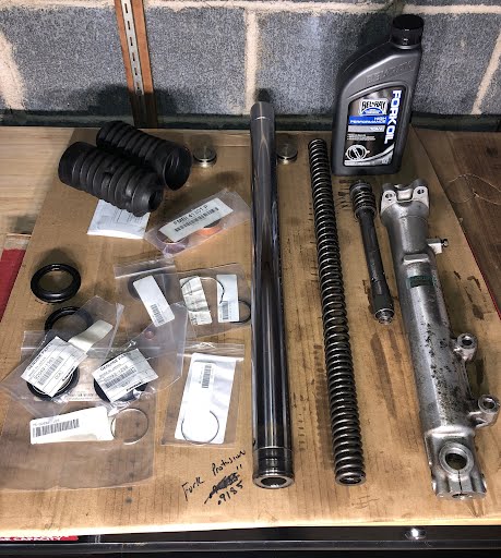

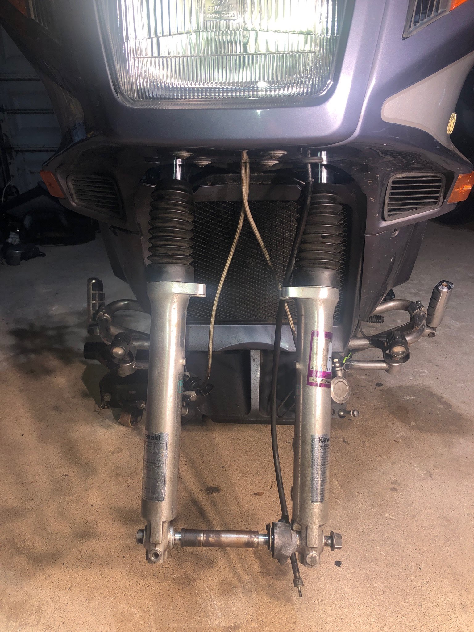

One fork, disassembled and cleaned for your viewing pleasure:
cushman eagle (Mon Mar 27, 2023 7:11 pm)
Posts: 1136
Has liked: 506 times
Re: Gertrude Goes In For Surgery
in the picture with the one fork (I believe it's the right fork), are all the rebuild parts for both forks, including, as you see, a pair of really nifty Kawasaki fork boots.
"Kawasaki fork boots for a VXII? Didn't knew there were such a thing". You're right, they are the boots from the old OEM rear shocks. Ain't dey purty?

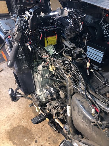

More pictures of Gertrude in surgery.

More information - looks like somebody had tried before, unsuccessfully, to remove the wheel bearings. 'Twasn't me. So that was at least 50,000 miles ago. Jeez. I'm on, I believe, my fourth front tire since I bought her. None of the dealership mechanics ever checked the bearings???? 130 bucks to get a tire changed and they didn't check the bearings????? :shock: :shock: :shock:

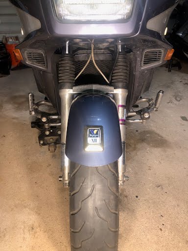

The reassembly begins! I'm so kronking excited. Newly rebuilt forks with Bel-Ray 15w fork oil. She's getting new front brake rotors, fresh EBC sintered pads, has new wheel bearings, man I'm stoked.

Progress report: Front end is complete. Rebuilt forks, new brake rotors and brake pads, and front wheel are installed. Tomorrow, the carbs and lower air box and syncronization and settings and tweakings and stuff.

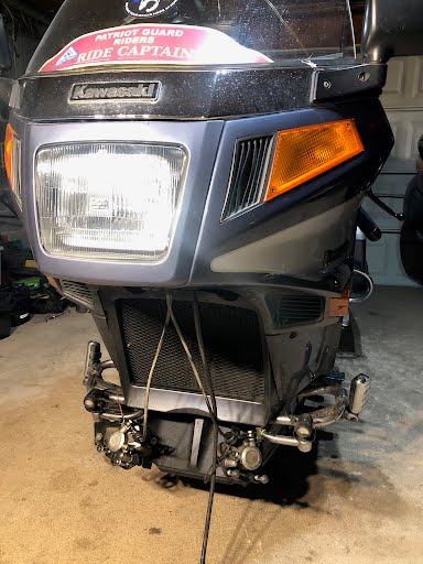

New brakes are on, wheel's back on, Gertrude's off the lift and on her own center stand. Carbs are being installed as I type. Discovered the carb-to-head boots for #1 and #2 cylinders (the ones that had the most damage to the carb holders (carb-to-airbox boots) are a little melted and rough and hardened but still usable, so not messing with them at this time. He's got a valve job on another bike to do and I need Gertrude.
He's texting me right now pissing and moaning and bitching and fessing about getting the carbs, boots, and airbox all lined up LOL.
Here are some pics, including the brand-new fuel filter. So easy to get at with the airbox out of the way.
