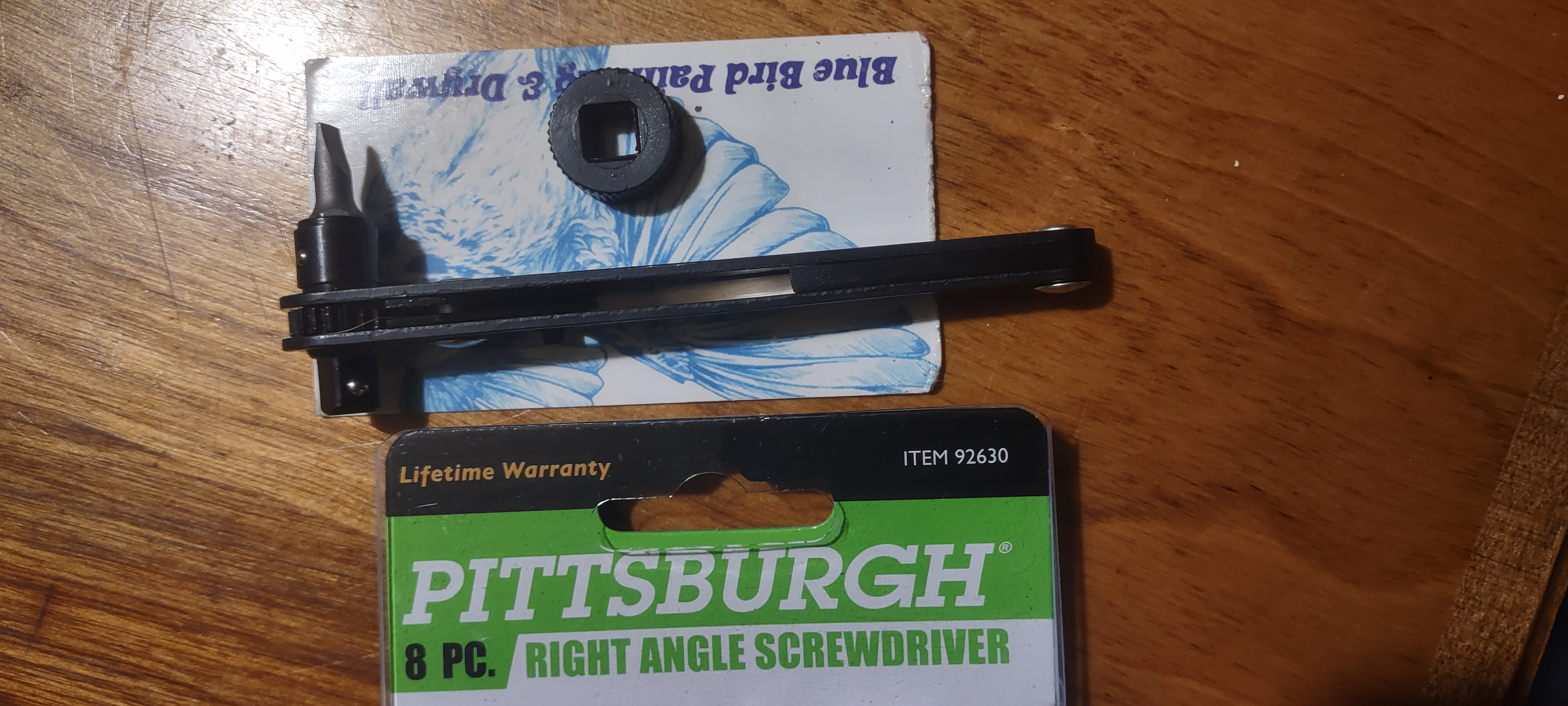

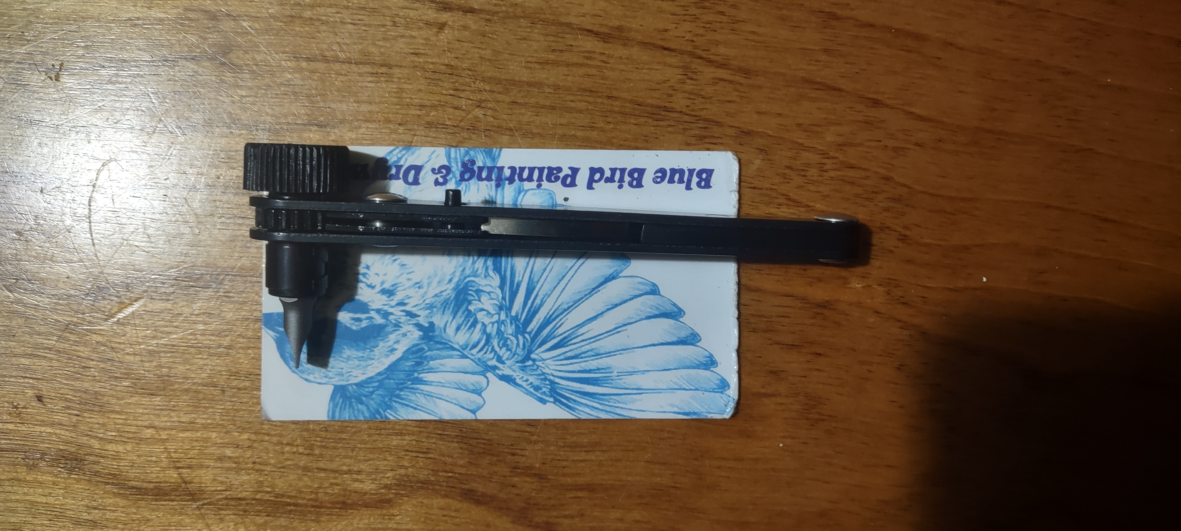

$2.99. I checked and it does fit into all four mixture screws on bottom of the bowls. May have to take chrome guard off alternator for #1 carb. But the ratchet clicks/gear is small enough that you can get atleast 2 to 3 clicks on all the screws. And if you want even more clearance it looks like you can grind the 1/4 inch socket drive off the back without effecting the operation of it. Harbor Freights screwdriver aisle, $2.99.
