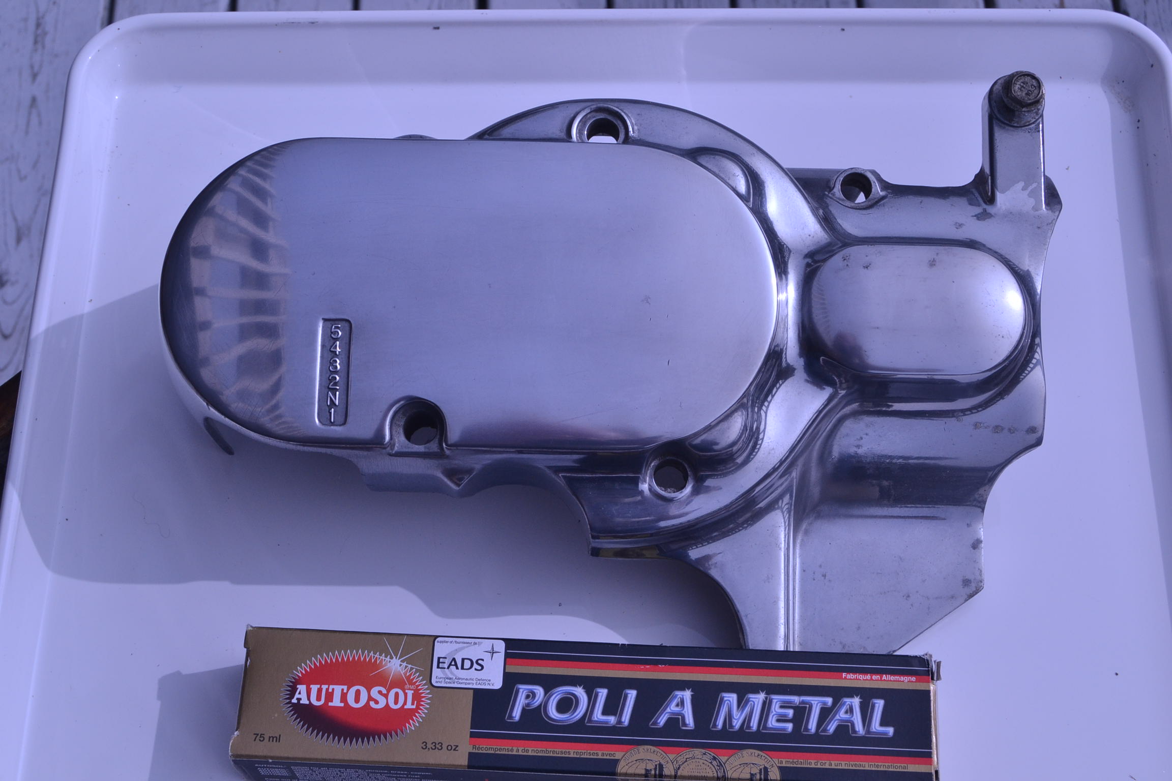

My clutch lever is limp. I took the cover off the MC. It looks like water.I will sop it out and refill and rebleed. I now have a manual. it shows the clutch bleeder valve somewhere on the block near the carbs it seems. there is the alternator cover, maybe it is hiding behind there. Please tell me where it is. Fortunately the neutral light came on so its not in gear. I have found this screw down low on a motor before, on other bikes, not up high how the picture shows.
Posts: 1030
Has liked: 119 times
Been liked: 290 times
Re: about to buy a 2000 model
It is behind this cover. Watch out for the 4 rubber mounting bolt dampers between this cover and the bevel gear housing it mounts on.
