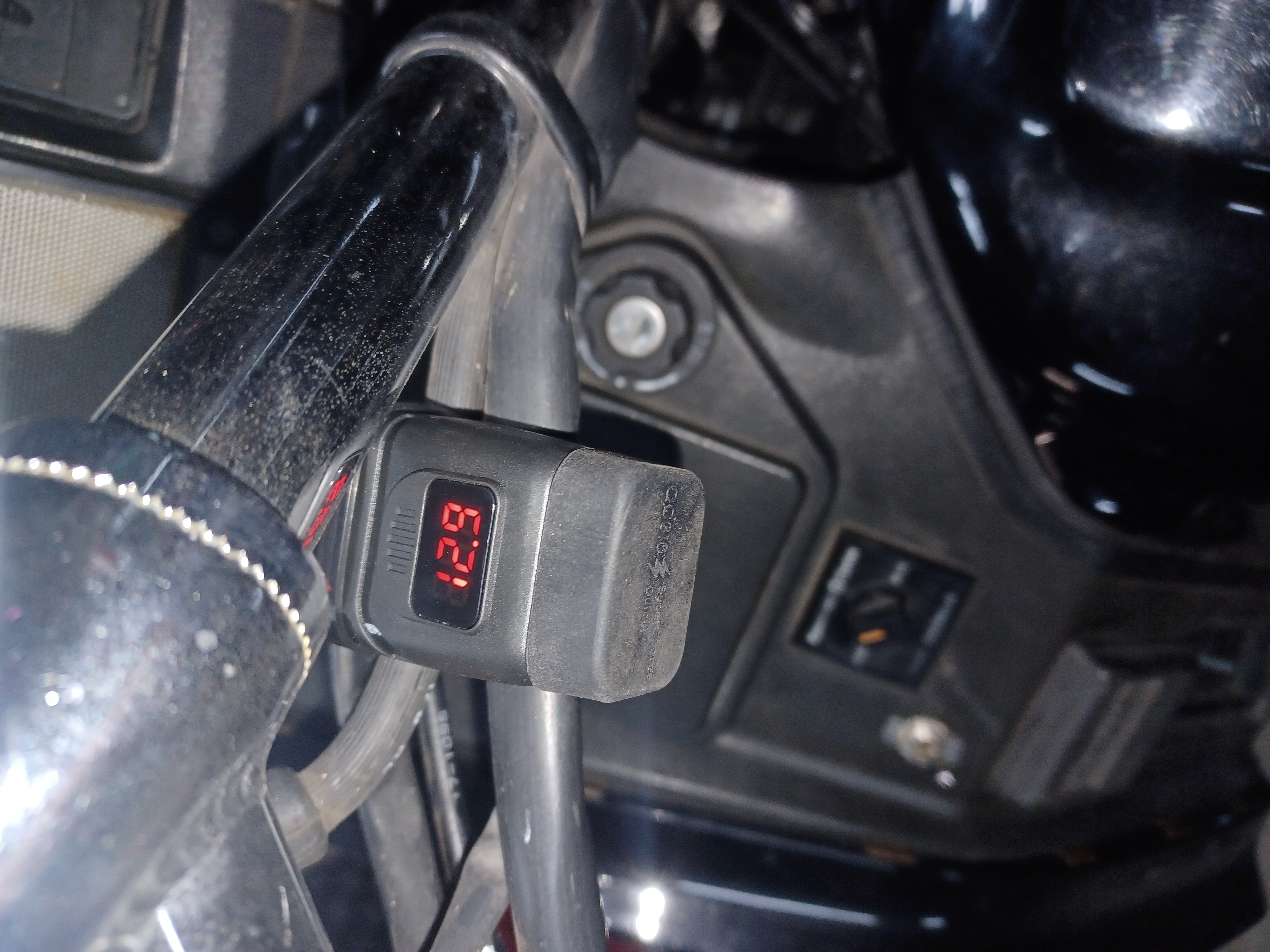

Plus i added one of these doodads so I'll have some warning next time :thmup:

A Voltmeter is a standard upgrade for me. Been left sitting before, due to a dead battery/charging system...
I replaced nearly all of my incandescent bulbs with equivalent LED's, several years ago. It freed up Amperes for charging my Battery. I highly recommend that to you. The OEM Alternator does not have a lot of spare Amperes for running accessories.
LED bulb replacements change monthly, as to what is available, and what their stat's are. You will need to research replacements yourself: make certain they are proper replacements, based on bulb type numbers. Also, make certain they put out higher Lumens than the incandescent versions! Make certain to use the proper color LED: yellow LED's behind yellow lenses, red LED's behind red lenses; if you use a white LED behind a colored lens, the lens will absorb all of the light/Lumens that are a different color from the lens, only passing those colors -- most of the Lumens will be lost...
The LED bulb replacements will last 20,000-50,000 hours, while the incandescent bulbs will last around 5,000-7,000 hours only. Installing an LED Headlight can save you 20-30 Watts of power, alone, that can be re-directed to your Battery, or to run other accessories. To be honest, I love the relief of knowing that the LED lights will likely outlive me! Cheers!

I have a voltmeter that has a color code rather than a number. Normally, I like more detail; but not in this case. All I know is that if it turns into a warm color (yellow or red), and especially if it flashes, it might be something I should pay attention to. But if it's green, I don't need it in my life. This little light is mounted behind the old Check Battery pup on the dash, which is red -- that is, I put this monitor where that white bulb used to be. The upshot is that it's hard to see when everything is fine (I drilled little holes in the red lens if I really want to check it), but raises it's ugly head only when I really want to know -- I totally forget about it most of the time. Besides not adding crap to my already silly-complicated cockpit, it also reuses that check-battery idiot light so I don't have to feel that I'm toting unnecessary weight. A win all the way around.
Warning: a total on-sequitur about weight follows.
I've been thinking of lithium batteries, primarily for dirt touring (BDR &etc) on light-weight bikes where the weight savings is more relevant than it would be with our piggly Voyagers. For those applications, I'm planning to go back to ammeters because lithium batteries maintain voltage until just before they die altogether. Probably better to monitor when, how long, and how much they're discharging.
Now, back to your regularly-scheduled program.
