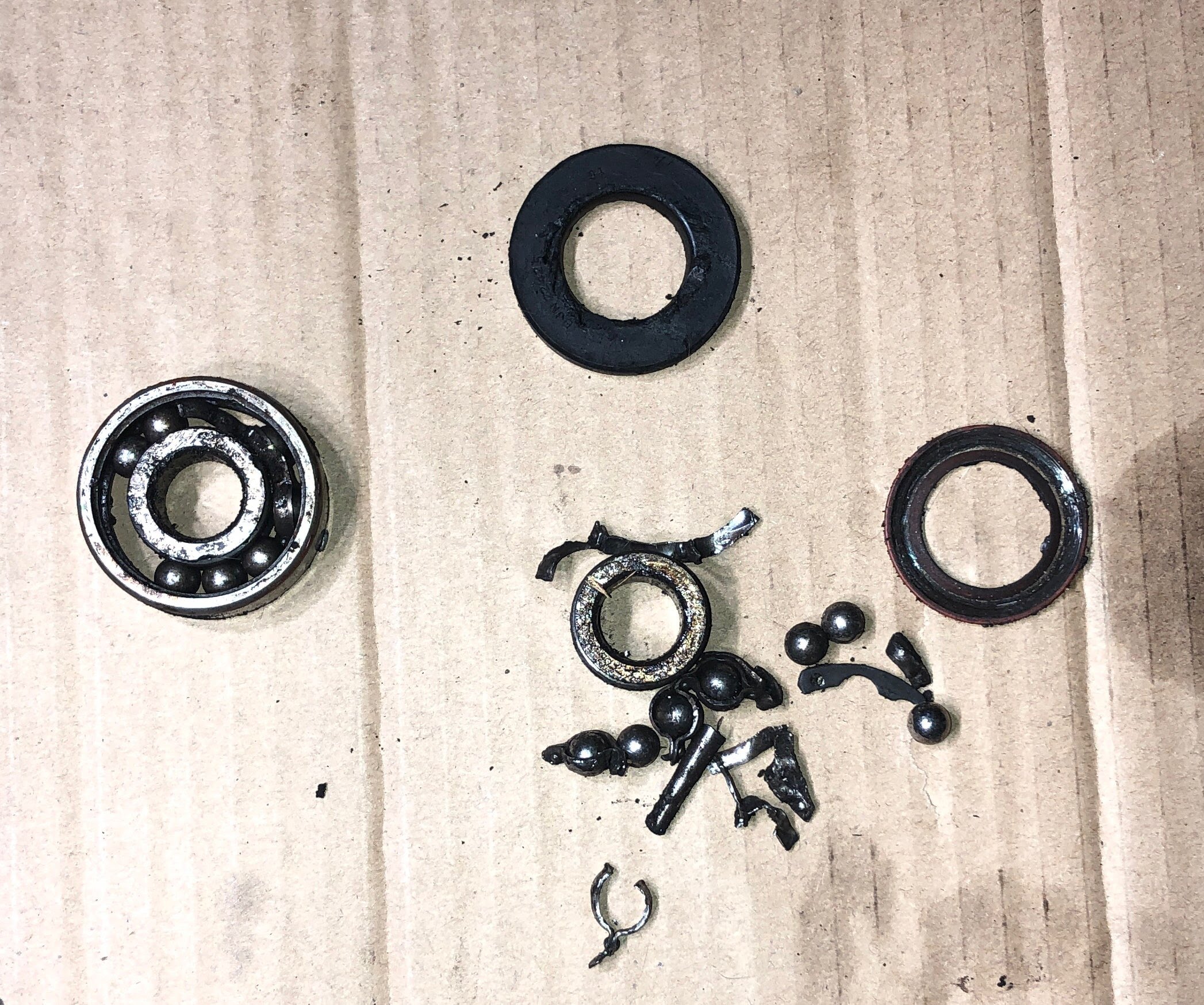

Re: front end wobble or shake when turning
I had that same low-speed wobble like when going into parking lots, etc. "Mechanic" said he checked the wheel bearings when he put the front tire on and they were fine. Yup, they were fine, all right. This is what they looked like less than 1000 miles later. Oh and the mechanic, oh, excuse me, Technician, works at a Kawi dealership, and the owner has been dealing with VXIIs since they first came out. So go figure.
I think,that those bearings were probably not OK GrandPa DennyGrandpaDenny wrote: ↑Wed Nov 20, 2024 4:44 pm I had that same low-speed wobble like when going into parking lots, etc. "Mechanic" said he checked the wheel bearings when he put the front tire on and they were fine. Yup, they were fine, all right. This is what they looked like less than 1000 miles later. Oh and the mechanic, oh, excuse me, Technician, works at a Kawi dealership, and the owner has been dealing with VXIIs since they first came out. So go figure.
Thanks, a picture is always worth a 1000 words... I've been trying to do work on my bike but it's been a hit and miss. My wife has been my main thing to do right now. She isn't doing very well.GrandpaDenny wrote: ↑Wed Nov 20, 2024 4:44 pm I had that same low-speed wobble like when going into parking lots, etc. "Mechanic" said he checked the wheel bearings when he put the front tire on and they were fine. Yup, they were fine, all right. This is what they looked like less than 1000 miles later. Oh and the mechanic, oh, excuse me, Technician, works at a Kawi dealership, and the owner has been dealing with VXIIs since they first came out. So go figure.
Oh i did order a pair of the 412 Progressive shocks. Just haven't been able to install them.
Once my wife is stable i'm going to install them and then remove the front wheel. Kaw did put 2 new tires, 404's on bike by the PO just before i bought it. Think they checked the bearings??? i wouldn't bet on it.
