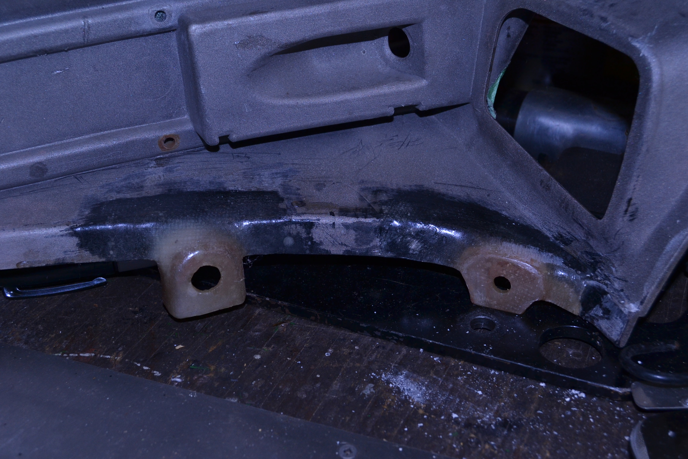

I grind both sides of a remaining flange, let's say, to leave a center leaf of the original. then I drill transfer holes through this leaf to ensure both sides of the repair are connected when the epoxy is viscous. I do not use polyester resin, only epoxy due to the inherent strength of epoxy. This epoxy is also saturating fiberglass cloth laid in several thicknesses on both sides of the leaf/remaining original area and is connecting with the other side through the transfer holes.
Then when this application of resin and cloth has almost set and is no longer viscous another layer of epoxy resin and multiple layers of cloth are repeated to the repair area. Some repairs will need a 3rd application when the 2nd is almost set.
The key here is not to let the previous application of resin and cloth completely set/harden: as then one has a COLD joint and that becomes separate layers and could separate later with time and vibration. Also the cloth must seem to disappear into the resin which is how it appears when it is saturated with the epoxy resin; only the grain of the cloth should seem to be there not the white silver colour of the cloth.
The repair area is feathered into the surrounding undamaged area of the item being repaired. Once all the epoxy has hardened for at least 48 hours I set about to shape and machine the repair. I have attached a JPEG of some repairs I have done to the most common upper cowling broken mounts. The photo shows how I have blended the repairs in to match the original and one can discern the cloth embedded in the resin. I have done quite a few of these and none have failed a second time, well so far at least and some are 8-9 years old now.

Thanks for the great detailed instructions Dave, the pic is even extra helpful.
