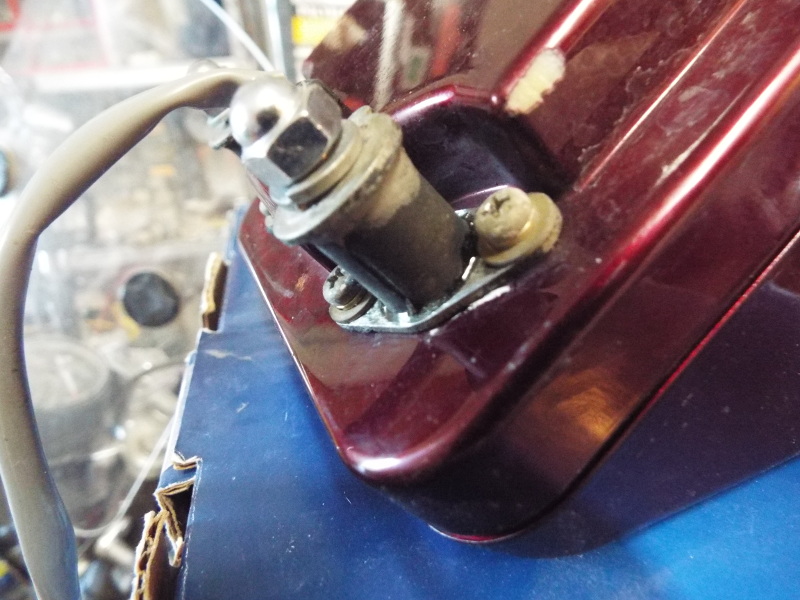

Rear Speaker Mount Repair Part 2
Post by Mr Jensee »
Once the bolts were in place they were snug and would not rotate. I then installed the mounting plates and bolted the top and bottom of the speaker back together.
I then screwed on the three well nuts, They have a threaded metal insert in them that matches the carriage bolts.
It was then a simple matter to bolt the speaker down using the new stainless steel acorn nuts. I used the original lock nuts to keep them from backing out. There was also no need to drill out anything on the rack since the carriage bolts were only slightly larger in diameter than the original threaded pieces. I remounted the speaker rack and was done. This took me about 1-1/2 hours to do with the trial and error method of mounting the carriage bolts.
I have no doubts that before too long the left speaker will require doing as well. I want to use this for a while, make sure there is no detrimental effects before I do the other side. If there is I have another plan in the works using silicone! :hmm:
Update! It is now 2014 and there are still no issues with the mounts. I have since done the same thing to the left side. Thanks for viewing!

So I planned to complete Mr. Jensee's mod today and had prepped all the carriage bolts as described (the well nut is 5/8ths)...however I ran into a problem because I left my racket set in my truck too far away to get too and therefore couldn't take the luggage rack off...so I had to improvise. I developed another way of accomplishing the same mod, but perhaps with a little less style :Cball
I didn't take the speaker apart, just unscrewed the rubber mounts and used a 3/8ths bit to put a hole in the metal mounts that the square parts of the carriage bolts would fit through. Then I put two well nuts on the bolt, back to back, and attached them to the speaker. This meant that I didn't have to drill through the plastic parts of the speaker. Then I assembled the speakers on the luggage rack. The downside is the difference in height between the stock and modified speakers. They sit 5/8in higher than stock due to the additional well nut. I'm hoping that the use of 2 well nuts will provide maximum vibration dampening. I'm planning on putting the second well nut under the luggage rack (so there will be one on each side of the luggage rack)when I get back to my tools so that the setup is back to stock height...if so I'll try to remember to update the forum. Bottom-line, this is a great mod and cost $10 for all 6 mounts and 2 beers :woohoo:
